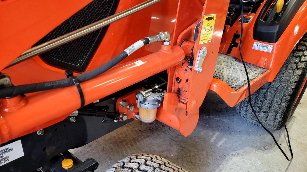

Just bought and installed the Botaproducts filter kit. Excellent execution and quality. Gave me the gumption to take care of this problem. The Kubota filter they supply is for the L series tractor which has a positive on/off valve and is made of metal. The bowl is translucent so you can see if there are contaminants or water. The filter mount will outlive anything I can throw at it!

How about a picture?
/ BX filter relocation
Trying to upload a pic

Is it pretty stout? I could see it getting hit, there.
/ BX filter relocation #10
I've had mine for over three years. Best mod I ever made to the tractor. Very stout, haven't hit it with anything....yet. It's a relief knowing I don't have to change the OEM filter any more, and this one is much bigger and of course highly visible.

That is a real sorry place to mount it.
Not really. Very similar to other tractors. Guess it’s like anything... gotta pay attention. On the BX, it’s not much worse than the stupid HST fan. Be careful.
Smokeydog just posted a picture of his grill guard on this forum, and I noticed his filters on his L-Series aren’t located much better from the factory. The B’s aren’t much better.
/ BX filter relocation #13
I'd be grateful for a better suggestion. I looked the tractor over pretty carefully and found this to be the best compromise between accessibility and protection. Mine (Racor) has been in place for more than a few years with no problem, and it's easy to check and replace the bowl/filter
/ BX filter relocation #14
I would have to disagree. I've had mine for three years and haven't paid it any attention at all when using the tractor and have had no problems. Not only that, the location makes it easy to do a quick visual on the filter. Don't forget that these are small tractors and that really limits the location possibilities.
