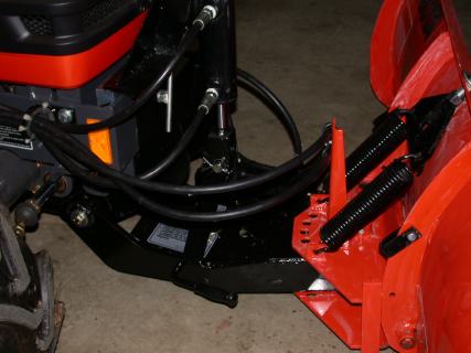

Maybe this'll get out. Please help. Looking for the manual on how to install and remove the front subframe(BX2711) on our BX 1500. The dang thing will be in the way of the mower deck come spring, when the snowblowing fun ends.
Any help please respond e-mail, or here. THANKS! natanddiane@cecomet.net
/ BX front blade question #25
There are two large T handle clamps on the front of the frame at that top of the hitch. Just loosen these to lift the hitch off. You might need a wrench to get them loose, but is is very easy to do. If your tractor has a drive shaft attachment to the front hitch, you remove that the same way as you remove the mower deck drive shaft. Once you have the T handles loose, there are some pins at the bottom that will also need to be removed, but that part should be self evident how to do it. Just be careful because the hitch is heavy and can catch you off guard and do some serious damage if it falls on your foot. Just don't unscrew the T handles completely, just loosen them.

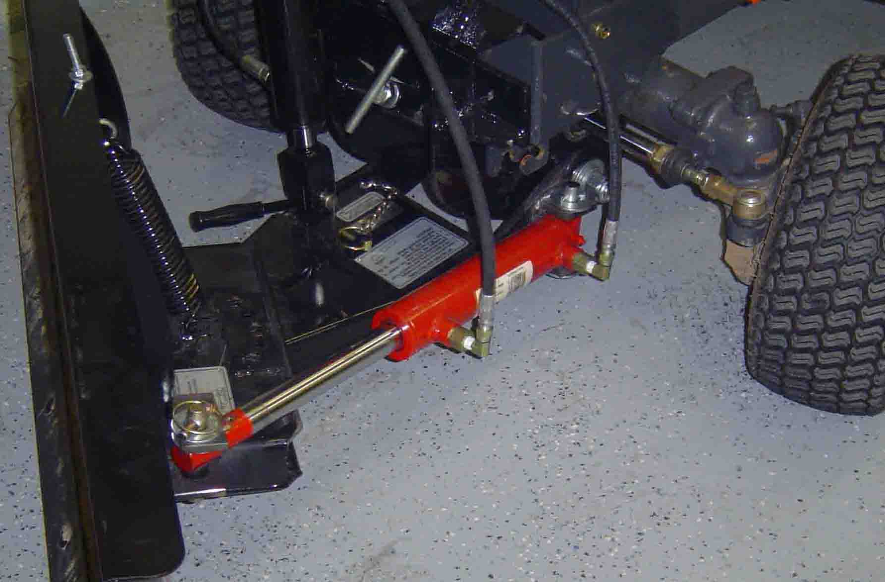

I know this is a little early to be asking questions about snow removal, but I'm just looking to plan ahead. I just purchased a used front blade for my bx2230. It did not come with any manuals. It is the manual angle/hyd lift.
My question is: how do you control the hydraulic cylinder on the blade when you remove the FEL (hyd valve stays with the FEL)?
I was thinking of purchasing a separate hydralic control valve and fabricating a mount that I could attach after removing the FEL. While I'm at it, I thought I might get a 2 spool valve and also add a hyd. cylinder as shown in the previuos threads.

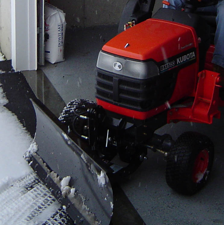

I just finished installing the front blade on my BX.
I will post what I have.
HarleyScooter
I'm in the process of setting up a BX1500 like this except it will have a rear tiller on the back instead of the back blade.
If I need to use a back blade i can put it on the other BX1500

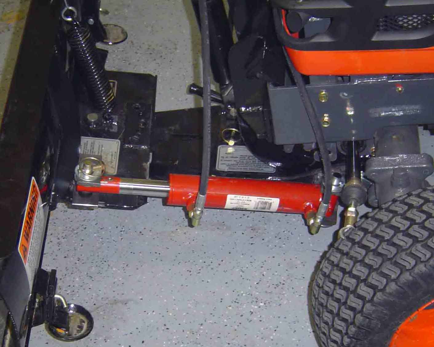

few yrs afterwards reading this post, I;m starting the mod, I;m not mounting the ram with the pin downward, rather I'm going 90 degrees so when the blade pivot point gets sloppy(which it will) the ram can pivot whereas if vertical, it cant pivot and will load up and wear.
/ BX front blade question #35
Lam, I'm not following. Do you have a photo of the set up? I got a BX2763A blade with my tractor and will be hooking it up for the first time shortly. Thanks,
