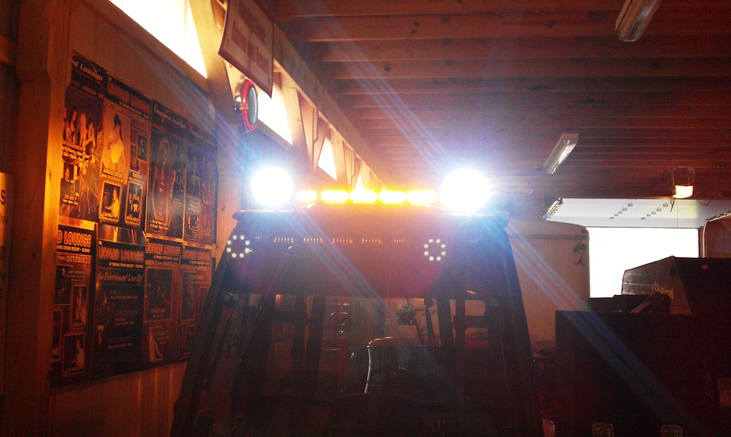

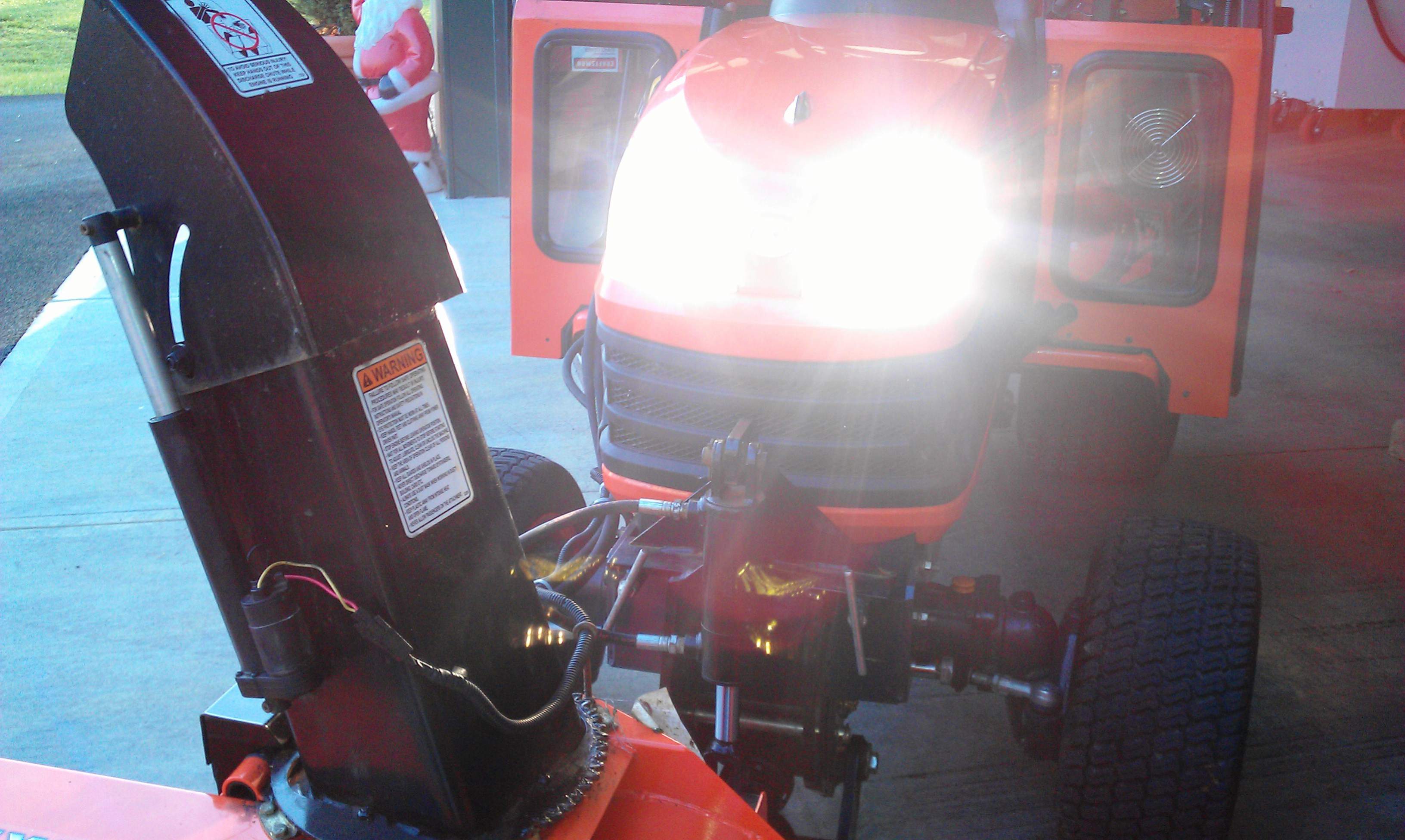

We have a BX2360 with a heated hard shell Curtis Cab. My wife does all the mowing, I do all the snow blowing. As we draw close to summer she often uses the headlights, and they are sufficient for her. Me on the other hand, not so much. In a snow storm with the 60" snow blower going the OEM headlights combined with the OEM Curtis Cab "work lights" are just barely enough to see what I am doing. I do have a SWEET "Whacker" LED Safety bar light that even the plow drivers give me the thumbs up over. Over this past summer I did a lot of research, and over this past week I made some changes. First thing I did change the OEM overhead work lights to the Whacker LED work lights. HUGE improvement. Then today I installed the "Blinding HID kit". First off the installation was a breeze. A little tricky getting the ballasts secure and out of the way, but with a little patience, done. The result... FANTASTIC ! I must say... I think.. I might have gone to far... this might be "overkill'. I am a 'glass half empty' type of person.. so I have two concerns. 1) I am going to monitor the heat the HID's give off in the OEM light lens. We don't want a melted plastic.. and 2) They just might be to bright and may be blinding to on coming traffic when I am blowing snow by the road. Time will tell... but first impressions... these upgradesIMAG0424.jpgIMAG0446.jpgIMAG0447.jpg are just what you need to do if you want to produce a slice of daylight in front of your BX2360!
