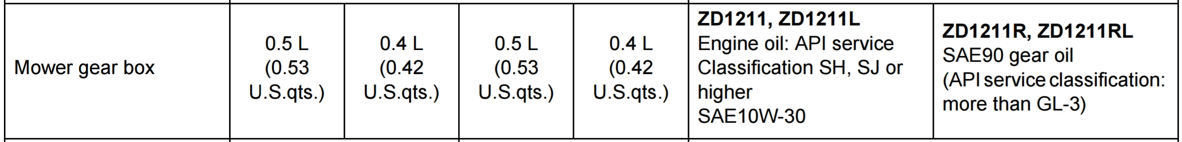

Interesting reading this 1464576049224.jpg my zd1211 gear box calls for 10w30 engine oil but the rear discharge calls for 90w. Some call for SUDT very interesting
