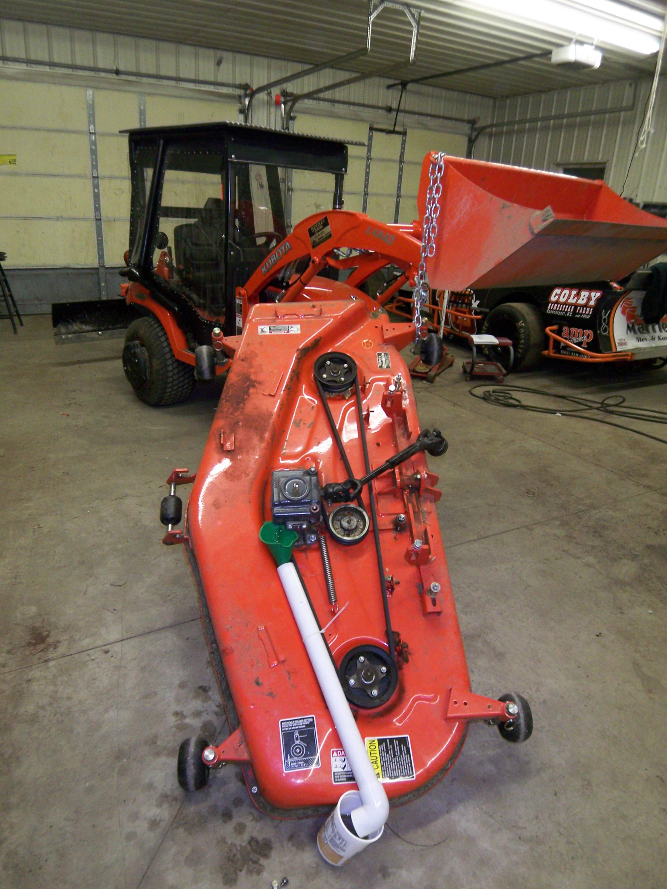

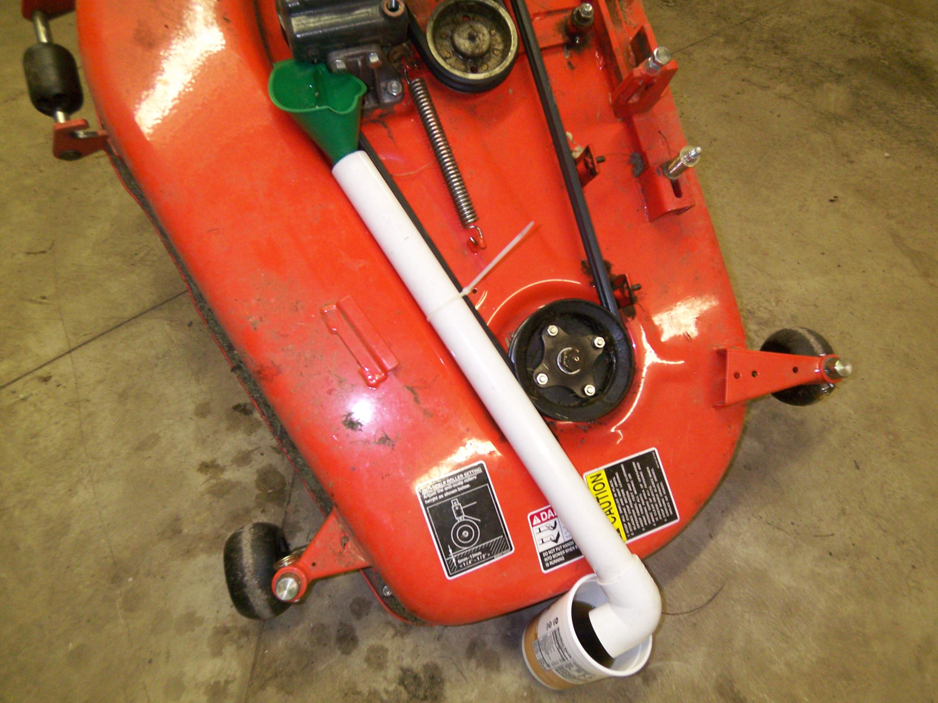

I just did my 50 hour maintenance, and most likely a lot more.
I used what I stated I would above, Amsoil synthetic
Engine oil and filter went good, hydraulic filter went good, 2 fuel filters (bottom was a PITA, but doable), the mower gear oil was very clean but I wanted my synthetic gear oil in and it does not take a lot at all, my deck is the 54" fine cut.
Now I also did the front axel, I drained both sides then filled, my manual states 5 Qts of oil, as I found out the hard way my front axel really only takes less than 3 Qts., yea I had to use a baster to suck out the extra (took some time, but it worked) I don't know if any of you did this and what your manual states but mine is wrong by 2 Qts. the old axel oil was dirty also glad I did it.
