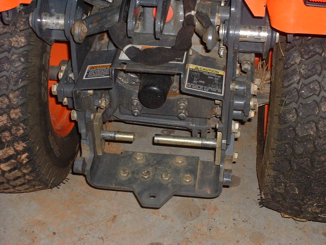

Here's a picture of the BX22 with lower links and plate removed.
   / BX telescoping stabilizer replacement #35
On mine, to install the lower links, you put the link end into the gap between the pins and slide it to the left or right. The center plate (with pin) then holds them in position. This process doesn't require tools. I'll bet the lower links and stock center plate are the same for both BX's, just the process is different. I don't think your modification would work on my tractor. /forums/images/graemlins/frown.gif
#36
Do one of the round stocks slide out? If so, you might be able to adapt the 2710 pieces, but probably wouldn't be able to remove everything as quickly when you want to use your hoe.
   / BX telescoping stabilizer replacement #37
Rossco,
The round pins are removable, but only if I disassemble stuff. In addition, I'm afraid one of the 2710 pieces would line up with the gap between the pins and not be very secure. I guess I'd be better off to stick with the stock center plate and use clevises or quick links to attach the new adjustors to it. This would still allow independent vertical adjustments, (the main reason for my questions - I have the 2710 adjustor parts ordered, expecting them any day!) Thanks for your input.
