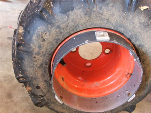

Ring in the new wheel.
   / BX Whatyacallit
#24

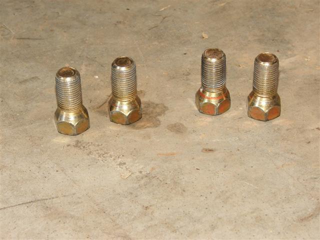

Ready to throw some mud. I did take it out and drive it around yesterday and I didn't notice any difference in the steering, I even took it to the creek and run it down the creekbed over a lot of bolders, I was surprised that there was no jerking in the steering. Setting still it is a little heavier steering unless the rpm's are up, but running down the rutted road to the creek even with one of the outter front wheels on a ridge, it didn't pull to one side. I'm pleased so far, just have to watch for signs of stress especially around the lug bolt holes on the outter wheels. The rear wheels are mounted with a spacer ring, but I used bolts in the holes for mounting weights to the wheels.

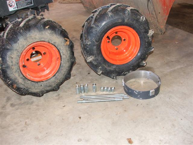

I orderd my set of wheels and tires to put duels on my BX2300... The only thing I'm doing different is that I'm useing the holes for the wheelweights to bolt the two together... I just don't like the tipping feeling...

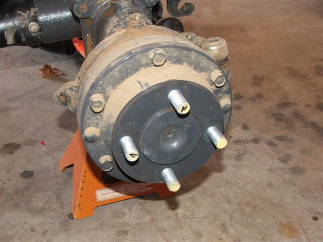

You know we're all waitin for pictures, and the holes for the wheel weights is how I fastened the rears together, but my fronts didn't have holes for weights so I had to change the front bolts to studs in the front hub, anxious to see the finished project.:D
