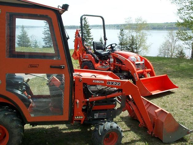

   / BX22/23/24 Owners...Regrets? #25
No Regrets, after 650Hrs...
I only wish the The BX24, had been around 3years ago, it has more power & will mow on hills, in high gear.
The size never stop me moving moutains, it's often better than a bigger tractor, since it will not sink/stuck on soft terrains.
Hope this helps, eitheir one in photo is a good choice.
Richard

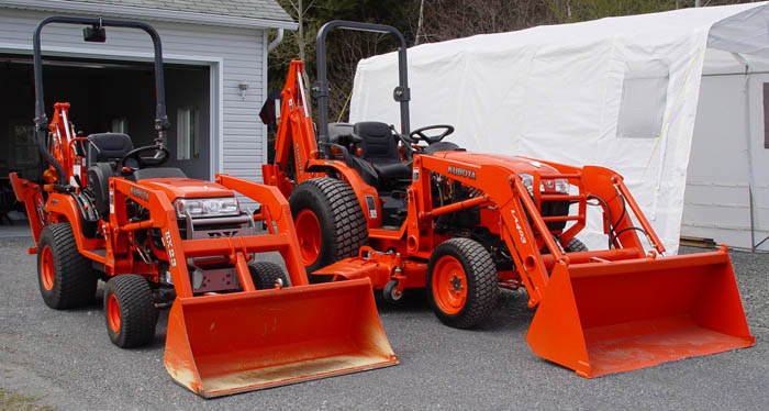

   / BX22/23/24 Owners...Regrets? #29
mmm... regrets? I don't think so. But yes I changed my former BX23 for a B3030 last year. I put 105hr on the BX23 and I changed because:
backhoe: I wanted something with more power, more reach, 180 degrees boom swing, no need to turn the seat every time, a larger angle of departure
FEL: more power (bucket cylinders above all), quick-attach, forks
ROPS: possibility to fold in two completely
electric system: better isolated light switches
PTO HP: enough power to run my 64" snowblower and a 60" tiller
remote hydraulic valves: (2) integrated in the fender
dash: a tachometer, tilt steering wheel (I must admit that I don't remember if I had one on my former BX23)
parking brakes: strong enough that I can't run with the breaks on
hydraulic flow: enough to use a logsplitter efficently (speed)
3P hitch: no turnbuckles (telescopic stabilizers: they keep the hitch opened), telescopic lower links ends; position control valve
maintenance: better access to the engine (no grill guard to remove)
transmission: a mid-gear
I'm happy that I had the chance to own a BX23 but I'm happier now with a B3030. I'm in my second year and I don't wish to have something bigger. I really think I'll have this tractor for a long time. I know that some features changed between a BX23 and a BX24. I gave you my point of view about my former BX23, keep that in mind (for exemple: a BX24 has a digital tachometer).
