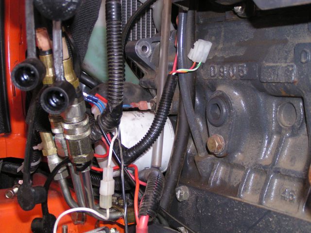

Well, bit the bullet and ordered the upgraded alternator. Right now my 2200 is hard pressed to keep the lights, heater and wiper going. Hopefully the new alternator will take care of that.
I haven't taken the old one off to see if I have a bushing in the block or if I'll have to drill it out. According to the chart, my moter was made in Feb of 2002. Looking at the current set up there there appears to be a sleeve between the washer and the block....hope so anyway as I don't really want to drill out the hole.....I'll find out as soon as the dealer gets the upgrade kit in......

I ran everything I had for a while yesterday after finishing the install and it dimmed some at idle but picked right up with a bit of throttle. I don't have a clamp on ammeter so I couldn't measure what it puts out but I ran my heater on full, 2 55 watt halogens, 4 way flashers, factory head lights, and windshield wiper so I would guess a load into the mid to high 20's.
</font><font color="blue" class="small">( Looking at the current set up there there appears to be a sleeve between the washer and the block....hope so anyway as I don't really want to drill out the hole.....I'll find out as soon as the dealer gets the upgrade kit in...... )</font>
I don't know what you mean by sleeve. I've attached a picture of the pivot bolt before removing the dymo. You won't know without removing this bolt and looking at casting whether you need to drill or not. The kit won't even mention it. If you have a spacer between the block and your current charging unit then you may already have the upgraded alternator? /forums/images/graemlins/confused.gif

Here's a picture of the flange without anything mounted.

I also ran into the issue of not having a bushing when I installed my kit last month. (BX22 - engine from march 2003). I used a Milwaukee 3/8" close quarter drill to get around the confined space. This, of course, after I spent a good half hour with a punch and hammer trying to find a hint of a bushing. After drilling, I still saw no hint of a bushing. I think there are at least two types of castings.

Thanks for the info. When I looked at the bolt assembly on the tractor there appeared to be a ridge between the casting and under the washer. As I said I haven't taken anything off yet as I am waiting for the kit to come in from the dealer. I am hoping that I won't have to drill it out but with my luck I will have to. I may be able to borrow a "stud" (angle) drill from a friend. That should mean I don't have to take off the starter....I hope!

We just installed the high output alternator on a new BX23 and ran into the same problem. We solved it by making a bushing 10mm by 8mm for the alternator and using a longer 8mm bolt thru the bushing. Hope this helps.
