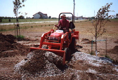

Since the BX has the same engine used in the B1700 I guess those wear out more quickly too and that an L sereis will last more hours than a 7500 and so on--nah--your dealer wanted a bigger profit margin or is continuing to be misinformed--either way he is wrong.
Ground clearence with the BX in most cases is a non issue--it has more effective clrearence than you think. The 7500 has a ground contact mower if that is a concern instead of the easily adjusted and superior suspended deck of the BX.

The 7500 is a fine tractor, and a larger frame than the BX, but it also comes with a higher center of gravity and a larger turning radius. As far as the 3pt, the lift arms are longer, and higher-placed due to the larger frame. This gives a bit more flexibility on certain 3pt attachments, such as post-hole augers and backhoes. I have the BX and haven't had any problems whatsoever with a standard Rotatiller (Howard HR3), box blade (Woods GB48) and 6' rear snowblade (yea, i know, larger than it should be, but works fine for what i use it for). Consider the 7500 if using the larger 3pts or if your'e going to be driving over downed trees, etc, but as far as normal stuff, the BX does fine.

The 7500 does have more 3 pt lift capacity than the BX but I have not found any problems with the "fitting" of Cat 1 implements to my BX. It is possible (I think I read it here on TBN) that the early production releases had different shaped lift arms. Anthing you would buy new would have the modified arms as well as other mods. (grease fitting on hydro pedal, new design fuel tank..)
I have an opinion for what I think is perceived to be a "problem" with the BX 3 pt. Here goes. Most buyers of the BX are first time tractor owners (with 3 pt anyway) and it does take a little getting used to attaching/detaching implements. The inexperience (me being one of them) of using the 3 pt, the weight of the attachments and, to some degree, the stiffness of new arms, ball sockets, etc. can make it very frustrating. Where you detach (level, hard ground) makes a world of difference when reattaching (true with the FEL too) implements. Loosening the "check chains" (actually more like turnbuckles) also makes it much easier to spread the arms to fit all Cat 1 implements I have. I have also replaced the cotter pins on the check chains with removable pins and most of the time I don't even need to adjust them after attaching other implements.
As an owner of a BX I know my opinion may seemed biased. I am only trying to give objective info from what I know to be true about the BX.
