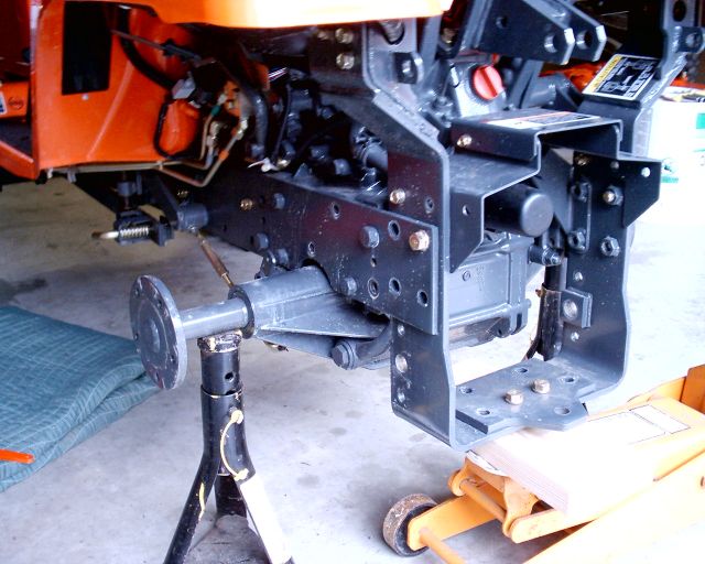

Next was to remove the MMM, Loader and 3-pt arms. Jack up the rear and place jack stands under the axles. Remove the rear wheels. Then various screws from the side of the frame. You'll need a good complement of 1/2" drive metric and standard sockets with a breaker bar ( those babies were tight! ) Remove the diff. lock bar from the peddle and replace it with a new solid bar (slide it in place but don't attach it yet because the new right sub-frame has to clear it )

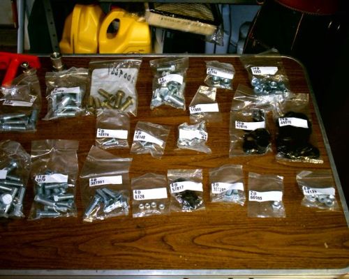

All of the different hardware came in numbered bags that helped take some of the confusion out of the day /forums/images/graemlins/smile.gif It looks like a drug bust.
