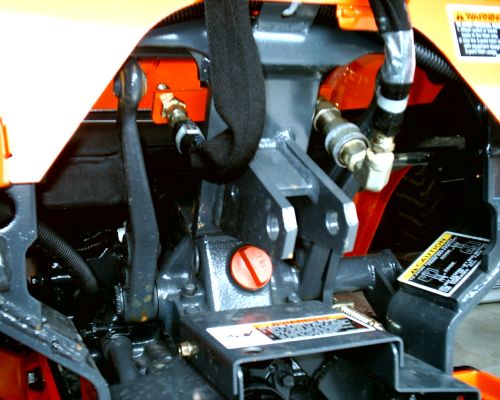

On to the hydraulics block under the right side rear fender to remove the small 2"x2" block on the tranny. Remove the top 45 connector and replace it with a new 90. Reinstall the block. Run the 2 new hoses up to the newly installed bulk head connectors under the seat.

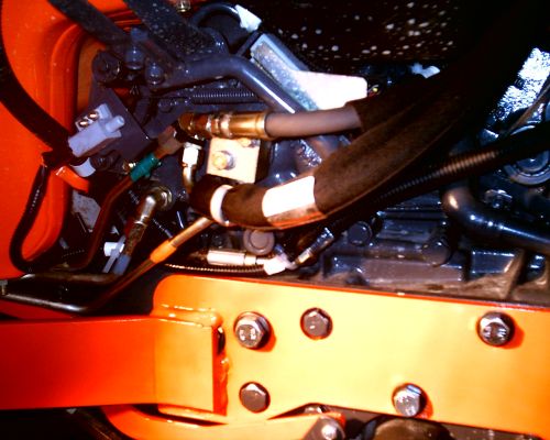

Make sure the hoses are as tight to the tranny as possible to clear the tire. Also make sure the PTO selector rod clears. Aim the hoses on the bulk head down to clear the seat. I think I'll be lowering the new bulk head so there is more clearance.

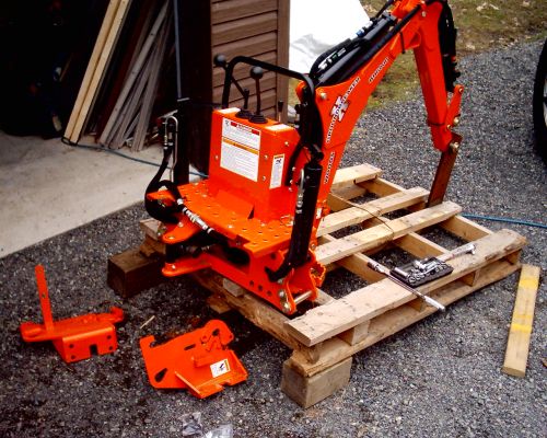

Next install the 2 back hoe brackets on the backhoe, the outriggers and bucket. Be careful when working on the back hoe on the pallet. I secured it from above with a hoist to stabilize it so it didn't tip over when installing the bucket.

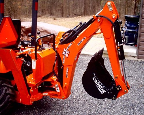

Hook up the lines and raise it up with the outriggers and bucket... then fully tighten the backhoe mounting brackets so every thing stays lined up.

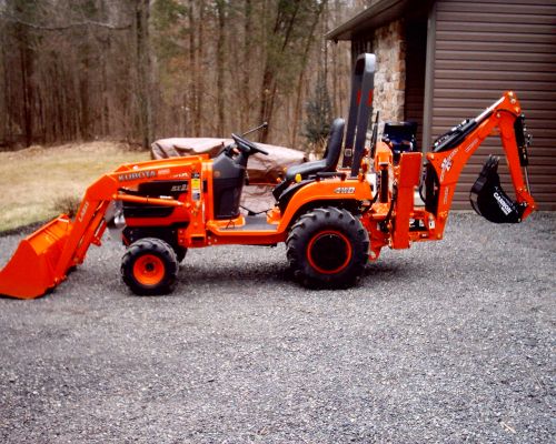

TA DA... there it is. Looks factory to me and no sideways slamming of the hoe because the hyraulics slow the swing down when it reaches full travel /forums/images/graemlins/laugh.gif
