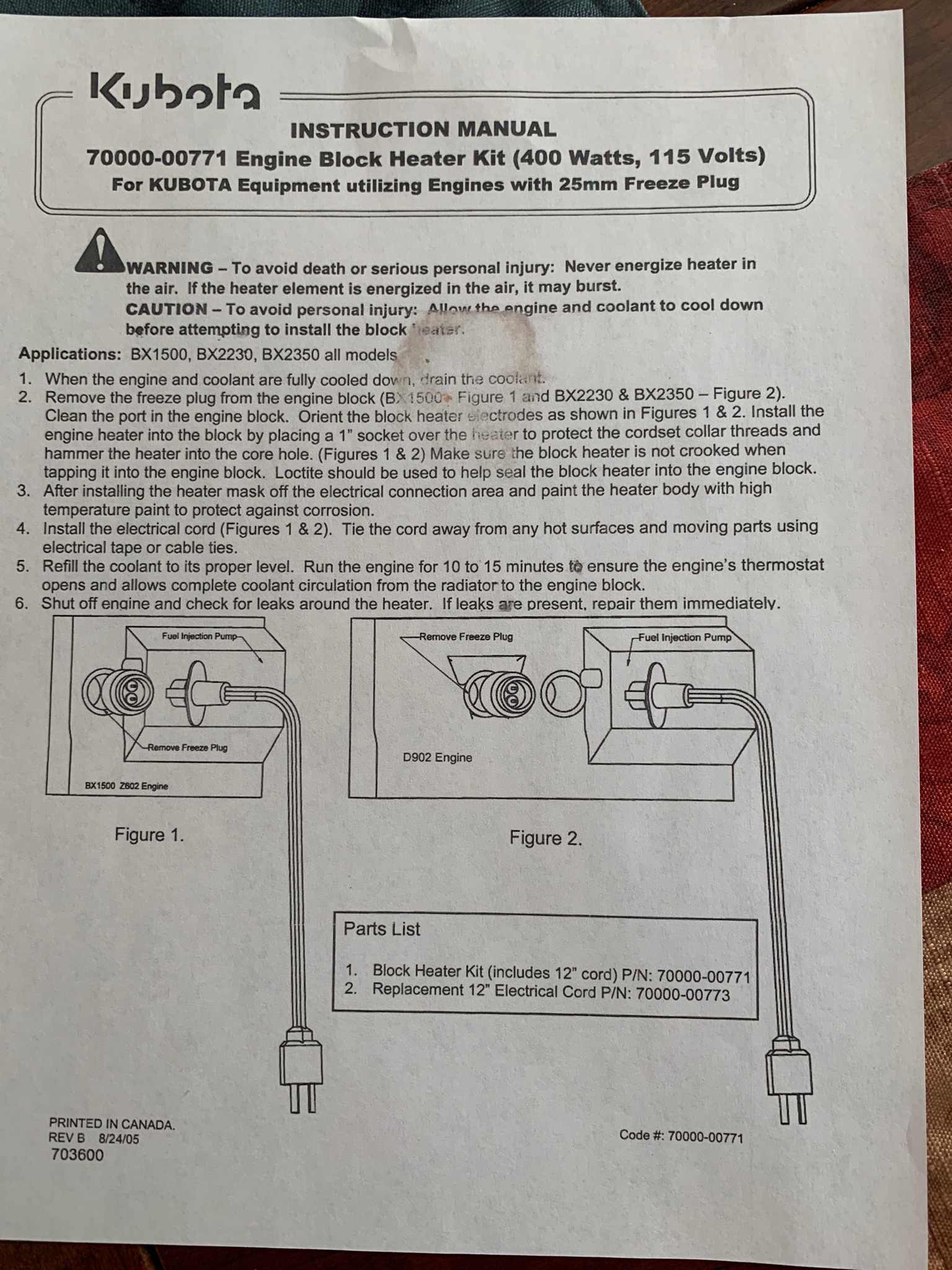

Hey guys I would like to install a block heater in my BX2230D for when I use the snow blower. The dealer says I have to use the inline one for the radiator but I cant see any reason that 70000-00776 will not work? My tractor has a D902-E-BX engine and the BX2350 has a D902-E2-BX-2. I cant really find any differences between the two as to why the block heater would not work?

Yea I read that. I think I’m going to stay away from the drill bit method and try and use the punch or a screwdriver and tap it out. Hopefully I can find out if that part number will work.

I seen that one to but I’m not sure where it would go on a d902 it looks like the element sticks out to far to go on the block. I did some digging and found install instructions for kit 70000-00771 and it specifically lists it to be compatible with a bx2230. On Messicks website 70000-00771 is no longer available and has been replaced with 70000-00776. So I’m like 99 percent sure that one will work now.

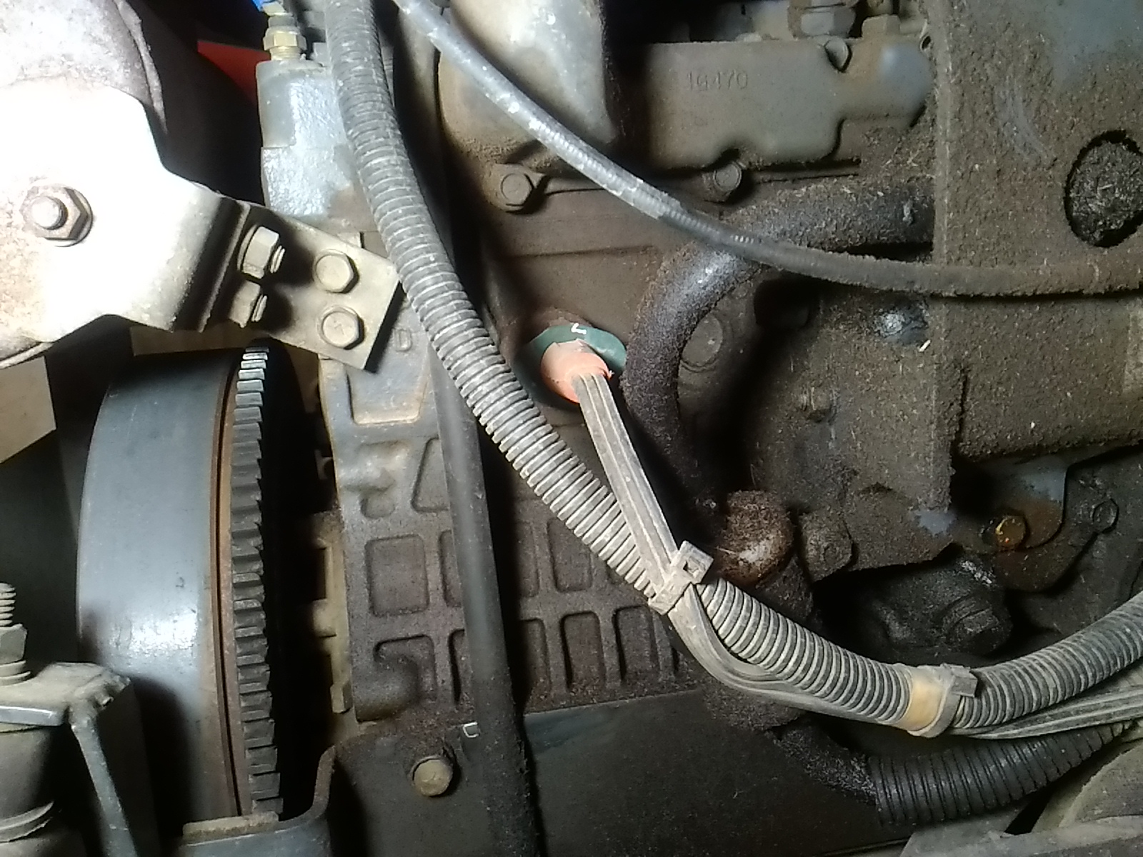

My BX2230 has a block heater when I purchased it used from a dealer. When cold weather came it was not working. So the dealer put in another one, not sure of the aprt number. But this was about 5 years ago. Dad's BX2230 also has a block heater and his works. Again a used tractor. Jon

Do you happen to have a picture of it installed?
Block heater is on left side of engine when seated on tractor.
let's see if picture posts. Jon
edit. 3 wire power cord strapped to plastic cover goes to red end of block heater.

Exactly what mine looks like. Dealer installed because I didn't want it to leak (not a lack of skill, but a lack of confidence IN my skill :laughing:). Been using it for about 5 years now, insulated garage, but not heated. At 20 degrees inside (-20 outside), it starts like it is 70 outside. A lot less knocking also.
