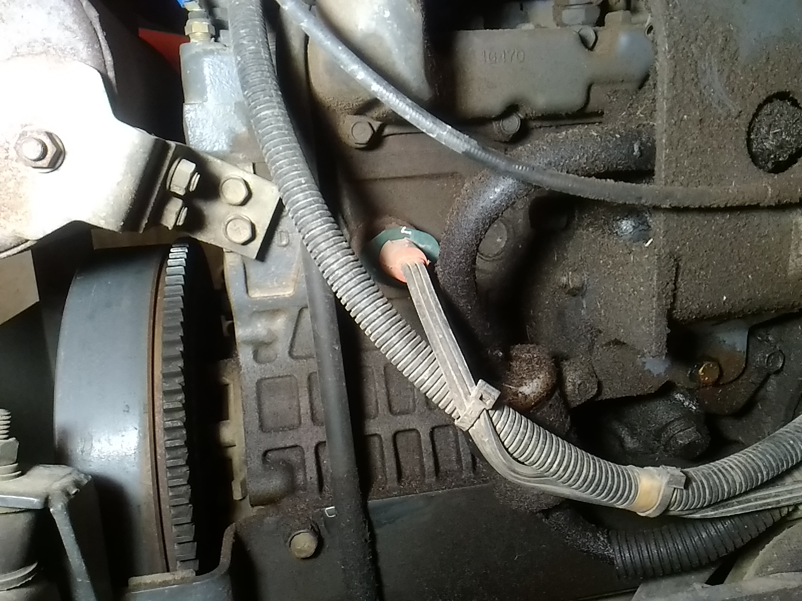

Do you happen to have a picture of it installed?
Block heater is on left side of engine when seated on tractor.
let's see if picture posts. Jon
edit. 3 wire power cord strapped to plastic cover goes to red end of block heater.

Exactly what mine looks like. Dealer installed because I didn't want it to leak (not a lack of skill, but a lack of confidence IN my skill :laughing:). Been using it for about 5 years now, insulated garage, but not heated. At 20 degrees inside (-20 outside), it starts like it is 70 outside. A lot less knocking also.
