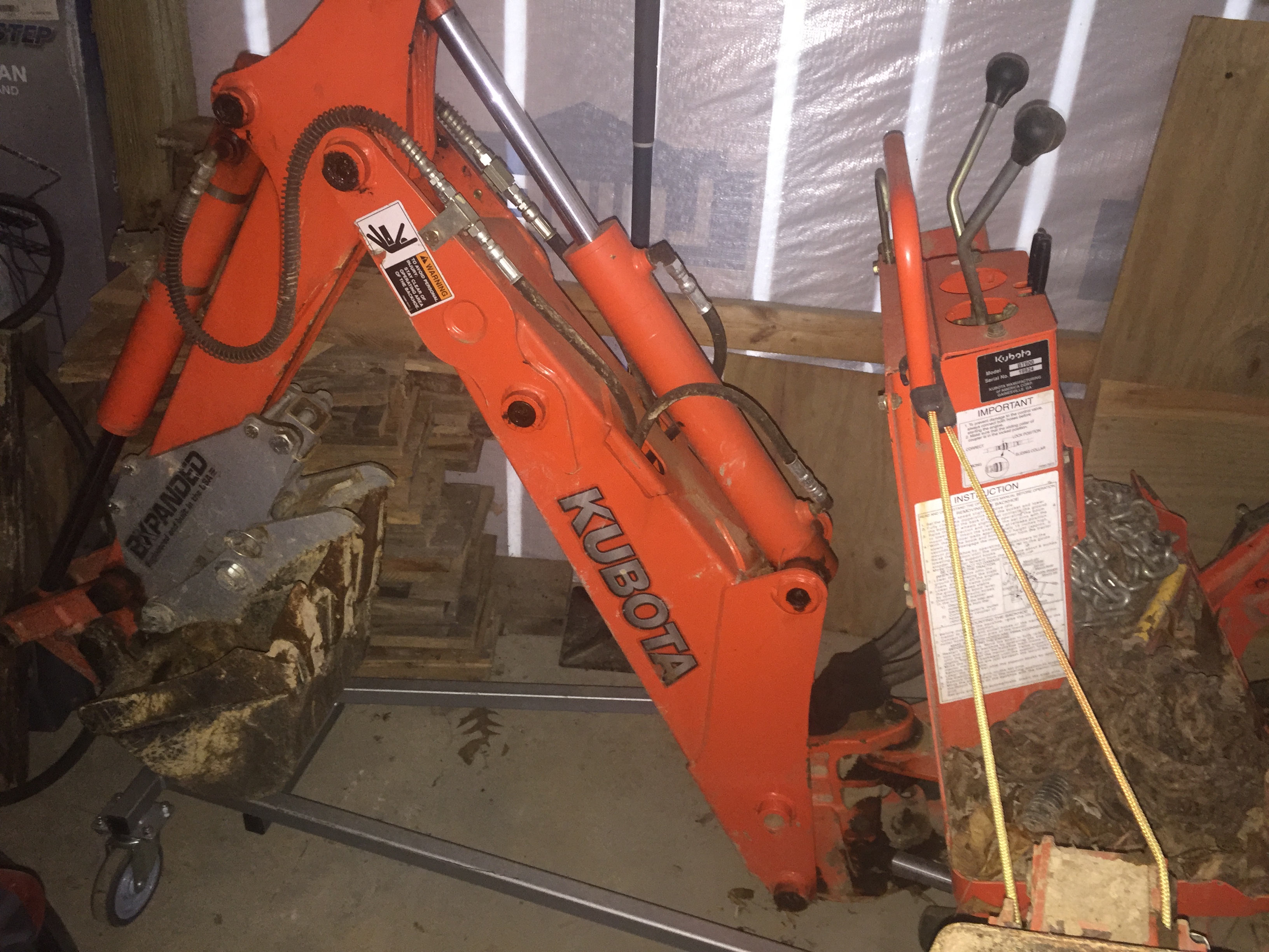

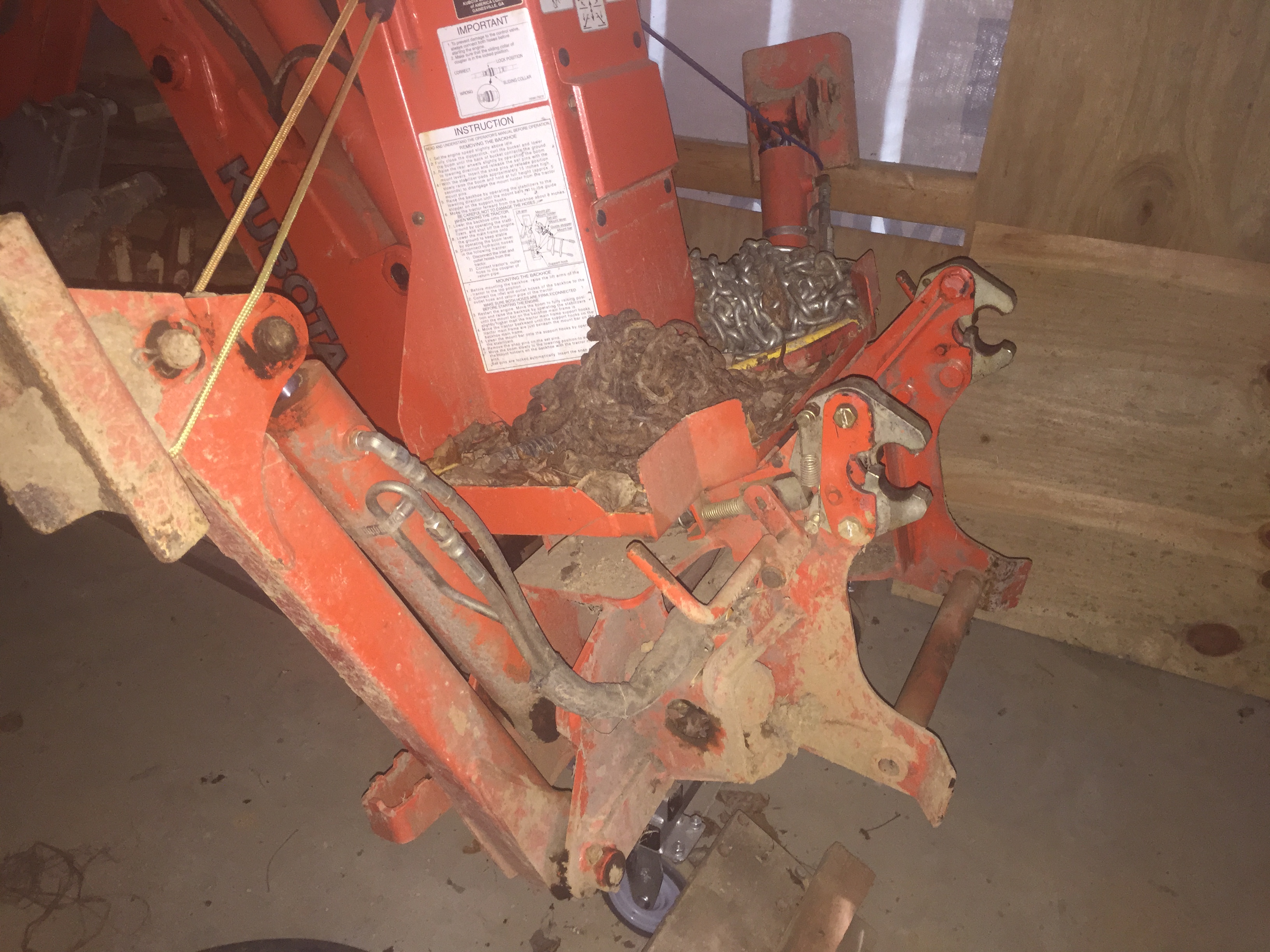

I went out and looked at mine last night and the backhoe is angled back. I tried to take some pictures, but I don't know how well they show the angle.
/ BX23 Backhoe Dolly #14
Just a test to see if this attachment will work.
/ BX23 Backhoe Dolly #15
Dear Srossman,
Thanks for the pictures. I am torn between just buying the dollies or making them. I have all the tools but am way behind on things. The big thing about making a custom one would be the pivot off to make it as quick and easy as the later model BXs. I hope to just make a jig to try different height pivots. If you get a chance could you measure the dimensions in the following pictures. Also, I wouldn't have to reinvent other parts of the wheel. Thanks.
