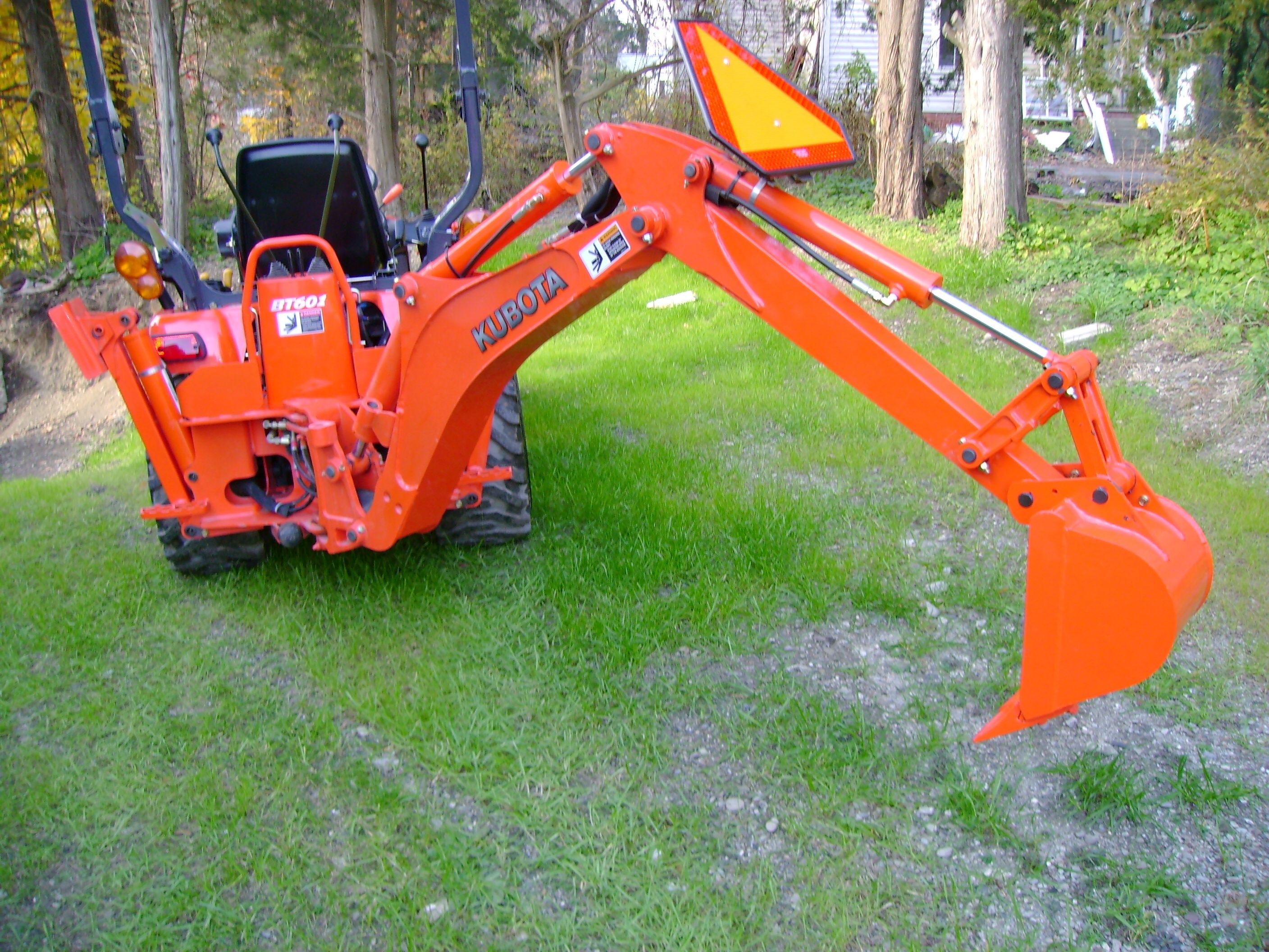

I'll qualify MHO on this by stateing my BX23 has given me over 200 hrs of trouble free operation. It's primary usage has been finish mowing 4 acres which it does extremely well but I've also pushed it's envelope in carrying many loads at or above it's listed FEL capacity, lifted and carried loads at or beyond the BH's listed capacities (used as an articulated boompole) and went down into a foot deep muck to dig out a pond and the BX23 has performed these tasks well. I can't count the times I've heard the BH squeal when digging out stumps and or when taking too big a bite when digging in hardpacked clay. That said, there have been many times where the extra power provided by the additional 1 gpm on the BX24's hydraulic pump, or the slightly extended reach of the BH's boom pole or perhaps even alittle more lifting power on the BX24's higher rated FEL would have come in handy
but not handy enough to where I would consider trading my now broke in BX23 for a new BX24.
The cosmetic problems w/the easy to break plastic floor pan and ill fitting battery/intake screen cover seems to have been corrected by Kubota so I wouldn't let that sway me from purchasing a brand new BX24 as long as these issues were already corrected but,,,, there is an issue, a very important issue that WOULD effect my decision to purchase the BX24 over the BX23 and that is the repair procedure on replacing a damaged HST cooling fan. On the BX23 it is a DIY type repair that can be done a an hr or so, but according to the one case I've read about re. this same procedure on the BX24, it is a major repair procedure that involves unbolting the engine and perhaps even having to lift it out of the chassis to enable the removal of the driveshaft to R&R the fan. If I recall correctly in the one case I've seen of this the dealer was going to charge an extremely large price to repair this as it is NOT a warranty item. Of course I've slept since then and don't recall the fix but I would question the dealer on this prior to buying as these fans can be broken rather easily when working in area's where sticks can get up into the under belly. I was lucky the other day on my BX23 as I was going slow enough to hear the sound of the stick hitting the fan blades and backed off before any damage was done....
Of course an aftermarket skidplate could help to protect the fan and other vitals and is highly recommended for BOTH machines but thats an additional cost above the purchase price...... I'm currently deciding whether I want a permanent mount or quick attach mount skidplate as I will be clearing some long fence rows that are highly overgrown and I will be running over the debris.

I see the curved loader arms and the curved backhoe boom as just a cosmetic change. It doesn't make either work any better. If curved arms were actually a benefit, the large backhoes that are used by construction contractors would have them by now. I just don't see the curved arms as an improvement, unless you consider an aesthetic change an improvement. Dusty
Improved vis - yes minor - longer reach w/ the BH - yes minor - but an improvement.
I mean - come on - we all know the BX24 is a BX23 wrapped up differently...
To the point about the BX24 looking like a blimp - hey - some guys like that look some don't. Personally, I like it better than the BX23 "old school" tractor appearance. But that's me.
Volfandt's above post hits the nail on the head... I have heard 2 sides to the fan issue - one is it's a break the tractor in half to fix really pricey account - the other is it's not much different than the BX23...

Not pummeling here, your opinion is probably more valid than mine, BUT tractors aren't cars. Model year styling don't count for squat, and the depreciation is not nearly as immediate.
The curved loader arms don't do diddly. The curved BH boom does let it dig a bit deeper though. The real change on implements is internal hoses and the control valves. Hoses are better protected, but much harder to replace. The control valves are puny on the 24 compared to the 23!
They are both hard to work on (due to size), but the 24 driveshaft cannot be removed (to replace HST fan) without yanking the motor or transaxle. Big minus there.
The 24 has a higher-output hydraulic pump, a small plus there. Note that cylinder size and geometry determine stall forces, not gpm.
I am a klutz, but I would have already replaced a hood and a fender if mine were plastic. Metal got bent back into shape and repainted no problem.
