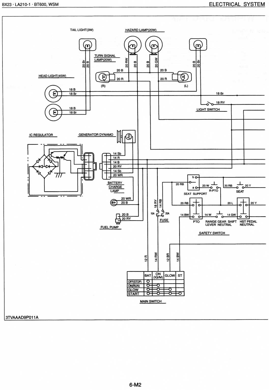

There appears to be a lot of conjecture and little work being done here...
I would recommend finding and bypassing the operator presence switches to test. I agree with others that when I am not sitting on my tractor I CAN inch the tractor forward by pressing ever so gently on the forward motion pedal, but press too much and the engine dies. That sounds to me like the problem you are describing except that you are sitting on the seat. So the culprit could very well be the switches in the seat, pull the connector off the switch and jumper it with a paper clip for testing... if that does not work you could still have a broken/cut/pinched wire between the seat switch and where it connects to the control unit. To test that remove it at the control unit and jumper it there for TESTING.... I would not run the unit without the operator presence controls... these ideas for diagnosis only.

Two new questions:
I pulled apart the 2nd switch. This is the switch with the small, black box with the white lever that moves. There are three wires. How do I bi-pass this to test if it's the switch?

Send me a pm with an email address and ill send you the prints for the switch and wiring

BX23 Electrical system schematic.

Both solutions could be the problem. The bolt in my seat came loose, and when it would lean to the left, it would shut the tractor off when trying to move.
As for the fuel filter, I had the same problem with gelling in the winter, idled just fine at full throttle, stepped on the pedal, died.
If it is a seat sensor, engage your PTO and see if it still dies. At least on my BX 24 it kills it when I engage the mower deck.
