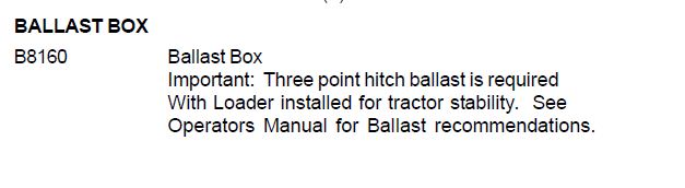

From the wholegoods list, BX2360 takes B8160 ballast box.

Sounds odd to me. On another thread, a fella with B7800 had this B5320 Box.
So, if you just bought your BX in spring, either someone messed up in delivery or the salesman was trying to pawn off an older box from a different model unto you. Gosh, I hope it isn't the latter.

I am sure the dealer will make it right but yes the first pic is the one I have which is very different from the one I should have in the second pic
