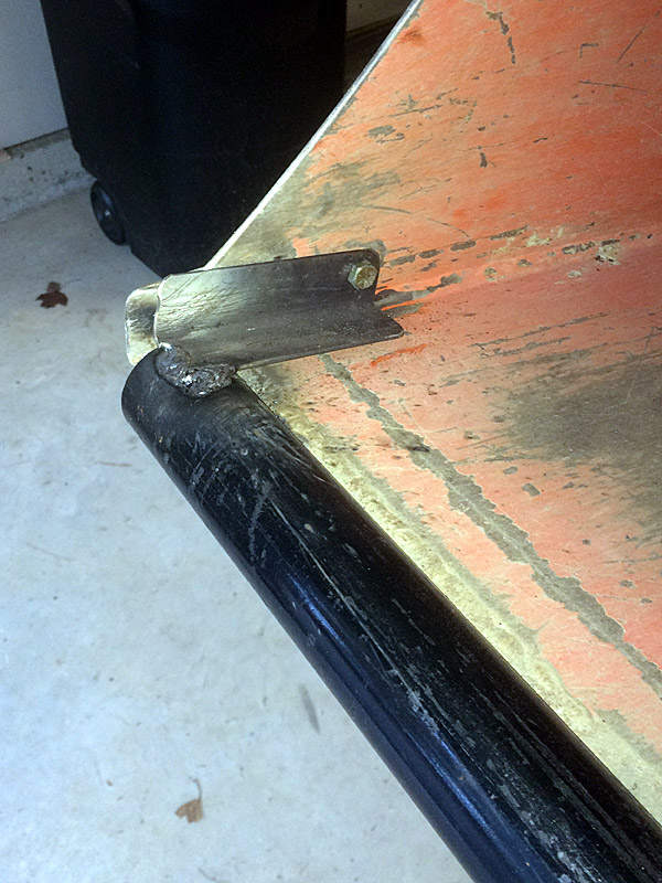

That pipe thing sounds interesting
This is what it looks like. The bolt is a 5/16 grade 8.

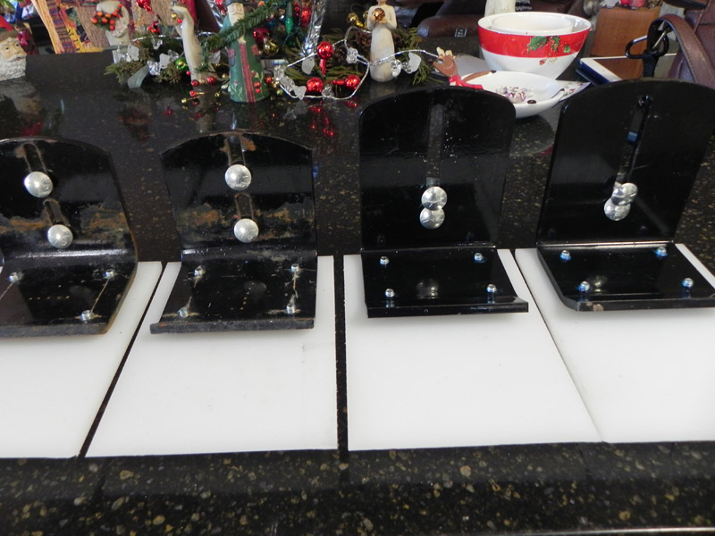

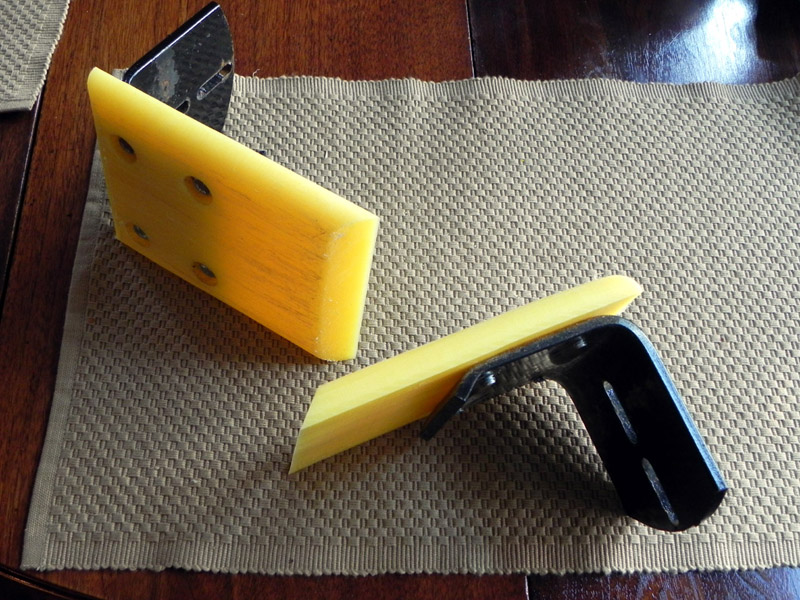

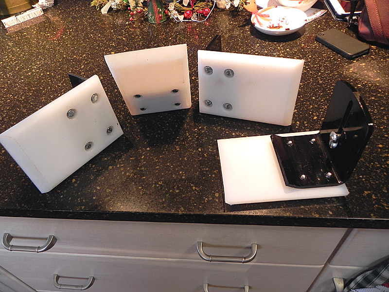

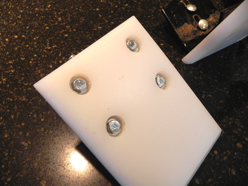

Thank's dsmiley. Think I will buy some and make me a couple. Any chance of a picture of your setup?
   / BX2360 front snowblower - how to keep it from digging in? #37
In the lineup the ones on the left are from an older BX; those on the right from a newer BX.

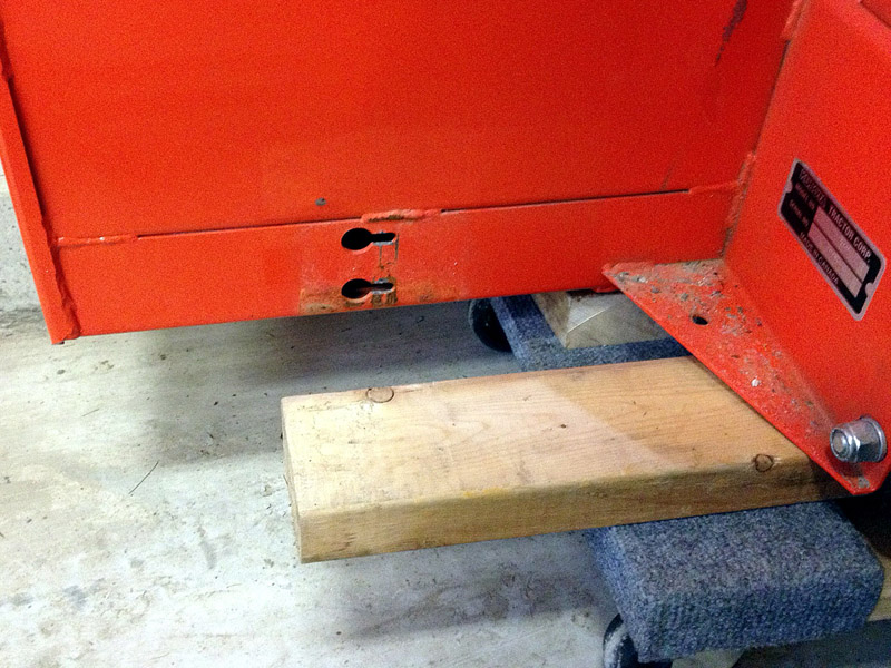

The mounting holes are slotted so all you need do is to loosen a bit to remove.

I put a piece of 1 1/4" pipe over the cutting edge on our 7' Loftness front mount blower, it helps a lot with reducing how much gravel gets scraped up.
Aaron Z
Do you end up pushing much snow with the pipe?
