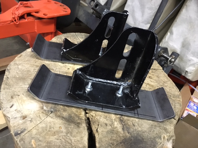

I had a similar problem with my rear mount Pronovost Puma on my BX22 so I modified the standard skid shoes...see pic
   / BX2360 front snowblower - how to keep it from digging in? #26
Awesome thanks!

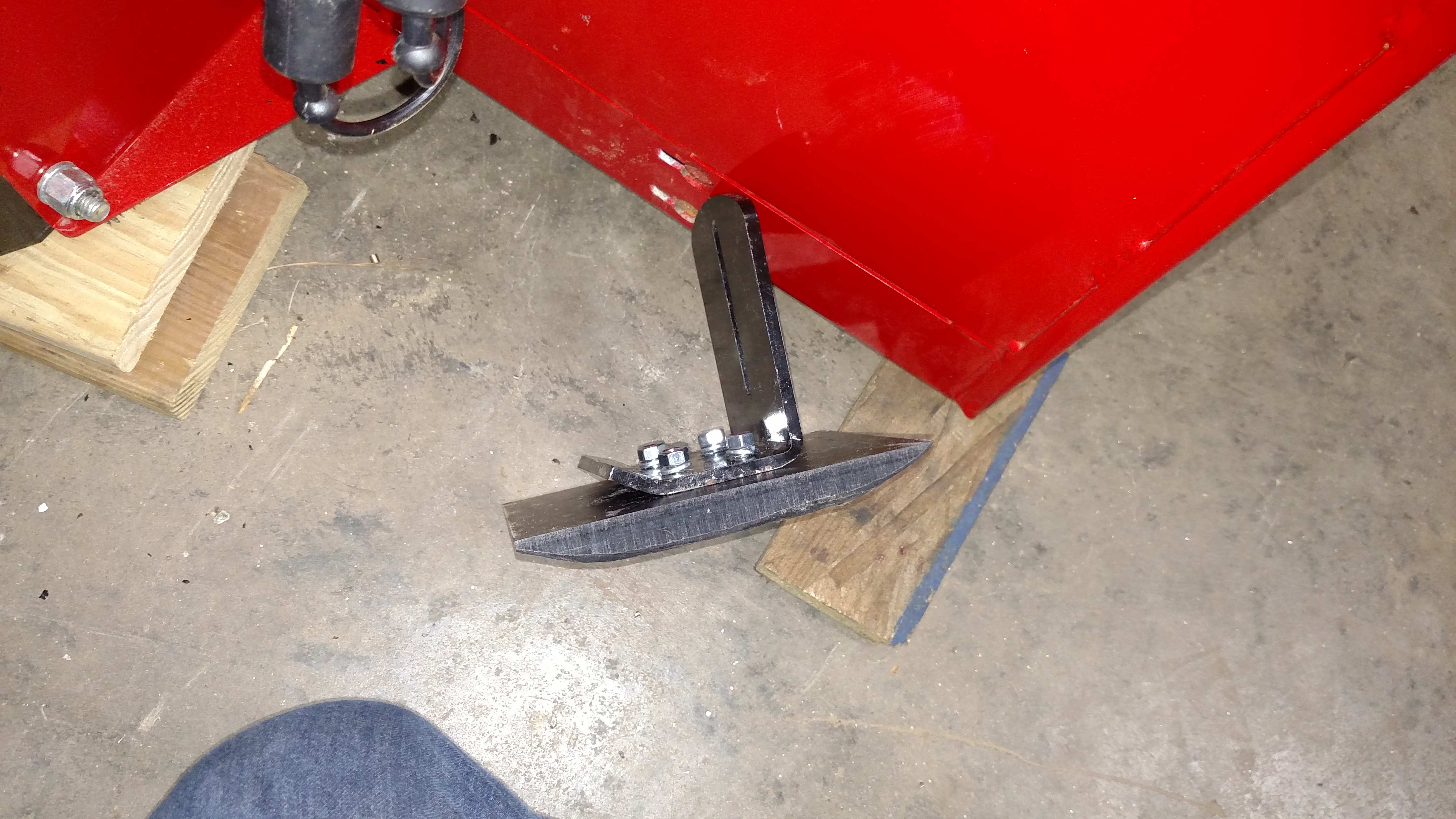

   / BX2360 front snowblower - how to keep it from digging in? #27
Bellweather
Nice work! I made mine out of UHMW because I had some left from another project. Were I to do it again I would go with steel as you did.
   / BX2360 front snowblower - how to keep it from digging in? #28
Bellweather
How long have you had the uhmw ones amd how are they wearing? I considered steel but I really wanted to shape them rounded on all edges so i could turn a bit with the blower down.
   / BX2360 front snowblower - how to keep it from digging in? #29
UHMW is incredible material. We used it for water bearings in hydro units weighing tons. I normally do a lot of snow blowing and the first set I made lasted 5 years. They would have lasted longer but I was making a set for a friend so I made a new set for me at the same time. I also wanted to shape the edges but in the end I don't think that was as important as I thought it was. Steel would never wear out soooo...
   / BX2360 front snowblower - how to keep it from digging in? #30
UHMW is incredible material. We used it for water bearings in hydro units weighing tons. I normally do a lot of snow blowing and the first set I made lasted 5 years. They would have lasted longer but I was making a set for a friend so I made a new set for me at the same time. I also wanted to shape the edges but in the end I don't think that was as important as I thought it was. Steel would never wear out soooo...[/QUOTEW
What thickness of the UHMW did you use?
