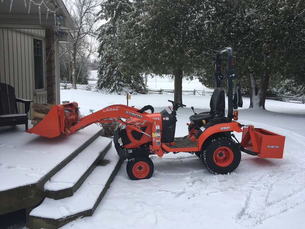

Hi guys,
Newbie tractor owner here.

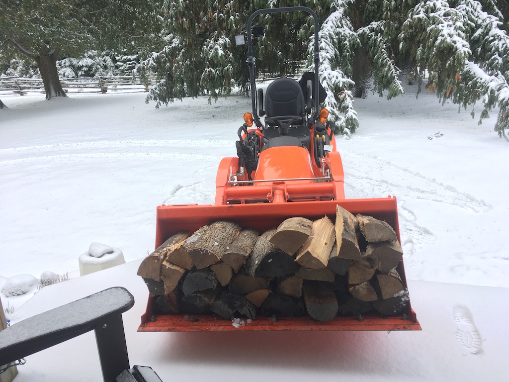

Bringing wood I noticed the tractor seemed to sway a bit. I'm super careful even on the mildest of slopes.
I keep the bucket almost dragging on the ground until I have to lift it and even then only on flat ground, etc.
I found that I could get off my BX and actually almost tip it by hand (by pushing on the roll bar)with the bucket as it was in the pictures
and when the bucket is empty and 6 inches from the ground (although that was harder)
Is this normal? I have sandbags for the ballast box (I didn't have them in the box today)
Would that help or make it tip easier because of extra weight?
Andrew

I've had some close calls with my BX. Best thing to do is keep the load as low to the ground as possible. This way if the tractor wants to flip, the bottom of the bucket will help stop it as it hits the ground.
If it feels like it's going to flip, just drop the bucket as fast as you can; make it like an extension of your hand - a reflexive move. It's saved me a lot of those times.
Make sure you wear your seatbelt too, as annoying as it is, it's there for a reason.
Though, the easiest way to prevent any of this is realize that it's a BX and not a big machine. Loading is key.

Andrew....load up that rear ballast box with some weight. Your front axle does nothing to keep you from tipping because it pivots at one point in the center. Your rear axle doesn't pivot so that is the one that keeps you stable but it needs weight to plant it to the ground. Are your rear tires fluid filled? If not, start with 300+ lbs in the box and work up from there.

My BX2360's LA243 loader manual recommends 420lbs maximum on the back when using the loader. I found it makes a big difference. With no implement on the back, and something in the loader, it feels like a gust of wind will blow it over. Even a 250lb implement really helps.
Certainly agree with filling your rear tires with ballast. I have rim guard (beet juice) in mine. Dealership I bought mine off of doesn’t sell a loader on a tractor without some type of ballast in the tires...
Adding ballast to your box, filling your rear tires with ballast and 2” spacers will make a very large difference in handling...
As far as “suspension”...these tractors don’t have a suspension system...the only “suspension” is the springs on your seat...

Doesn't matter if it's a BX or another tractor. If you have a front loader installed you should have fluid in your rear tires. If you are carrying a load in the bucket then you should have additional ballast on the 3-pt hitch.
The setup you have now with no tire ballast and no rear ballast is asking for all kinds of trouble.
