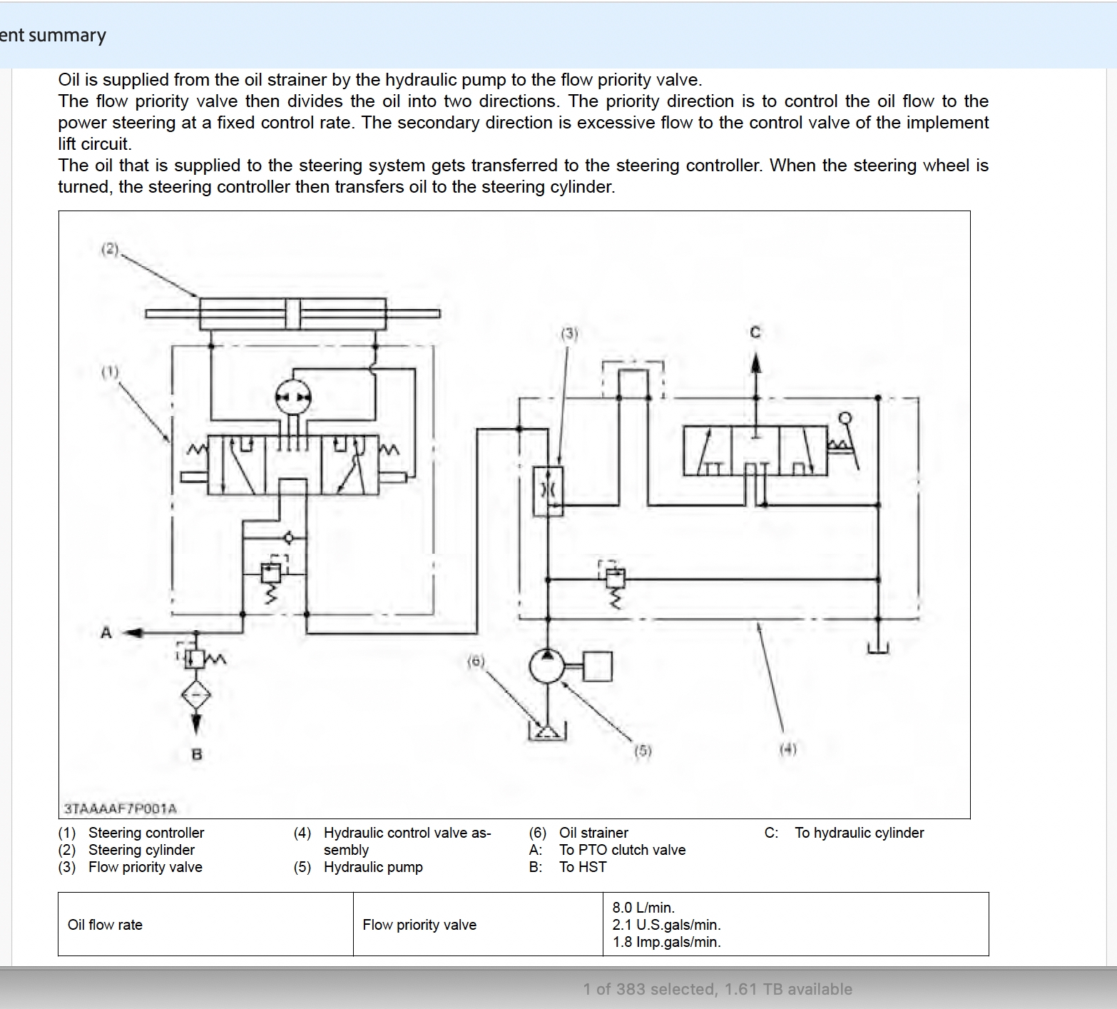

Did it happen once you started using the 3pt?
Or using the deck lift?
   / BX24 blowing hydraulic filters #12
doesn't adding shims increase the pressure?
Sure does and without a liquid filled pressure gage, that is playing with fire...
Pays to know what you are doing before you do it...
Reading along, I'm thinking the OP has the hoses incorrectly hooked up. I'll follow along to see the outcome...

Is there still on old gasket on the mounting surface by any chance? Were the filters tightened to spec?
I will double check but we checked all that. Not sure why it happened in first place as it had been in place for almost 10 months.

does this unit need to be plugged back into the 3 point for the return?, you didn't leave all the hoses disconnected did you?
It was plugged back in.

Is there a screen in the hydraulic system? I had a BX several years ago and can’t remember. Edit, it does look there is a screen. Did you clean it?
I will find out and check it.

I’m pretty sure they do have a suction screen, which can get pretty clogged. I don’t know if that coukd cause the filter to keep blowing off.

That's about what I am thinking. 5030. Tractors have a lot of built-in safeguards against too much hydraulic pressure. Hard to imagine everything failing and high pressure resulting.
Yes, the "adding shims to the relief valve" thing scares me too. I can't think how adding shims to a relief valve is going to lower the pressure. Usually it raises pressure.
A gauge test set is a good idea, everyone should have one. 5000 psi and liquid filled - Amazon has complete guage, hose, and adapters in a kit for less than $100.....sounds like the OP spent that much on hydraulic filters.
Suki, are you sure that the engine oil and the hydraulic filter didn't get exchanged? The hydraulic filter costs twice as much, it's heavier, and the shell is thicker. But they are about the same size and mounting.
I believe that model does have a cleanable screen under the hydraulic filter. But if it is clgged or missing it usually causes the opposite problem - too little pressure rather than too much. However, if it is missing or installed wrong it can cause a leak that might make you think the hydraulic filter "blew". You might want to describe how it blew. BigNoise? Or just lots of oil??
By far the most common hydraulic overpressures are caused by hoses. Either the quick connect ends are not seating well or the hoses are connected to the wrong ports. While waiting, I'd take them all off - one at a time - inspect them and make sure the connections are correct. Push on the quick change valves with something to make sure they are seating. And check for a mysterious oil leak or split down by the cooling fan underneath. That's a known trouble spot.
