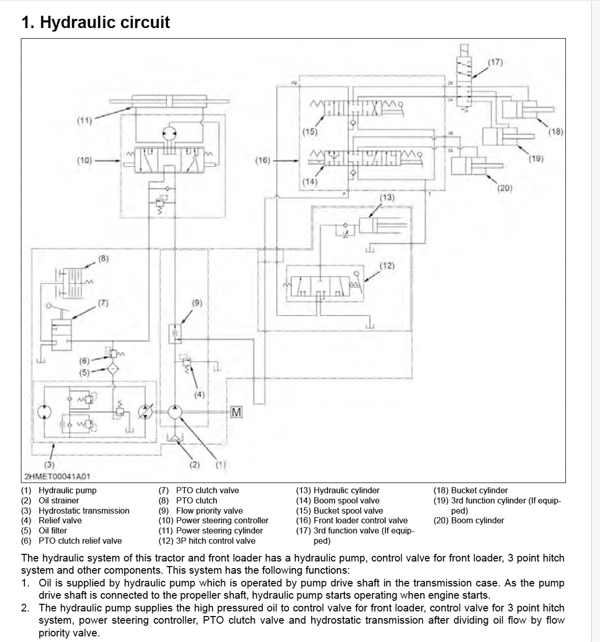

"Charge pressure" is just another way of defining a specific pressure at a point in a hydraulic system. More specifically, In tractors with HST, "charge pressure" has come to mean the operating pressure within the HST. Some HST tractors have a separate hydrostatic pump and special filter for the HST. The BX24 doesn't have that extra filter.
The Kubota Workshop manual will define a port on the HST to hook your pressure gauge. That is the "charge pressure" you want
You keep saying "blew the filter" .... I am still wondering what that means? Did it split open?

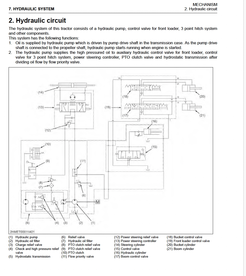

Here is a hydraulic diagram and WSM for the BX23S. My guess is your BX24 is very similar.
It wouldn't surprise me that the problem with the overpressure to the filter is due to a problem with the hydraulic PTO valve. That circuit also has its own relief valve that would be worth measuring.
The WSM was too large to attach. PM me & maybe it will come that way. Kubota BX23S Hydraulic Circuit.jpg
rScotty
   / BX24 blowing hydraulic filters #30
Per schematic attached by rscotty the filter is after the PTO relief and before the HST charge relief. If this is correct the charge relief would be the only relief that would affect the filter or an obstruction between the filter and charge relief.
Other potential concern would be if the priority flow valve is somehow allowing more flow to steering- charge circuit which may increase charge pressure. I recall some posts in the past about priority valves failing but do not recall what the failure mode was.
