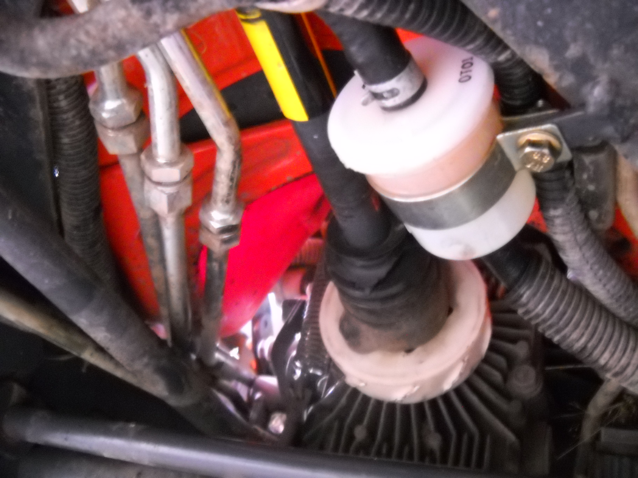

Okay, yesterday I went down to take a look at the tractor and first off it wouldn't start. I tried every single control lever to see if something was making it not start as a safety switch. turns out there is a bad connection under the seat on the left side that you have to hold together to get it to start. I crawled under the tractor and sure enough the old filter is all black and has never been changed although Kubota serviced it just last year, they apparently missed the filter under the tractor. But the next part is what wasnt good. Since the underside filter is near the famous white tranny fan I looked up in there and sure enough all the fins on the fan have been sheared off. :( It looks like it has been like this for a while but i know that it needs to have a fan. I let my neighbor know what all was wrong with his tractor and gave a rough estimate on what it would cost for Kubota to fix it. He doesn't like how it is running poorly so he is having me order a fuel filter for it. For the tranny fan, he wasnt as concerned. :confused2: I would like to know what the purpose of the fan is and how it helps. Yeah it is for cooling the transmission but what would happen say if we left it? If it were mine i would fix it and i did convince him a skid plate would be a good thing to add to his tractor but the fan has me really concerned. I am planning on getting the fan anyways although he doesn't exactly want to tear apart the back of his tractor, any advice on how to handle this situation?

The HST cooling fan is definitely needed to help keep the HST cool on hot days. The HST fluid on a hard working BX can avg up to 100 degrees hotter than the ambient air temp and when it's that hot it's not doing one of it's primary functions in cooling the HST so he needs to have it replaced.
Unfortunately it's somewhat of a major ordeal to replace it. In short form, the engine needs to be unbolted from the frame (4 bolts) lifted slightly then slid froward an inch or two inorder to gain clearance to remove the driveshaft to relace the fan. It can be done without removing the floorpan but it's not easy. Removing the floorpan which requires more parts to be removed makes R&R'ing the fan much easier but adds addtional time to the task. Tell your friend that he needs to install a skidplate to protect the new fan. Many have made their own. Bro-Tek makes a very nice aftermarket skidplate that many here have purchased. The plate will also protect the hst filter which is also in harms way and vulnerable.

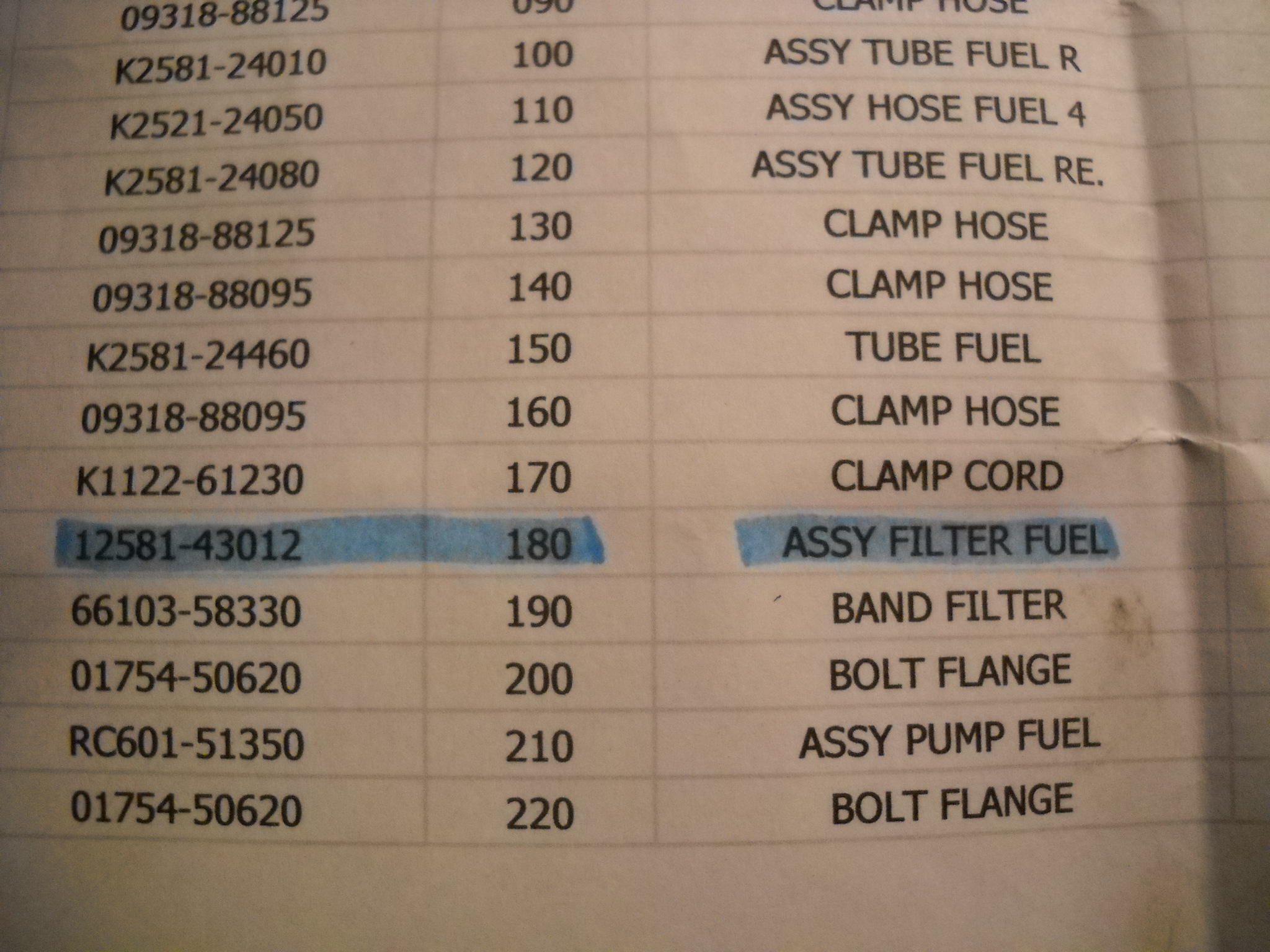

Both fuel filters are the same part # and don't cost much.

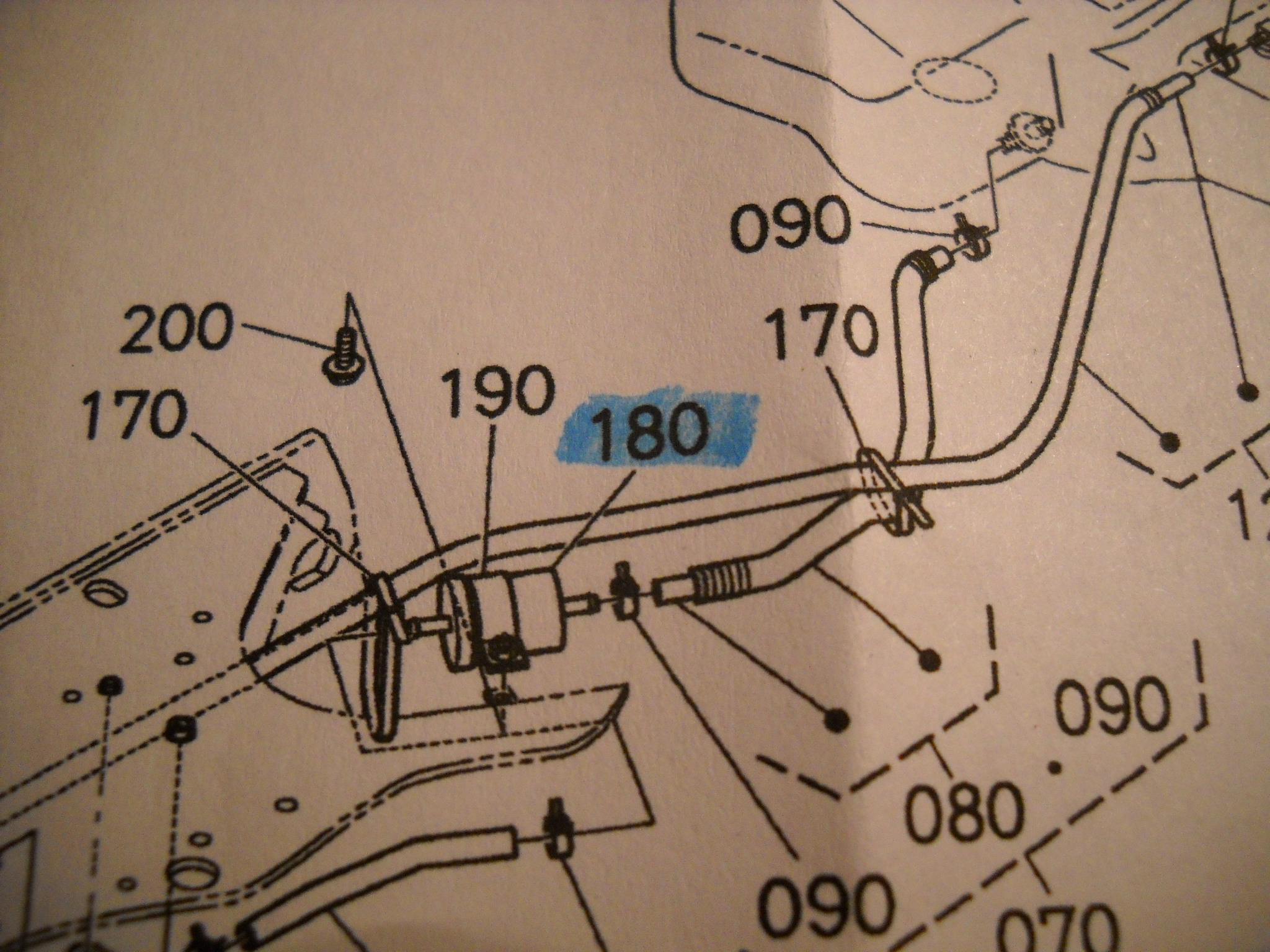

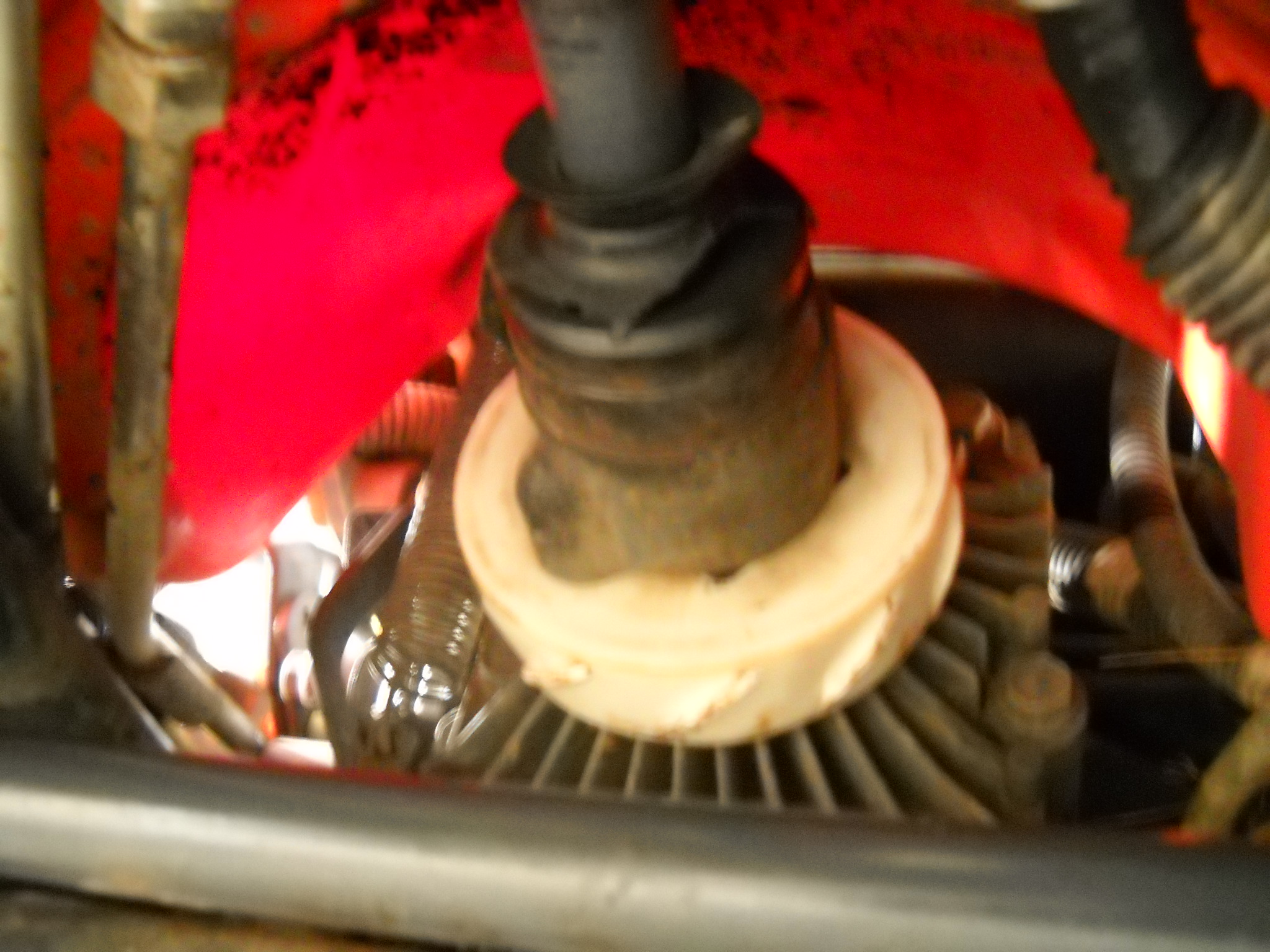

Today i finally got around and changed the fuel filter on the BX24. That old one was shot, fuel dripped out when I unhooked the first end. Once I got the new filter on it was a nice steady stream of Diesel. :thumbsup: Now Here are some pictures of the Hydrostatic fan, not it the best conditions. My neighbor is certain that it can be removed and a new fan can be installed by doing it under the tractor. I got the go ahead to order the fan for him, so i will be on that this week. In the mean time, now that his BX runs good I have a feeling it will be used more. Will not having the fan there for about 1-2 weeks make a difference. He assures me he will be very light on it, using it minimally but what would be the first thing that would happen if it was left alone? Would the seals in the tranny start to blow out? Thats my guess. Thanks for all the help guys! :thumbsup:
   / BX24 problem #26
hmm -- no fins on fan .. and owner wants to keep running? uncharted territory. Not the kind of waters I want to travel into. As for replacing it.. there been several threads on this- and they all say its major surgery unless you take the shortcut and cut the new fan in half and glue it in place.
congrats on the simple filter swap... looks like it is all it takes. :thumbsup:
