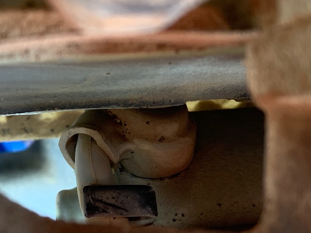

Tested the battery both with load and no load. 12V. Tested the cable connection from battery at starter solenoid also 12V.
Now, am not sure which leads to test on the solenoid.
Next to the battery cable is a wired snap connection.
There is also a thick short insulated cable between the solenoid and the starter. With a boot around the connecting end on the solenoid.
How do I post a picture here?

Here's the battery cable and the snap connection.
Here's the boot.
Not sure which one I need to check voltage on.
The battery cable to the solenoid has full voltage. So from the battery forward to this point, it's good. Things are getting very tight inside the engine compartment.
