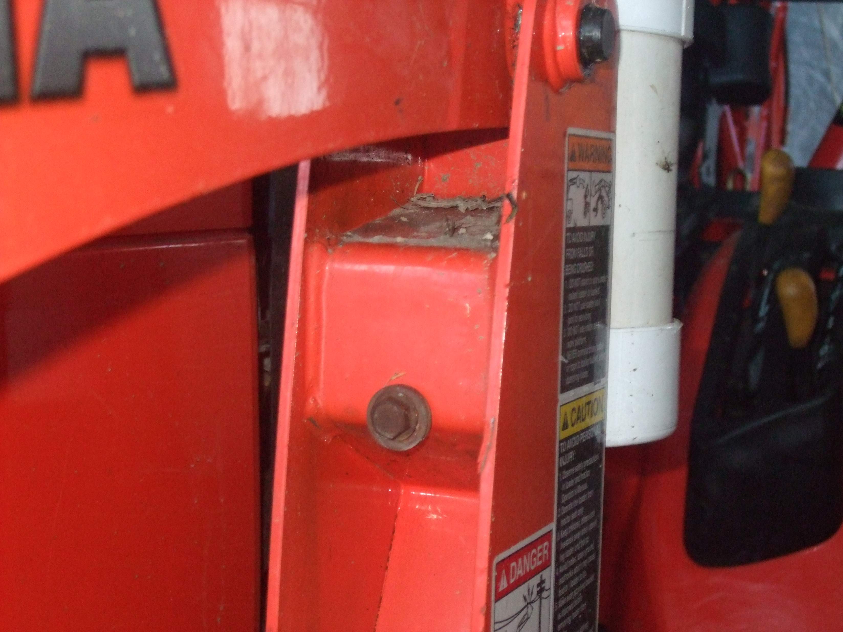

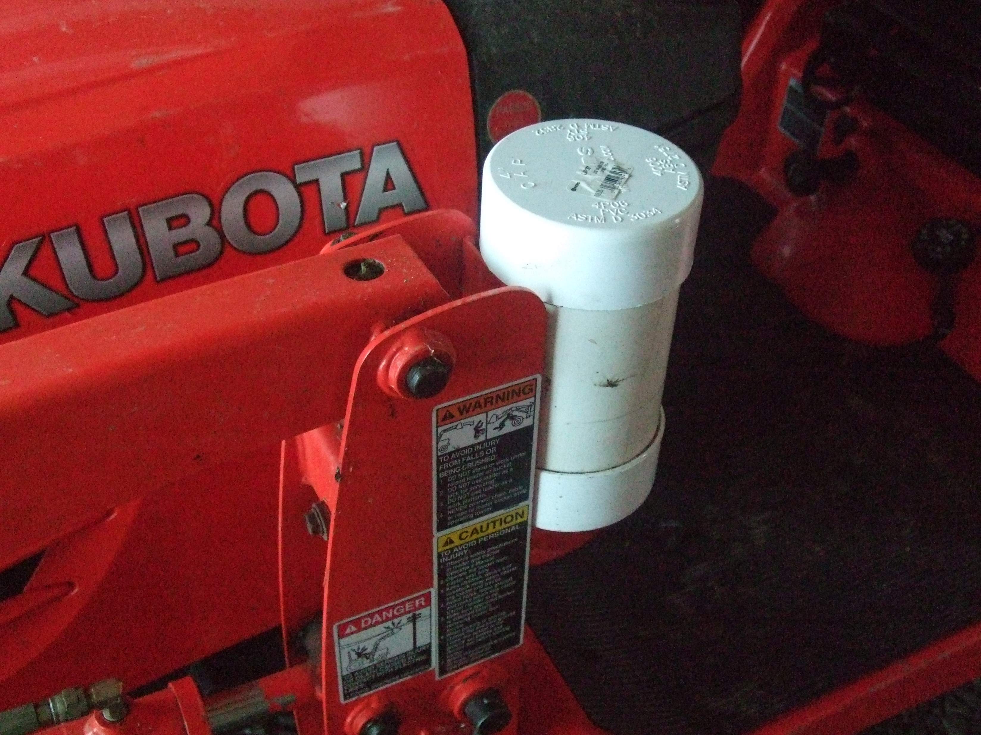

/ BX24 Toolbox #6
Try using PVC with endcaps. I was able to add it to the FEL. If you look on the FEL upright arms, you will see a hole already predrilled there. I just drilled a same size hole through the bottom endcap and pvc pipe. Just add top endcap to keep the rain out and tools inside from the bumpy rides.:p I thought it was pretty nifty for toolbox on BX. I probably will end up painting it orange this winter to match. The only downside to this tool box is that its mounted on the FEL and it won't do you any good if you removed FEL and need the tools. :rolleyes: At this point the BXpanded bag is looking good, but i dont like bags. I prefer somthing solid.:)

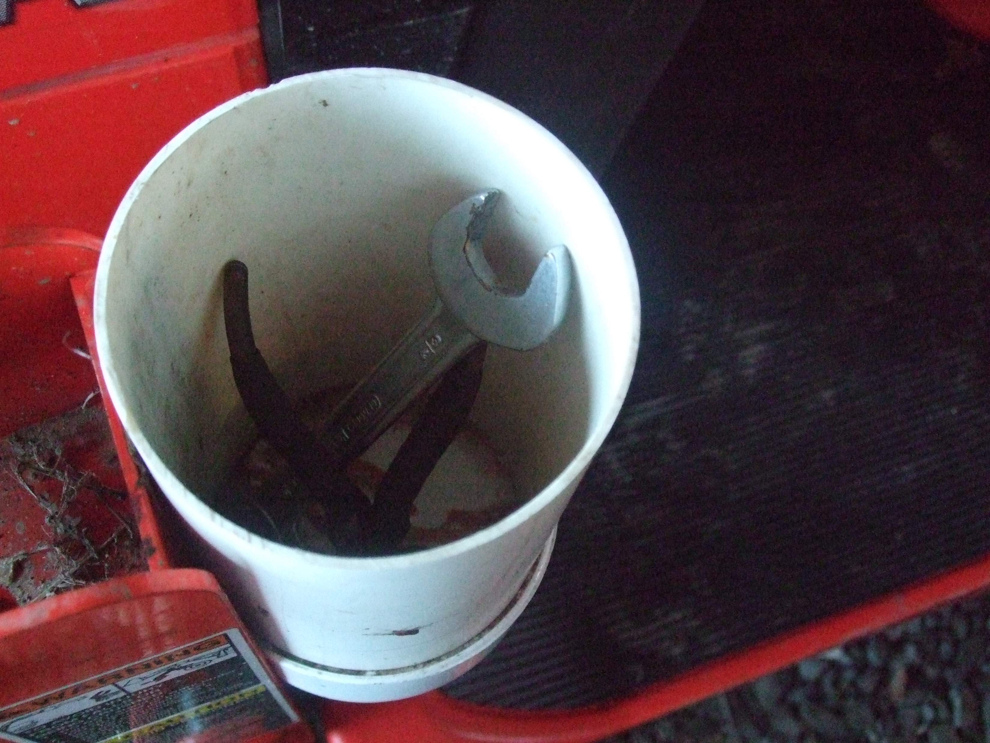

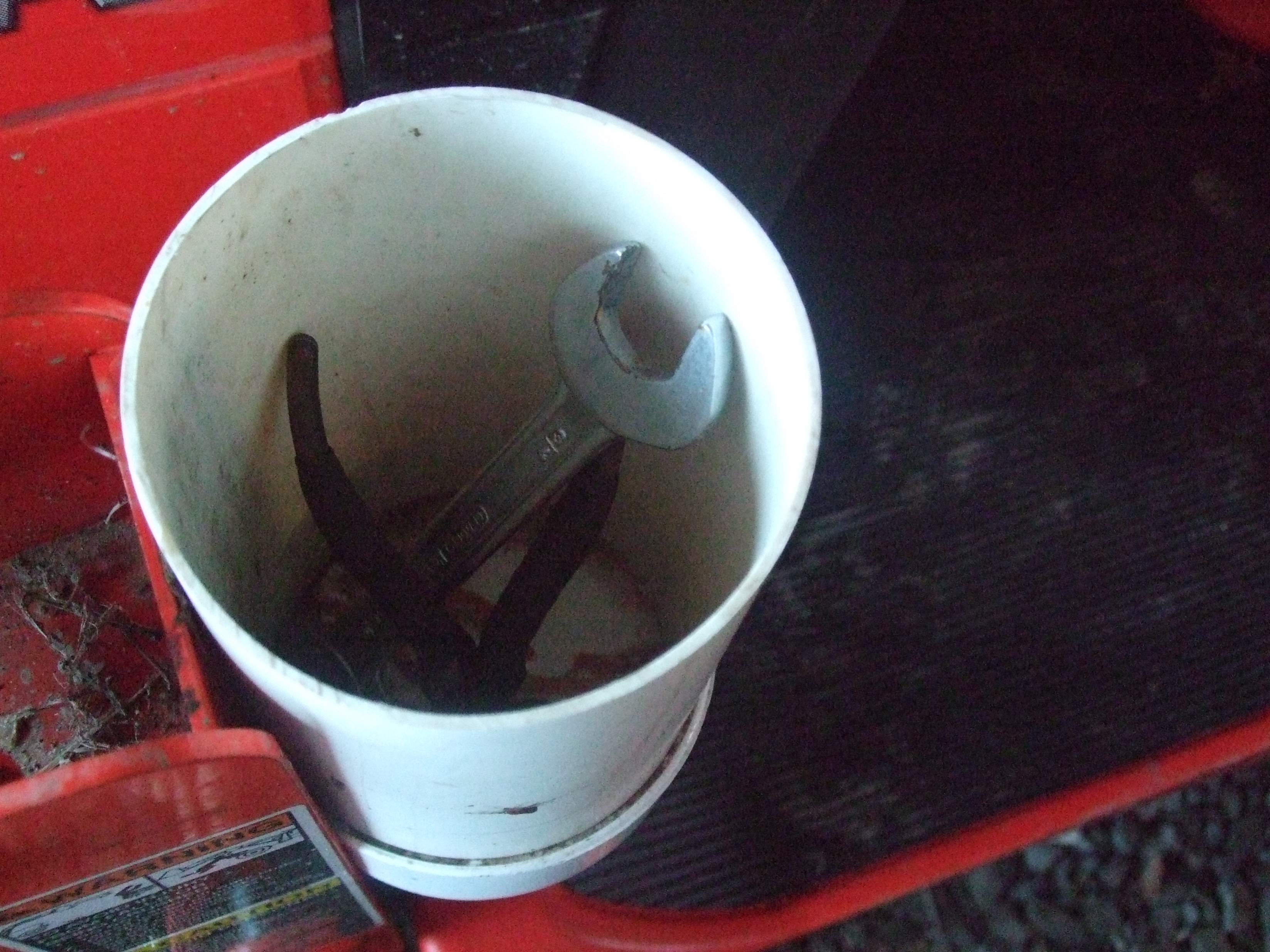

/ BX24 Toolbox #15
Dean,
Here's you another look at a pvc version. I copied radioman's example ... just right for a few hand tools or a couple rows of toilet paper :D
FYI: If you go the pvc route, use the thin wall (sewer pipe) ... the end caps are about 3 times cheaper that the thick wall (schedule 40). :eek:
