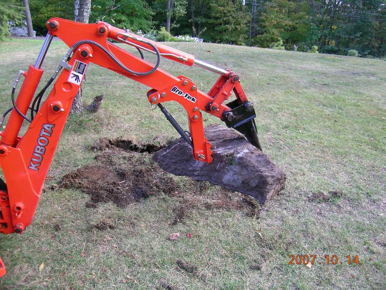

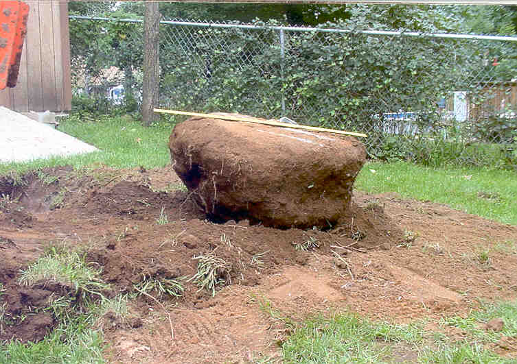

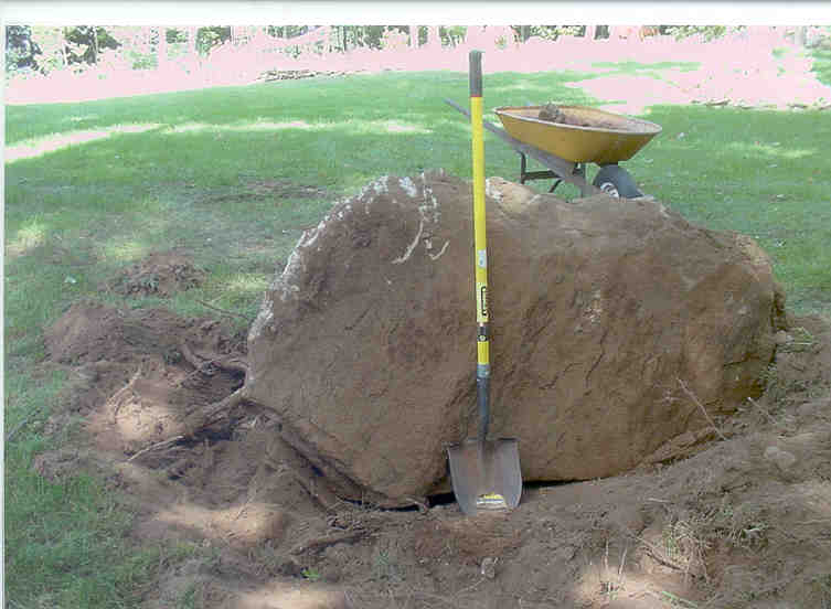

Bruiser, I live about 20 miles north of you, so we have similar rock problems. I have a BX23, and am very happy with it. It is a small tractor but can do more than you would think. I found that the Bro-Tek ripper works great on popping out rocks without tearing up the lawn too much. Here are a couple of pics to give you an idea about its capabilities. Obviously a larger tractor will do more, and do it faster, but the BX23 fits my need perfectly. The rock with the shovel leaning on it was pretty flat, so the picture makes it look heavier than it actually was, but it was pretty much at the limit of the BX23.
Ken
