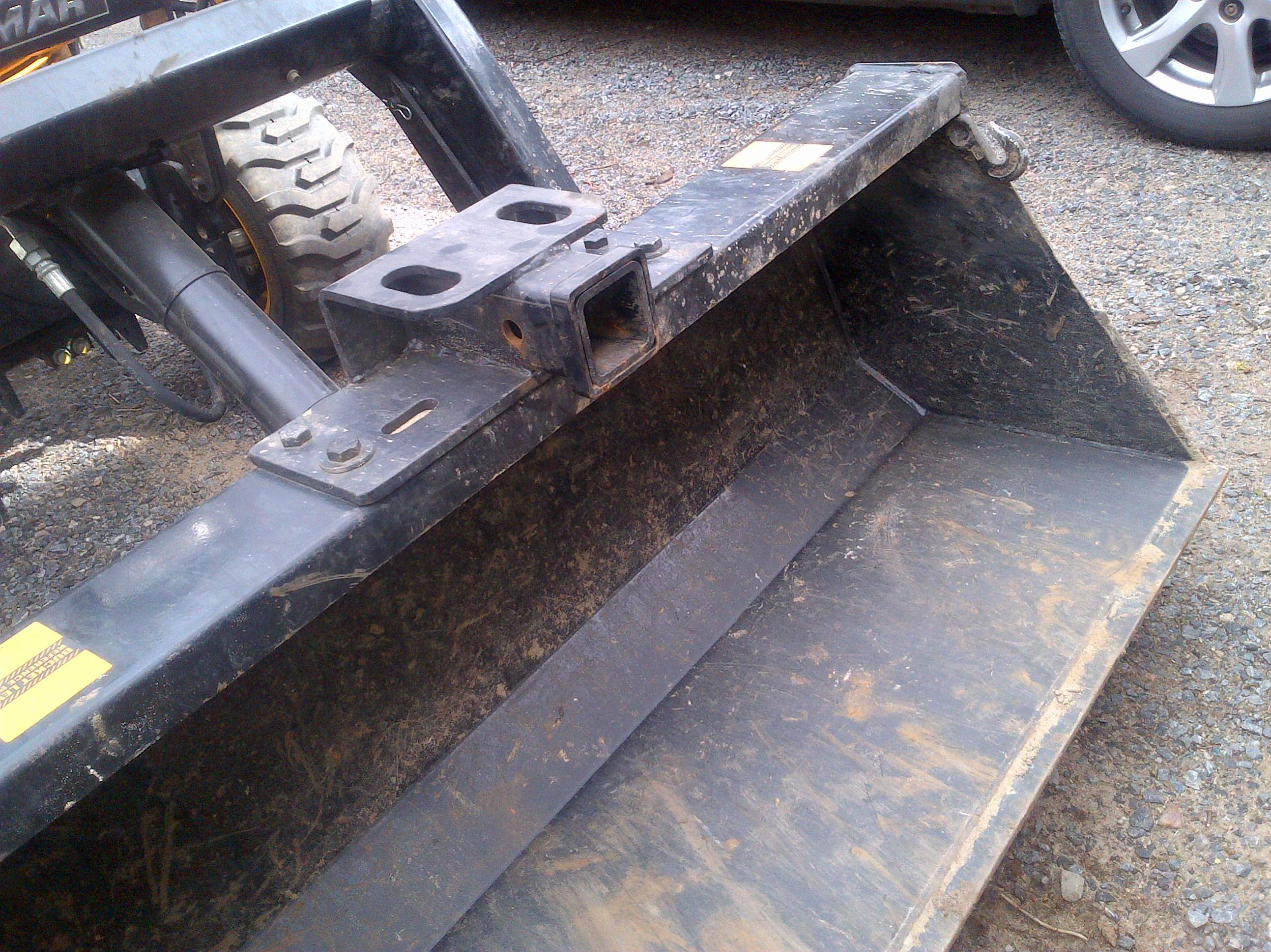

Here's mine
I got the bumper step hitch on sale for $20, reg $49.
Attached using 4 half-inch bolts
Does not get the way of FEL operation.

is no good!
SO, IMO, 4 bolts in compression marrying a reinforced plate as pictured to
the OE frame distributes pressures better, wait, what did I say? "IMO".
(and you know what, I bet ya a non biased structural engineer would
WHOLEHEARTEDLY agree w/ me)
Artisan, second thought after looking at your pictures again, I do not like the low tie down you are useing as the 25 is top heavy anyway. I normally have the BH on when transporting so tie down across it, if BH is off I use the upper BH mounts. I like to really pull down on the tires.
Ron
   / BX25 Front and Rear 2" Receivers #19
Ron
Lower is safer. Any pull point above the elevation of the axle has potential for flipping the tractor over backwards.
I am a non-biased structural engineer. Artisan's pictured 4-bolt connection is definitely superior to a 2-bolt connection (which is NOT to say the 2-bolt is not adequate for anticipated loads). BTW, those 4 bolts are loaded in shear, not compression.
   / BX25 Front and Rear 2" Receivers #20
Radir, I was refering to the tie down transport straps. The goal of transport tie is to make the load integral with the platform to eliminate movement which dynamically loads the straps. I agree, the lower down you pull a lateral load the less chance of a end over end flip. That is why I plan my logging winch tied to the BH mount; keep it low and directly loading the frame. The 3PT hitch would be a weak link.
Ron
