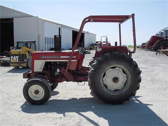

Just be careful, ROPS, and FOPS are very well calculated to have stress points, and if they are too rigid, or too weak, you can have catastrophic failure, and be crushed. I would try to invest in an OSHA certified ROPS or add a certified FOPS:
When the tractor above flipped backwards, this homemade ROPS tore away at the axle housing, instantly crushing the 14-year-old operator to death. The ROPS was undamaged.

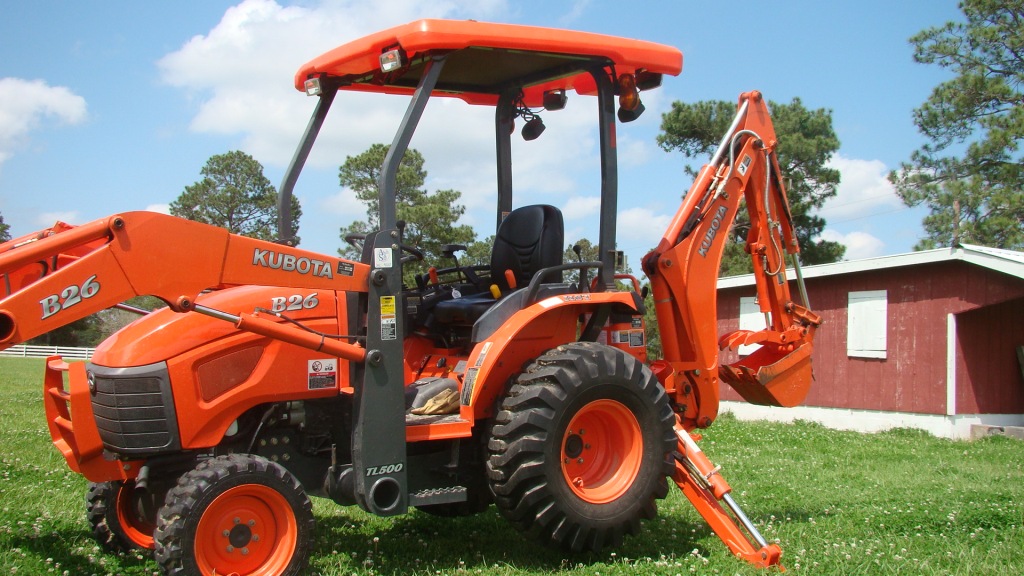

They make certified FOPS the for the B26, and they may fit yours? (#2) I would call Kubota. That way if something happens, your insurance will cover the accident, and I would hate to see someone get crushed. Sorry, not that I doubt you fabrication abilities one bit, I just know that these devices undergo very stringent and very expensive testing, and they correct from the failures that they have.

GARY that could be the ticket! Is that your beauty of a tractor? NICE!
If it is yours and if you have a camera I would love to see some pics of the
superstructure up under there w/ maybe a flash on... if possible?
Building off the top of the FEL support JUST like Kubota did is my idea,
just in a different, obviously, way.

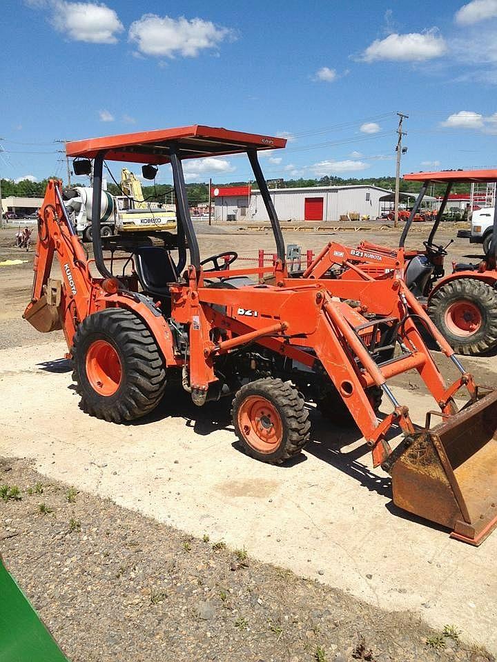

Well the B 26 is in process of being mine. MissingTexas and I have made a deal, I just havent paid for it yet since I am out of the country till end of the month.
Do a google search and look for a B21 photos. It has the same structure on it but has the more traditional FEL framing and the FOPS on it attaches more similar to what you would have to do with the BX25. The B26 has an special frame that attaches to the tractor and the FEL and Backhoe attach to this frame. Carl NH can get you some close ups of the B21 that he has and how to attach the frame work.
I found a couple of photos of B21 on internet. Hope it is good enough to determine if it will work for you. Hopefully Carl can get some good closeups for you.
