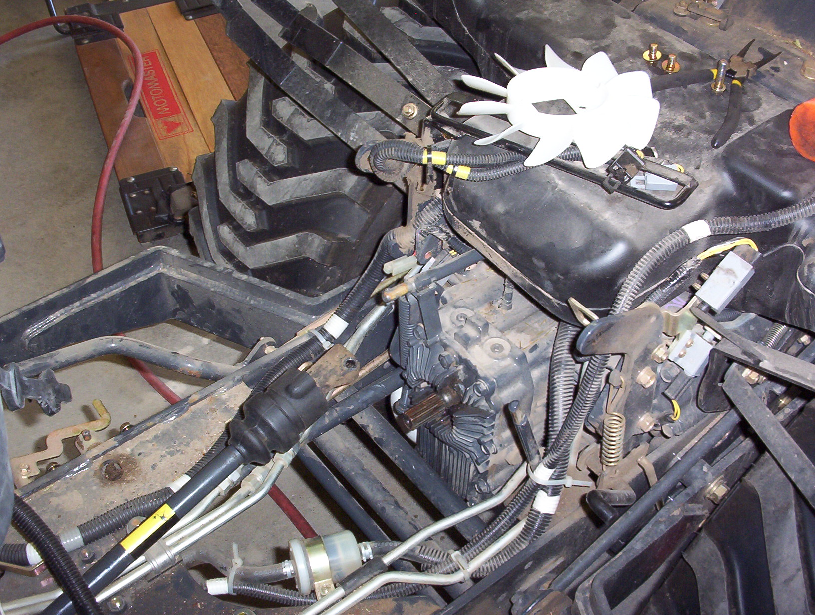

I would like to ask a question. The bolt that holds the shaft to the splines , how do you get to that bolt? It seems the fan shrouds it and is tight up against the HST cooling fins.
Thanks on the pics. I would've taken more but the battery kept dying on my old camera.
Because I had removed the floor pan access to the shaft retaining bolt was easy. There is room between the cooling fins to access the retaining bolt (see photo). Come to think of it getting access to this bolt would be quite the challenge without having the floor pan removed.
(Edit) I realized last night that information here is misleading. In order to get to the bolt from above you not only have to remove the floor pan but also the rear fender. Removing the floor pan alone does not expose the area to access the shaft bolt. But removing the pan does allow you to take off the rear fender (after removing the ROPS and seat) which *then* allows you to easily access the shaft bolt.

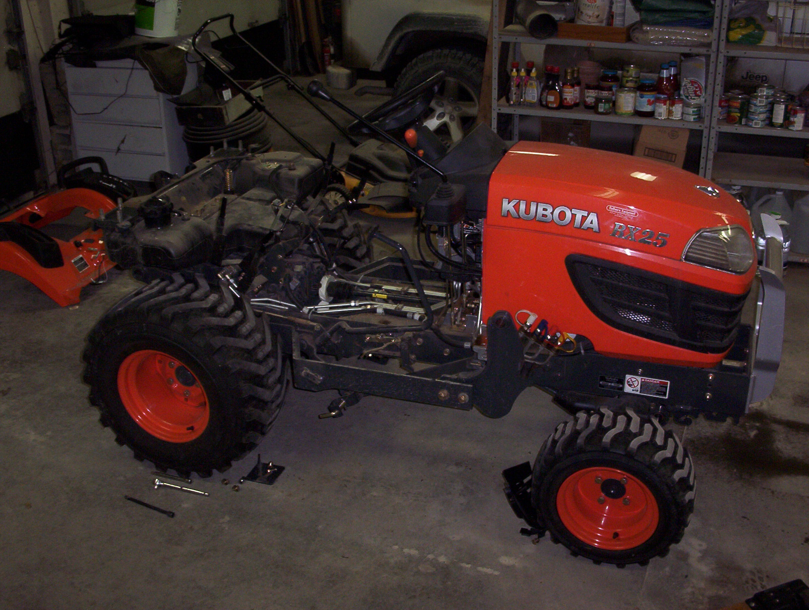

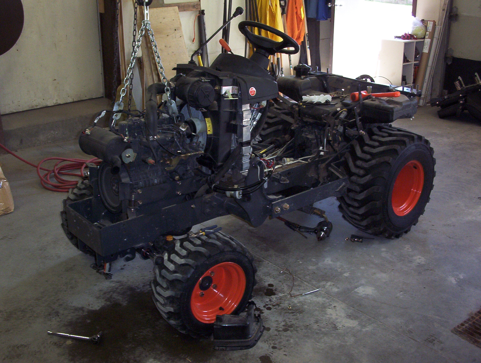

When you lifted that engine, was the radiator and fan a problem? Or is it all one assembly? How long did it take to get the floor off?
The rad was a bit of a problem. The engine and rad are not one assembly - I'm not sure if this changed with the BX25. However, I can't believe it was only 2 days ago and I can't remember all the details. I'm either getting old or work is really stressing me out. What I remember:
I had started by draining some of the rad fluid and detaching the upper rad hose, my hope was that I could take the weight of the engine on the hoist and then slide the engine out so the fan wouldn't interfere with the plastic shroud. But this wouldn't work. I had to lift the engine a few inches to clear the engine mount posts - so couldn't do this without the fan interfering with the rad shroud. So I reconnected the rad hose and disconnected the shroud (4 bolts). From the looks of the pics I think that allowed the rad and the shroud to move. Note though, that these are a separate assembly - only attached to the engine through the rad hoses. I manually moved the rad assembly myself along with the engine. Both of these only had to move up a few inches and then towards the front. You really have to watch for which wires and hoses needed to be disconnected to do it safely. I recall having to disconnect the starter wire - engine grounds - diesel return and feed lines... hmm.. and had to clip a couple of tie-ons.
It really wasn't too bad - just had to move slowly to be sure I got everything. I was pretty impressed with how 4 bolts freed the engine - and another 4 bolts for the rad shroud (and rad?). Anyone whose done any major car or truck engine work will really appreciate how easy it all comes apart.
Let me know if you want more confirmation - I'll take a close look at the bota tomorrow when I'm out in the garage to see if I can confirm if the rad and shroud are all one assmebly.. they must be, but unbelieveably - I just can't recall. :confused2:
Removing the floor wasn't bad either. The trick was to remove the forward/reverse pedal from the get-go. I didn't at first - which pretty much makes it impossible to do. The nice thing is that removing these pedals doesn't affect any of the sensitivity or adjust the function of these pedals. There are two bolts which attach the pedals to the "important" stuff. The bolts holding the floor pan on were locked on tight. They must use some freaky locktite in assembly because some of them took a lot of force to break free. Toughest part of this job was getting the pan on and off without scratching it. Best with 2 people.

I have bolt out and can move shaft some. But not enough to get it off pump. Do I need to unbolt fron engine also. Have fan off, bolts removed,bolt out of spline of pump.what next?

T Seabee, I had to replace the HST fan on my BX22. I did not have to move the engine only remove the floor pan and fenders. Unbolted the shaft from the fan hub and it came up and away so I could remove the fan hub. While it was torn down I replaced both CV joints on the shaft since the boots were long gone.
If I'm not mistaken, on the bx2200, bx22 and bx23 the HST fans can be replaced with out unbolting and sliding the engine. The design changed on the BX24.
