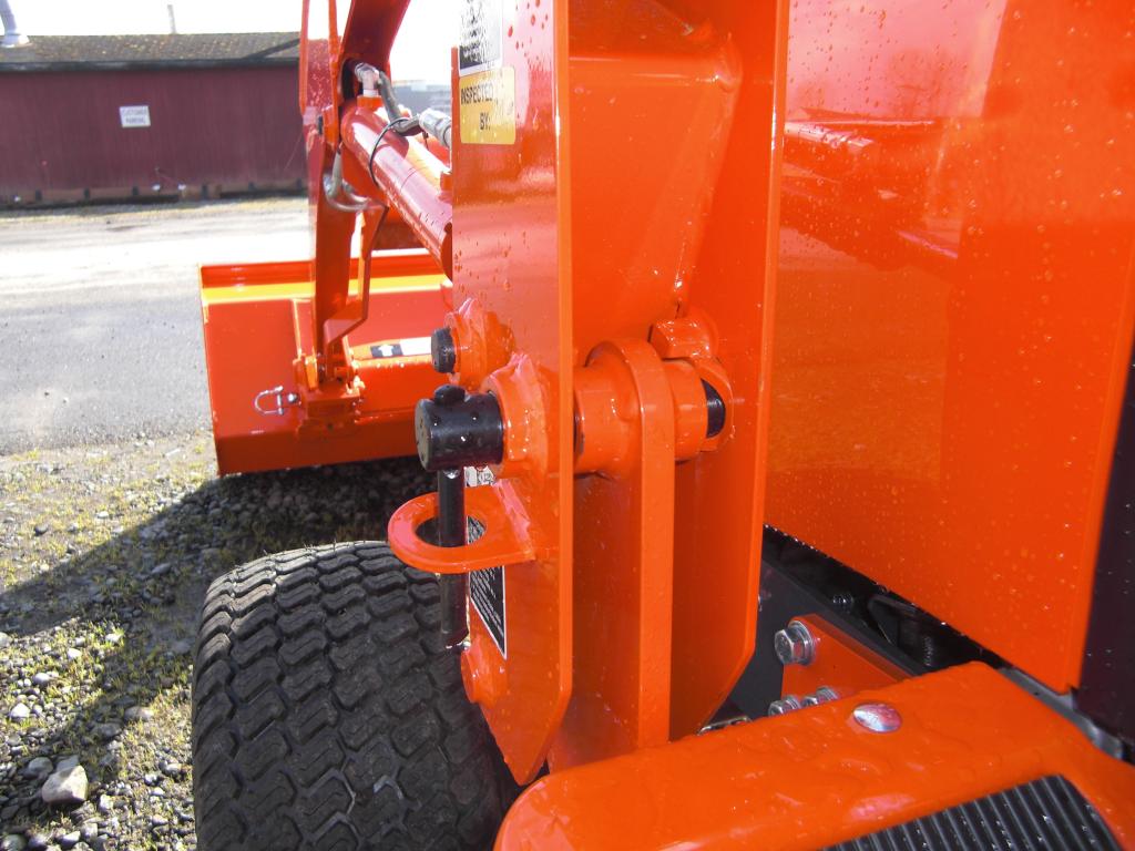

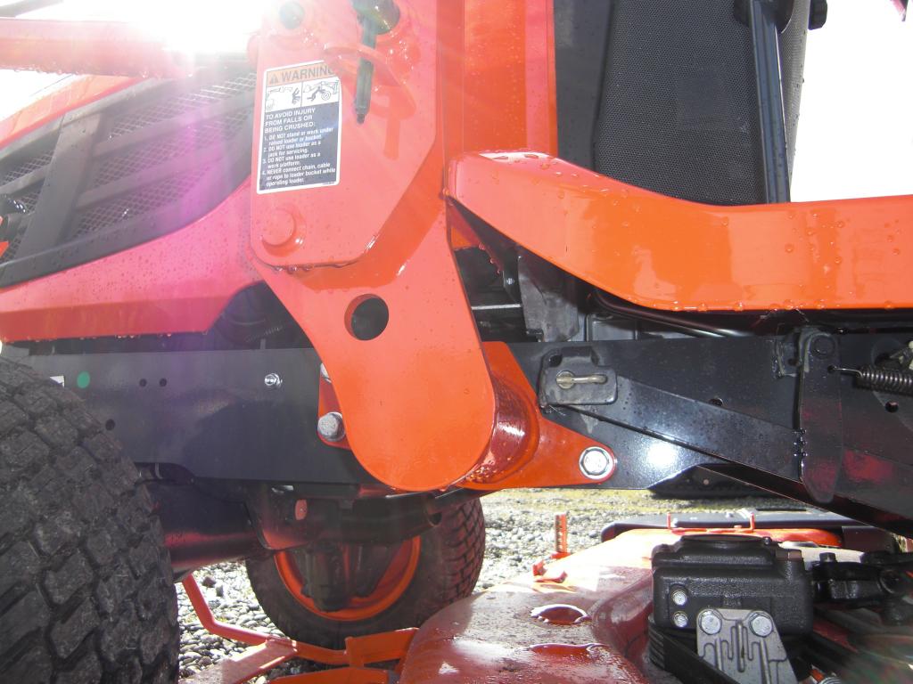

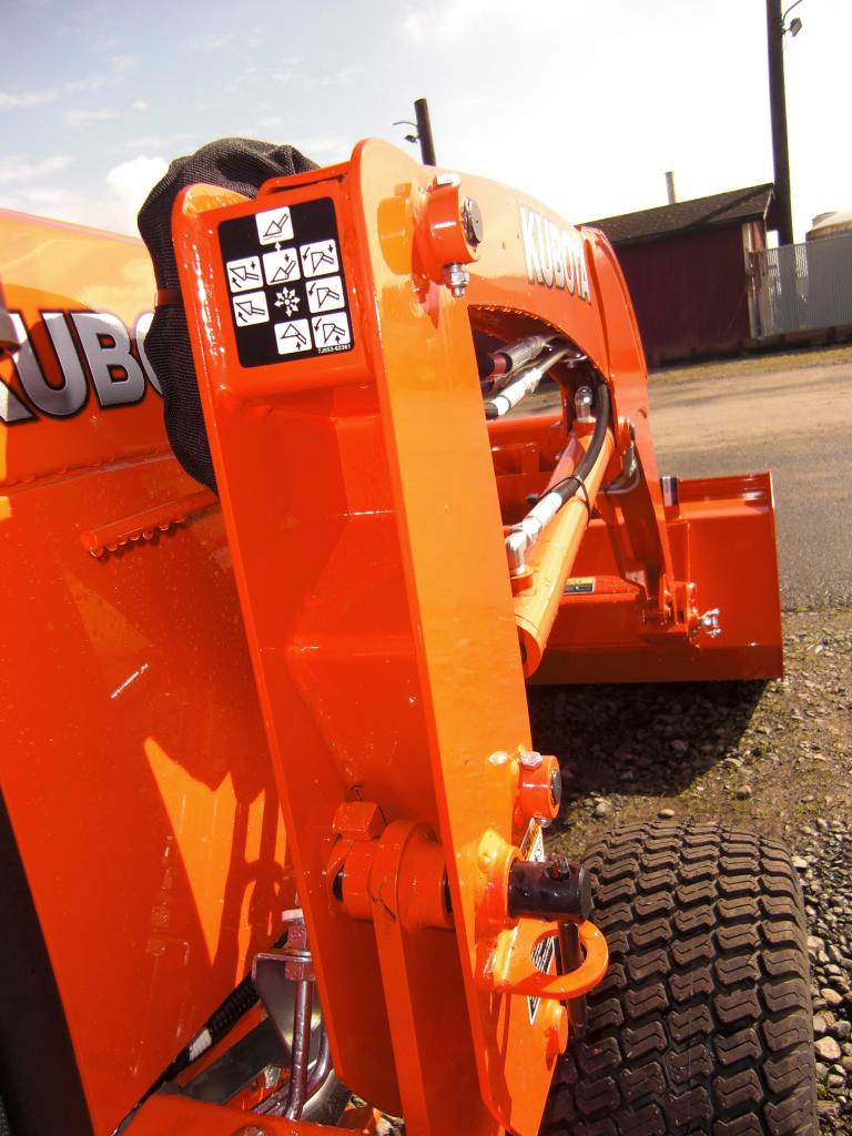

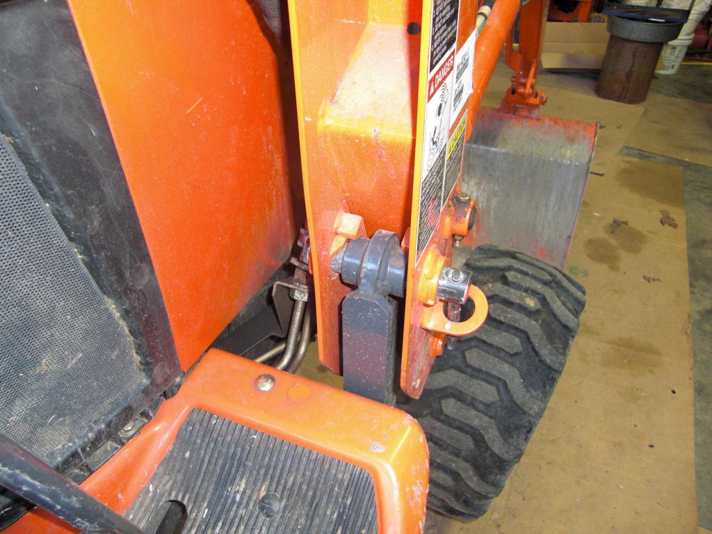

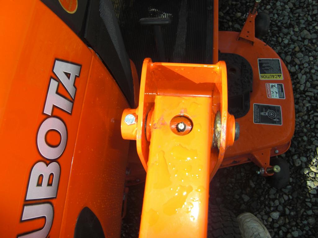

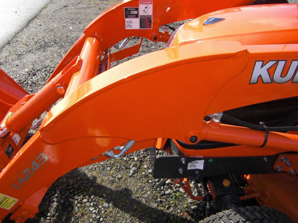

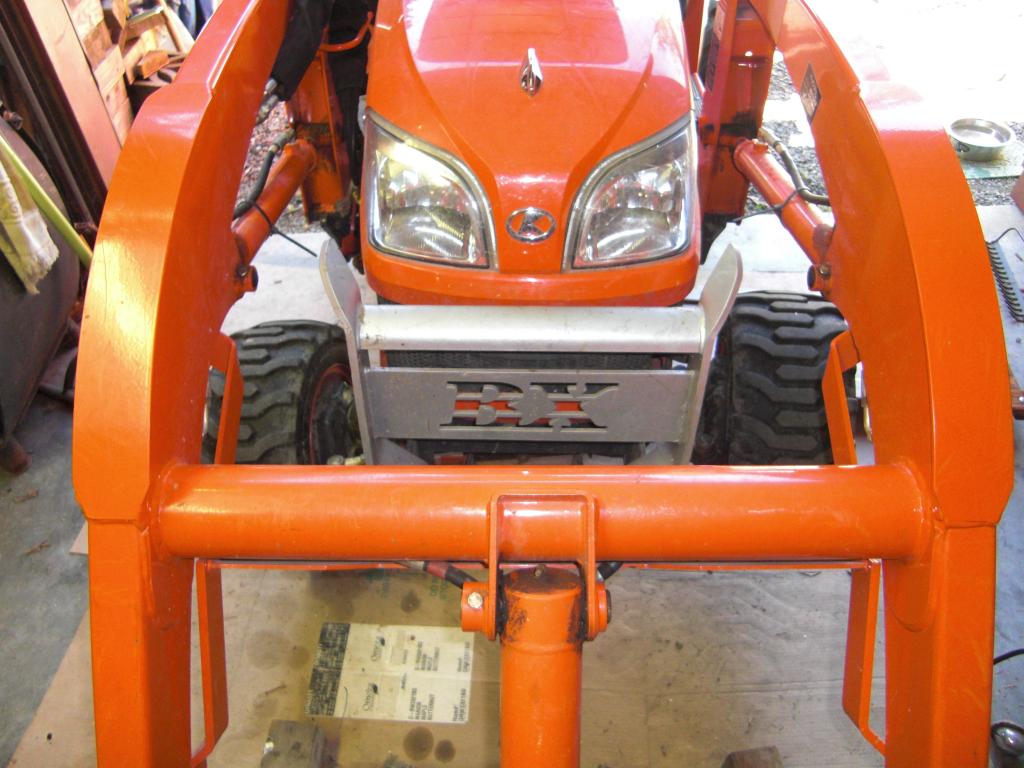

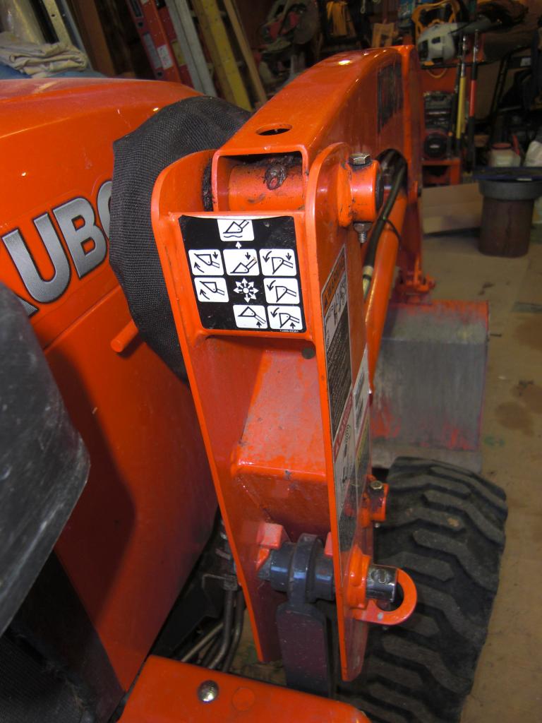

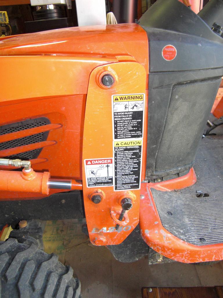

OK...
Here are photos of the new 243 FEL on a BX25D with a QA and my old 240 FEL on my BX24 (2007).
Center cylinder bar...
FEL arm...
Inside FEL arm...
Top arm pivot point...
Side of post...
Rear of post...
Fix arm point on tractor... (Note: A welded "T" piece is missing on the new 243 FEL attachment bracket.)
Mount bracket on tractor...
Rear mount bracket on tractor...
I am not a expert, but I really don't see any big difference between to the two FELs. Except for the "T" reinforcement they appear to be the same. The metal thickness appears to be the same where the "T" is missing. The center cylinder bar could be thicker metal, but I am not sure what that would do as far as structure. If the center bar is a thicker metal I would think it would be a different size and would need to be reinforced where it attaches to the arms. The buckets also look the same.
