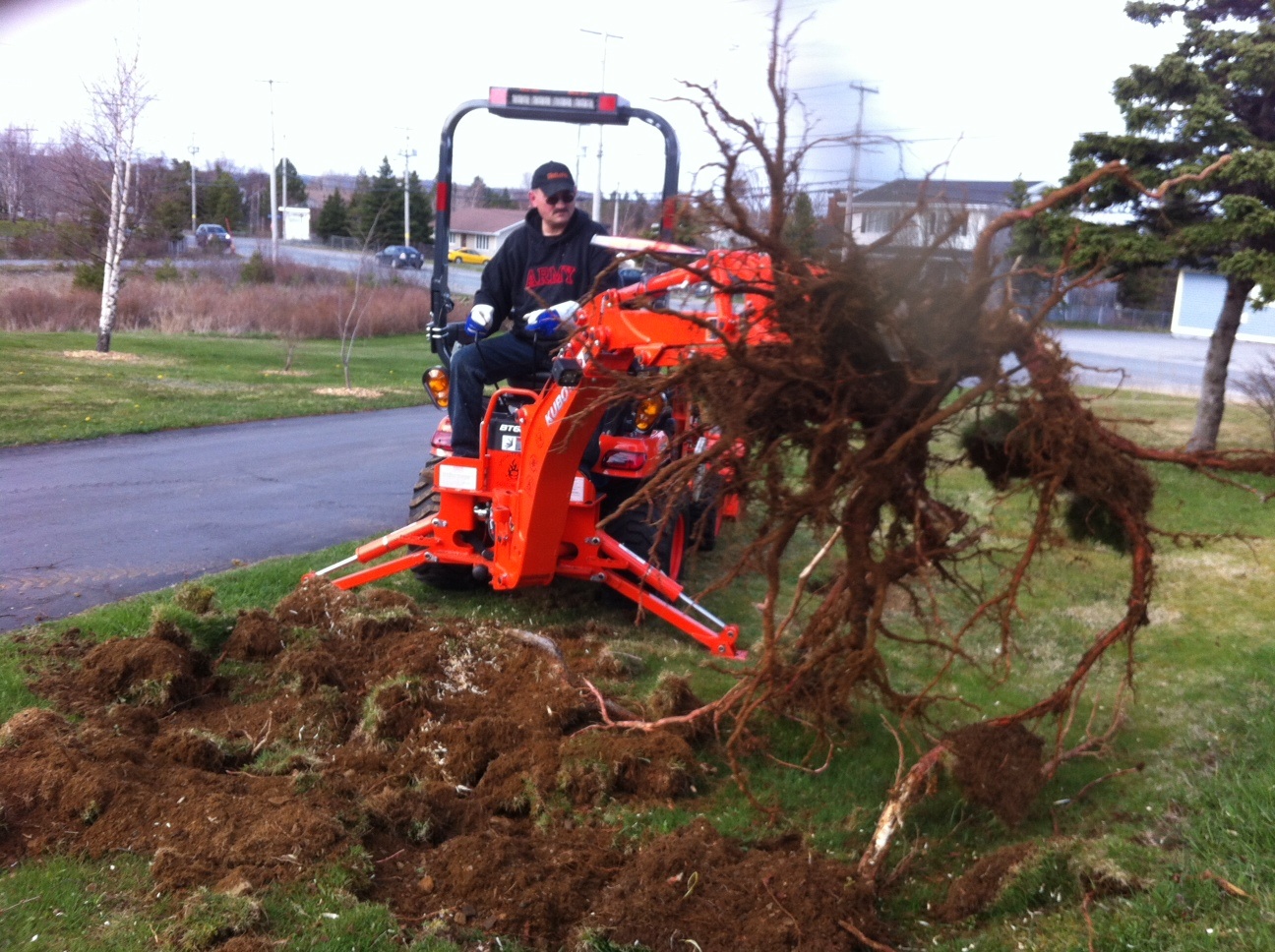

4shorts--what great photos and what a youthful guy you were. The ladies must have been all over you back then, especially when you offered them a ride in your wheel loader. What a charmer.
Any more photos of the completed tractor?
Ha. I was married back them too so I had to be a good boy lol. They are the only photos of the tractor but back then I had another hobby. I used to restore and modify military Jeeps. M38A1's. When I would get them completed a guy would come down from Nova Scotia and buy them up. Oh they were the days :dance1:

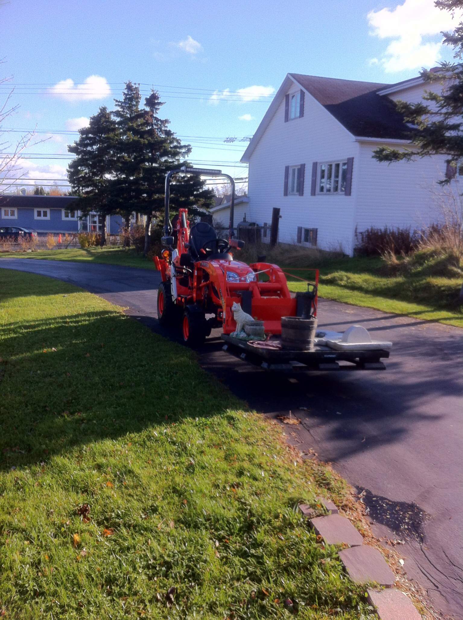

Well today my customer brought in the BX 1800 I converted to a nice resurfacer a few years ago. This BX has a little over 3000 hours on it. It had the usual air filter bracket cracked so I did a little mod on it and added an extra brace to it.
It also had a situation where it wouldn't shut off with the key. When I checked that out I found the solonide let go from the bracket on the injection pump. I did a fast repair on it buy machining a small stainless steel shaft to weld on the solonide. Then I silver soldered a washer on the bracket so that everything will fit good and not slip out.
Had to make a wiring repair because the fuel pump was cutting out.
When he's done with it in the spring I'll get it back and do a more permanent repair to it.
Here's a few photos.
