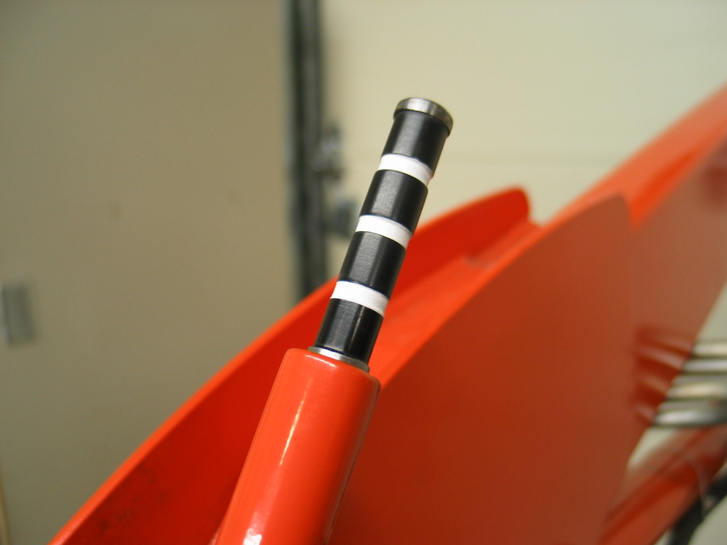

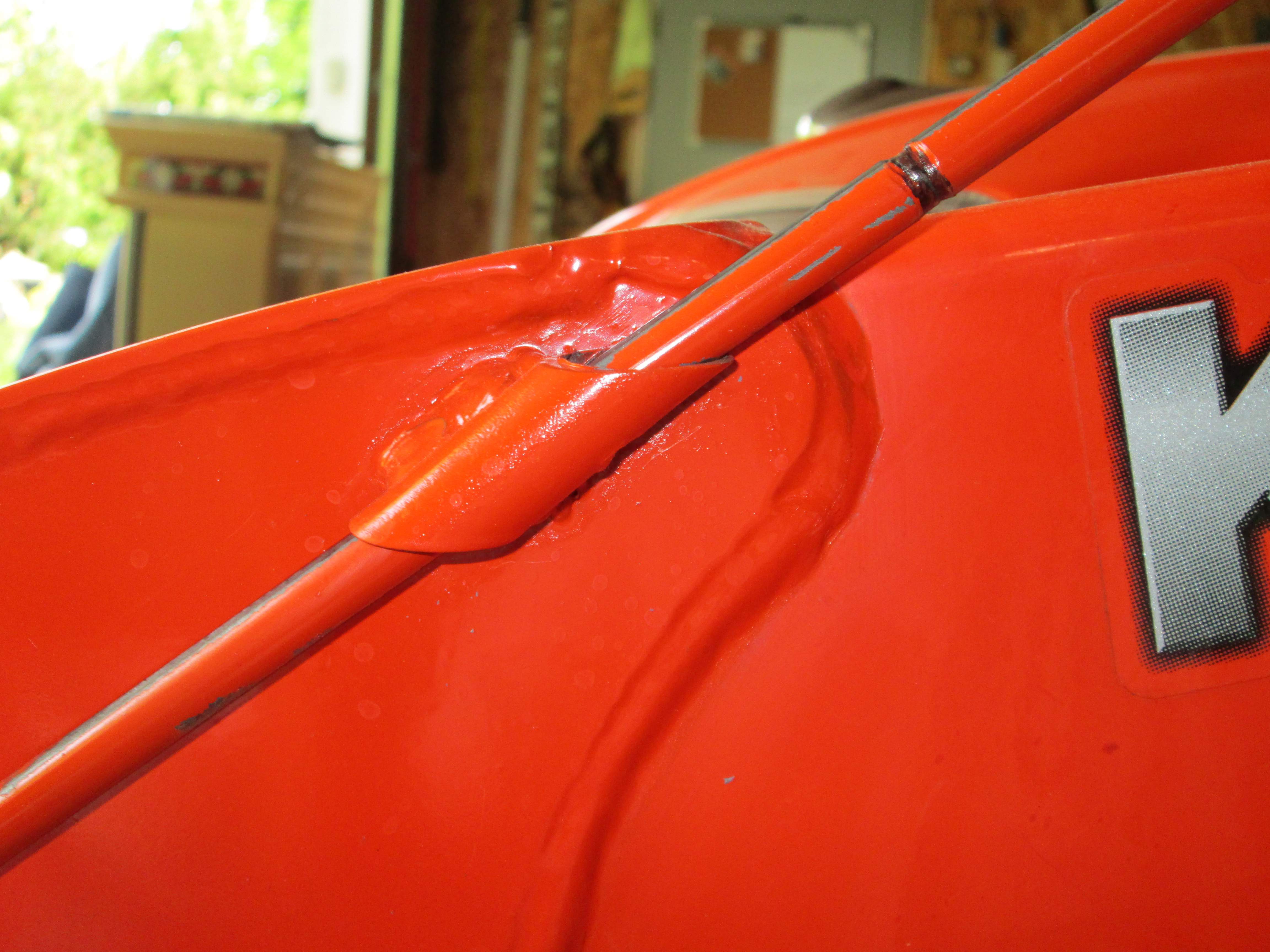

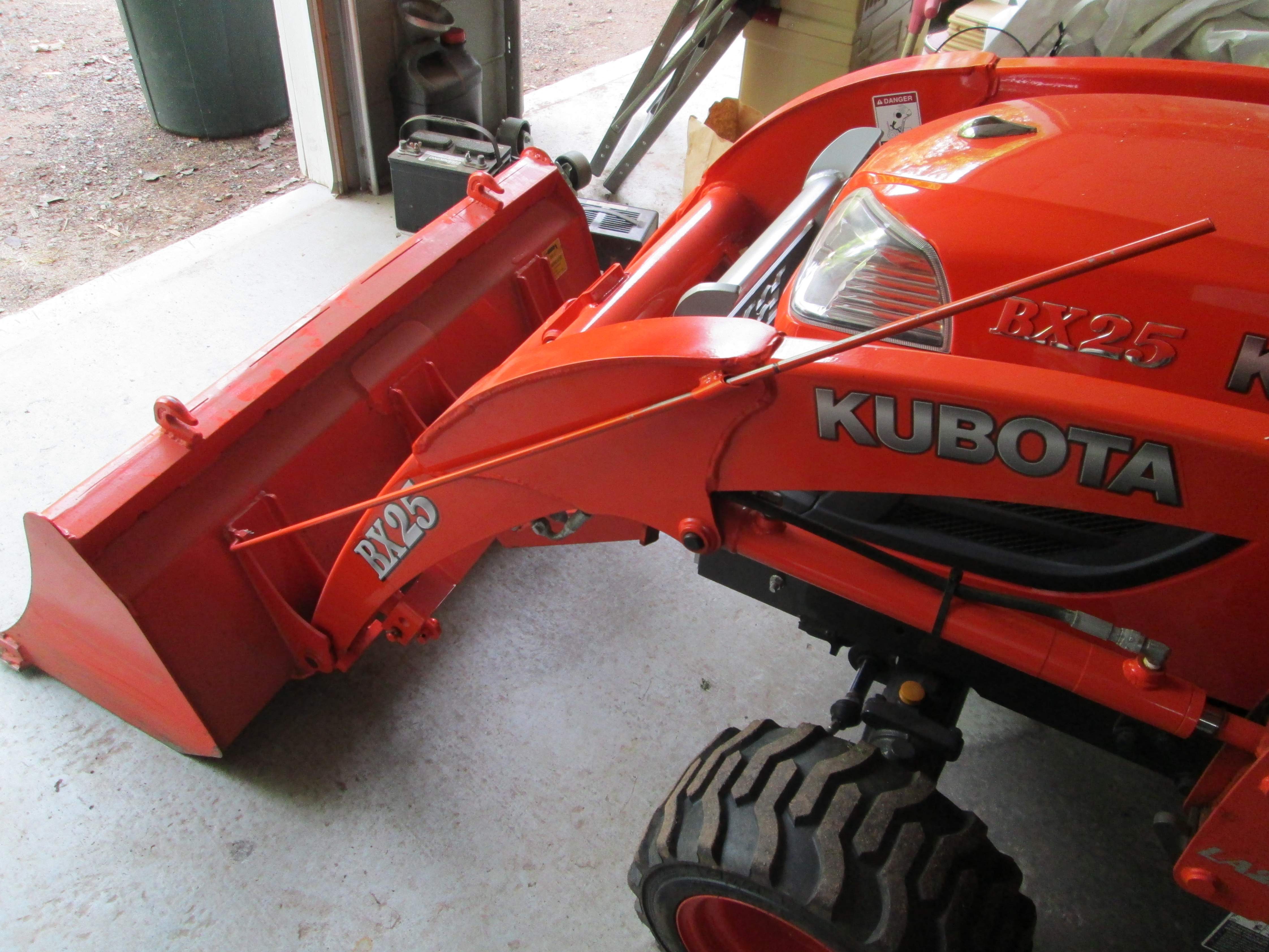

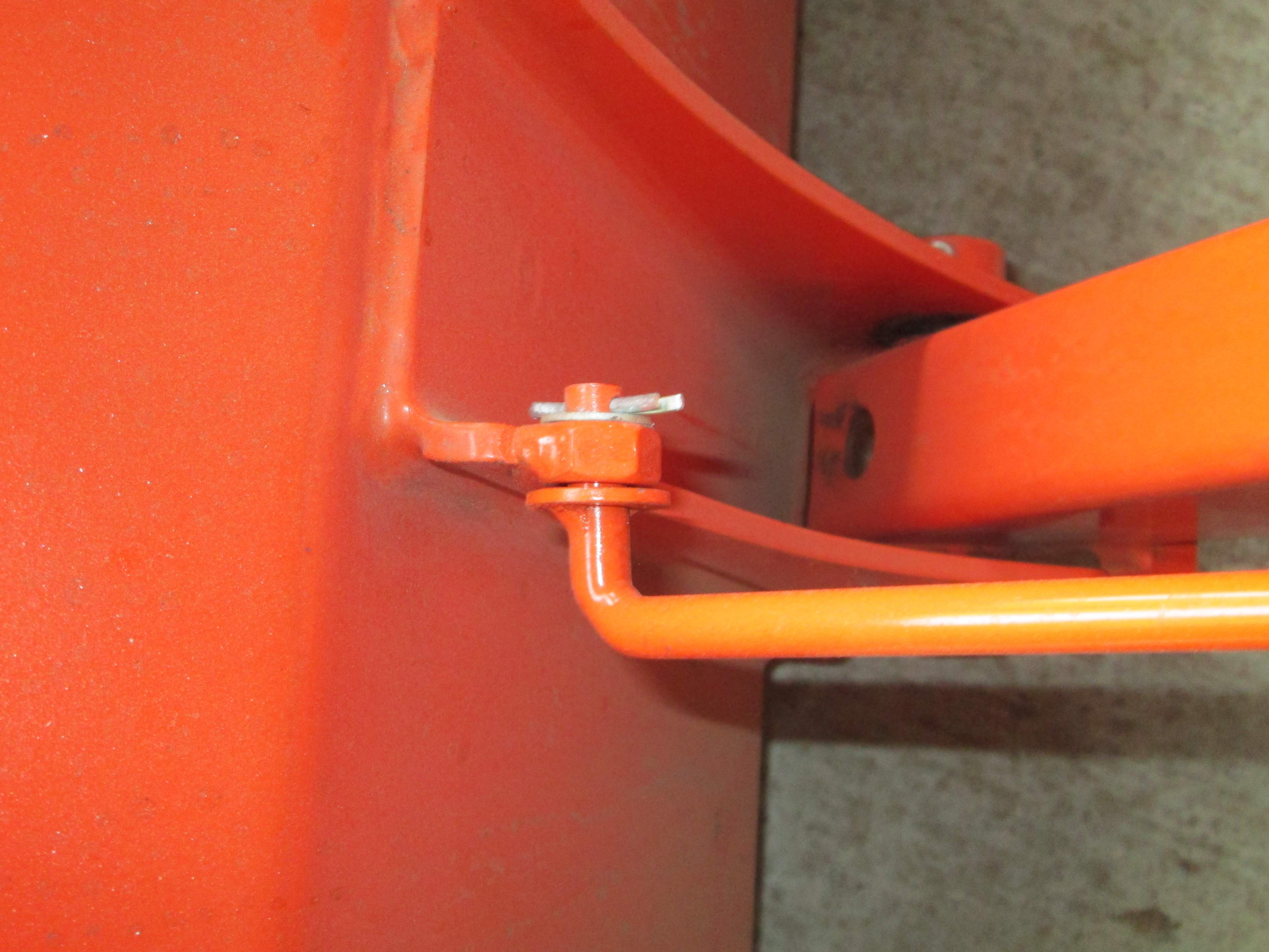

bucket leveler 001.jpgbucket leveler 002.jpgbucket leveler 003.jpgnot to hijack, but here is my bucket level indicator. I needed to make one because I removed the factory one to install angle iron for bucket hooks. It is just a length of 1/4" rod and a stub of pipe for it to travel through. I welded a nut for the rod to pivot on the bucket arm. I also ground a small notch in the rod and gave it some black paint to indicate level. I like it better than the factory one.

Yours is very nice WaxMan, as you can see, mine rubs alittle when the bucket is in full pivot.

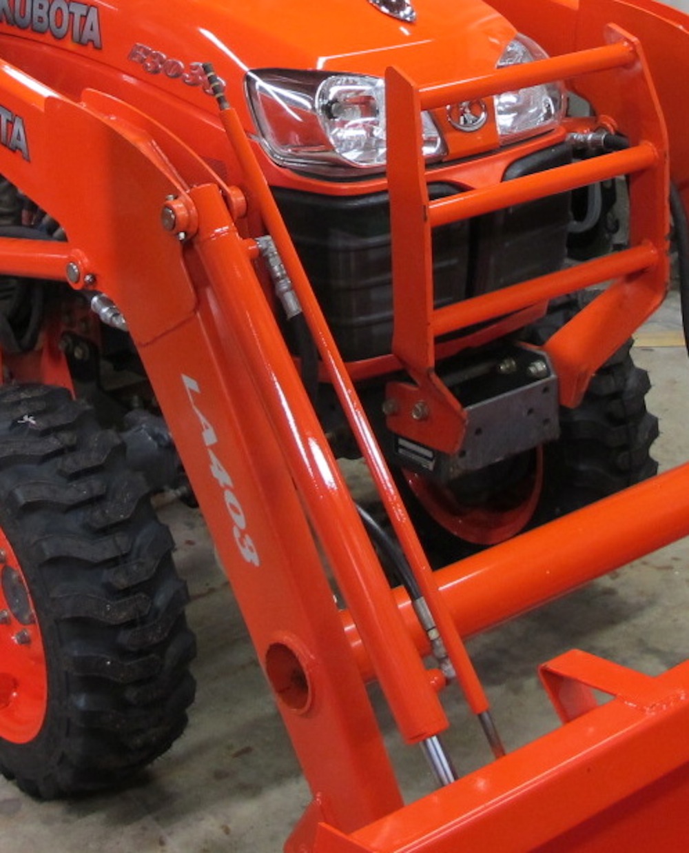

Thanks, I used a full tube so it does not have to be so long like Kubota's style. I also machine the end so it's smaller then the tube and won't rub off.
I attached the tube and rod to the fel piston pivots. I center drilled and tapped the piston pins. The tube is attached to the top pin and the rod is attached to the bottom pin. You can find the level mark if the bucket is up in the air or on the ground. Since the BX only has one piston what you did works best for you. I will be replacing the long Kubota rod on my new 3240
