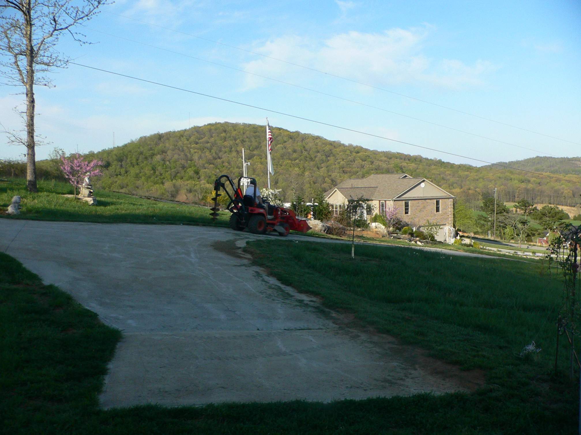

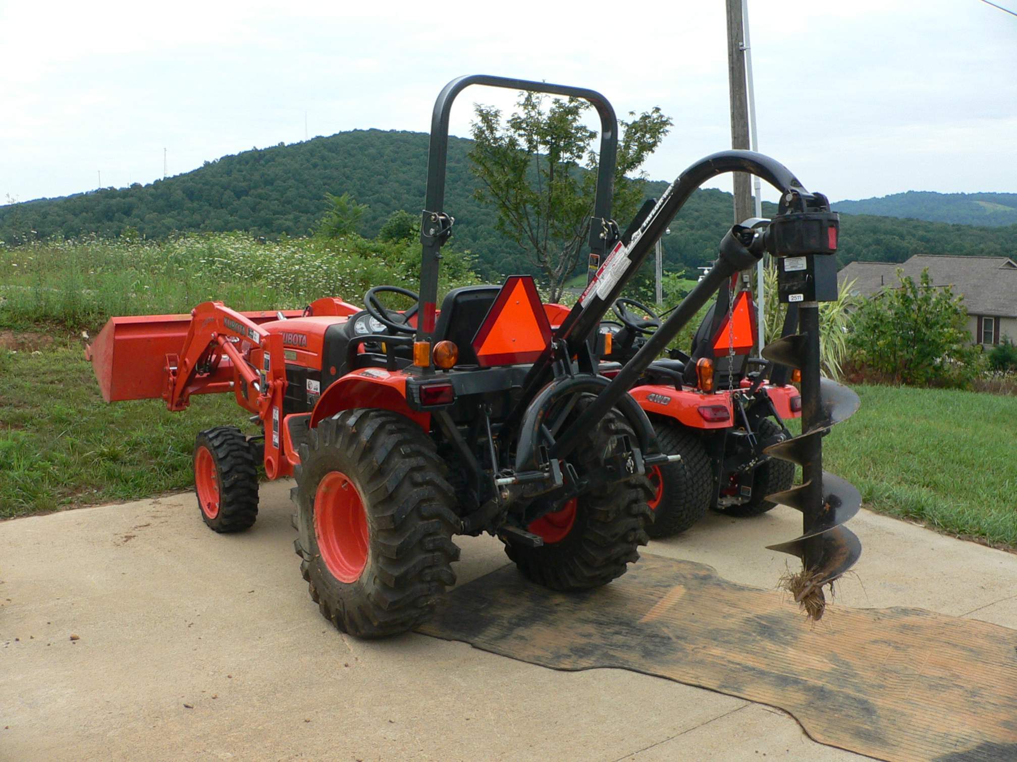

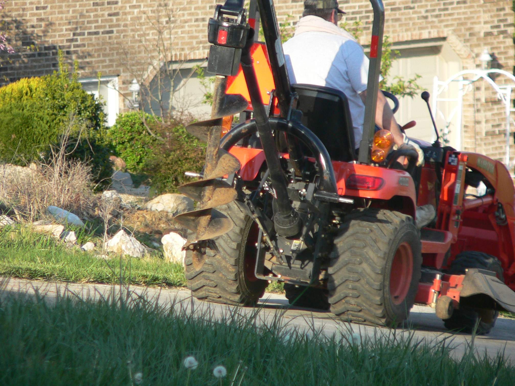

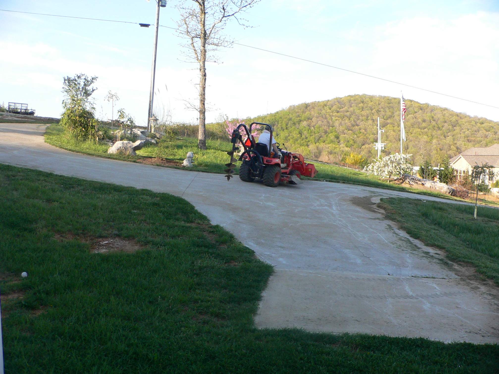

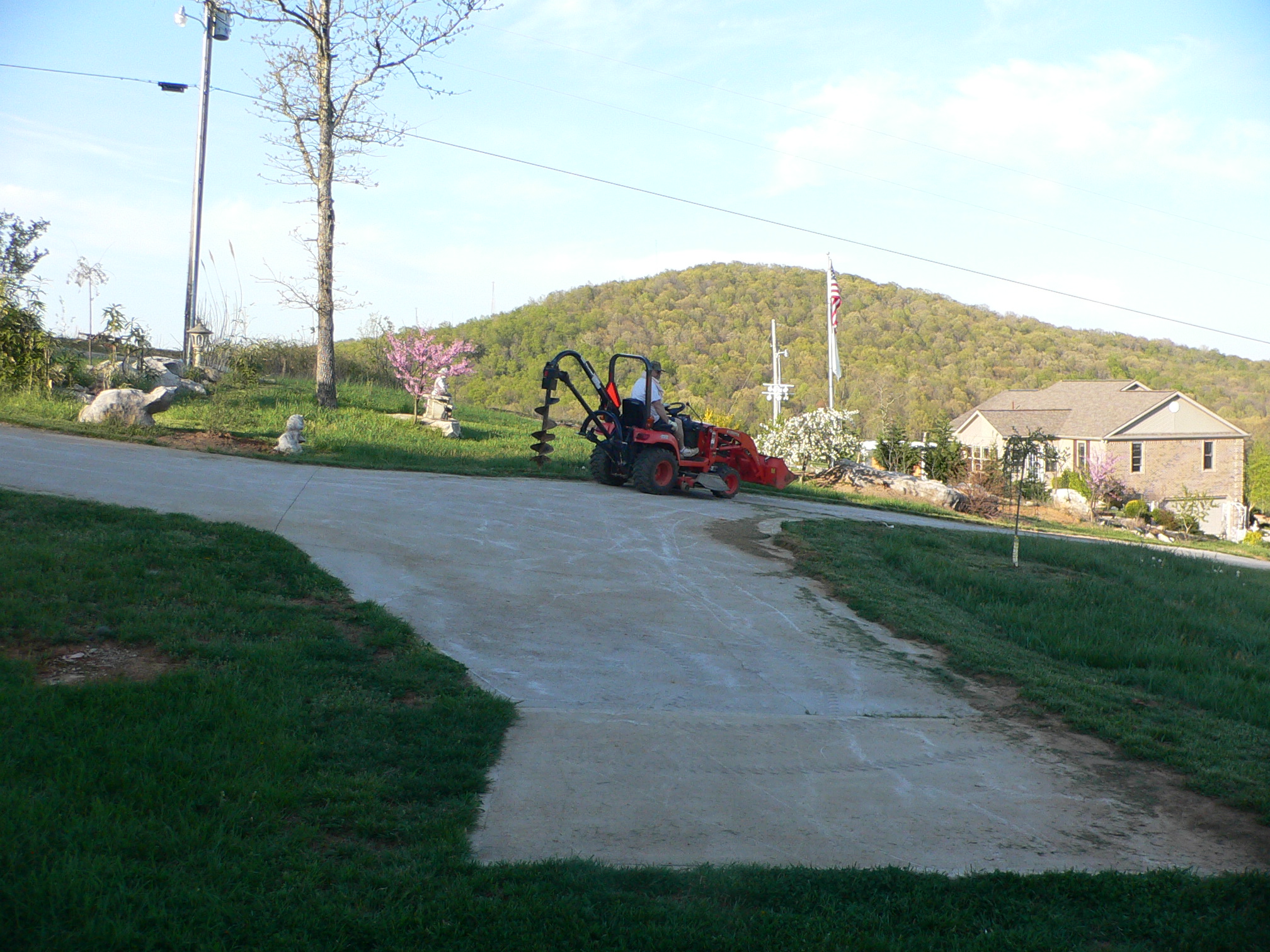

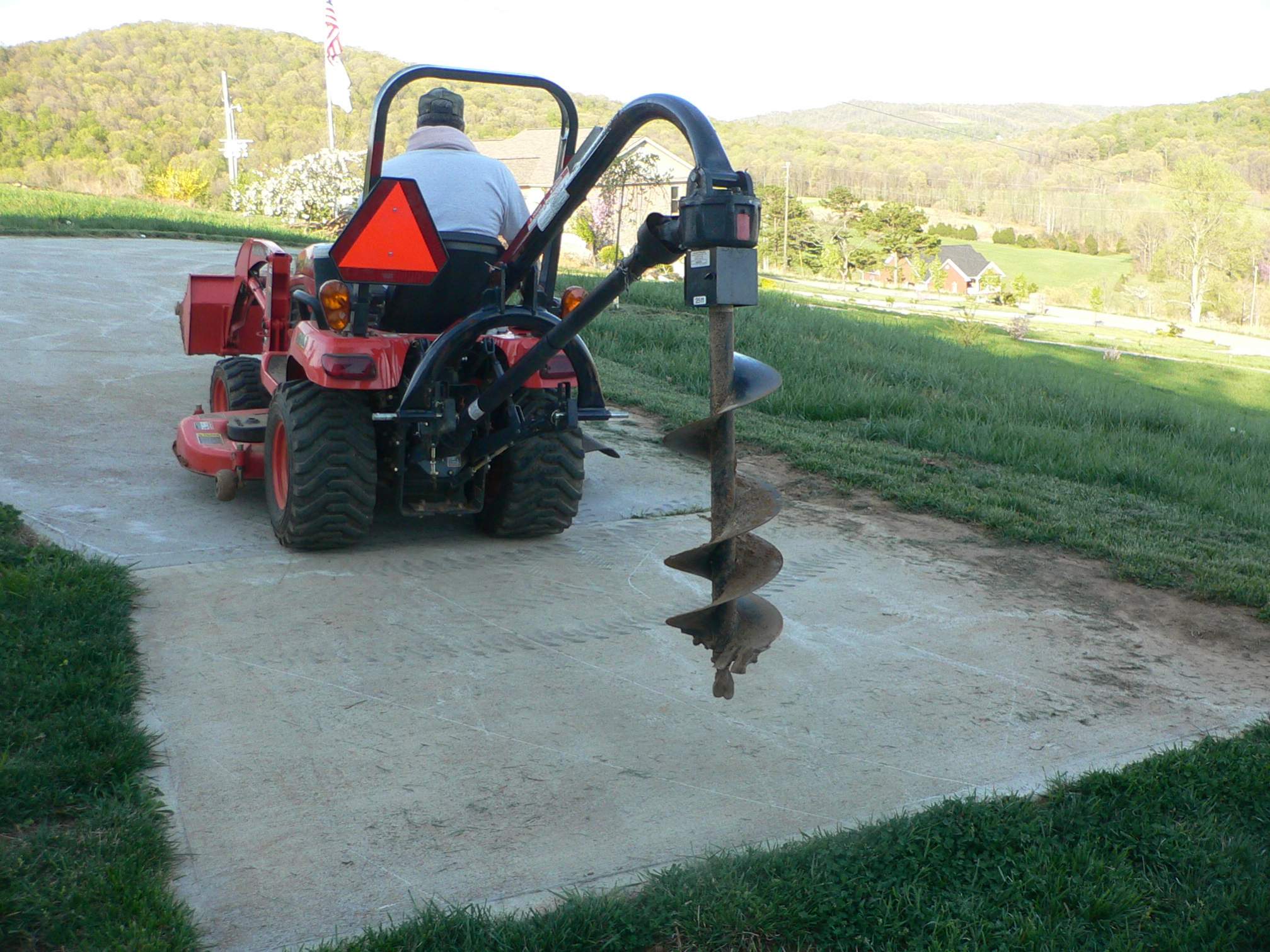

I have a Taylor Way post hole digger 12" auger that was on a B3200. Hooked it up to nephews BX2360 and drilled a few holes. It was sitting about 4"s off the ground so we installed my cheap QH's to extend it further back which raised it several more inches off the ground so I can now testify to the fact that it will work. Here's pictures for proof that are only 30 minutes old or less. One picture with it on B3200. Going down hill or on flat land should be no problem. He was going up hill so it got closer. Steep uphill may require backing up. No problem with power of tractor. Only issue is dragging ground.

John thomas- glad to see pictures of full sized PHD on the BX instead of hearsay. keep up the good work! :thumbsup:

I told my nephew that he had to stop by the house so I could get pictures that there was an ongoing discussion about the PHD fitting on a BX. I didn't think mine would and I never jumped in the conversation until I saw it with my own eyes. If I had given an opinion about mine fitting/not fitting a BX before I saw it with my own eyes, I would have been wrong. I now can testify that a Taylor Way PHD will fit on a BX2360 or one specific BX2360. I'd tell it as witnessed fact. It is still to close to the ground when traveling so I'll recommend getting one for a BX.
