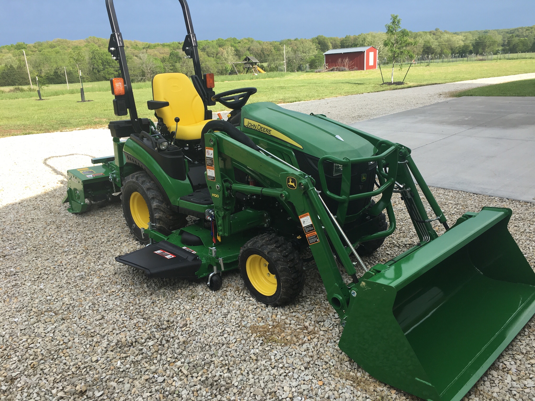

Why not just keep the X300 for mowing the lawn and get the 1025R or BX for bigger tasks? That's the setup my neighbor has and it works well for his 6 acres.
I have an X590 that I use for around the house and I plan on getting a 40-50hp CUT for mowing pastures, maintenance of my 1/3mi gravel driveway, and snow removal.
Good luck on your decision.
Thanks and yes we were thinking the same - at least this season. Depending on how the SCUT handles the mowing jobs we can either keep it or I'd sell it myself this time next year. It's only got 110 hours on it and really has been a nice machine. It's just small and doesn't have locking diff.
As for other tasks on our property and driveway I've got the 5083E Deere. The SCUT would fill the gap between those two.
   / BX2680 vs 1025R
#12
The BX '80 models are just a "refresh" really -- the core stuff has been around and has been well tested by time. I bet if we did a poll, the BX might be the top owned tractor here on TBN. Surely it's the most popular subcompact on TBN. Seems like half the posters here have one!
I don't doubt you're right! The 1025R seems popular too but I'm surprised on the "Reviews" section it doesn't seem to fair very well. Why do you think that is? Also what do you think of the brush guard? Like I said earlier, it's not just looks. It has to fold forward to accommodate the hood tipping forward. So to do that Kubota has to fixed posts on either side (like goal posts) and there's a thin metal sheet that hinges forward and snaps to the posts using clips like what you'd see on cabinets. Doesn't seem robust either. On my 5083E the brush guard tips forward but the arms pivot at the base.
   / BX2680 vs 1025R #13
I have only seen the new Kubota grill guard in pictures so I can't comment on that. Does it seem tough when all put together in place? To me, that's all that matters. I would hope the two side posts are fairly rigid.
I looked at the Deere many years ago (was 1026R then) and liked it a lot, but some of the turnoffs were the plastic hood and the fuel gauge on the gas cap. The seat was excellent though and the tractor had a smooth comfortable feel. Back then the 1-series was new and dealers were pricing them high. I ended up realizing the Kubota B series was just a little more money and went with a B2920 instead. Never even sat on a BX that time.
   / BX2680 vs 1025R #14
If you had the X300, 1025R, and 5083E you'd have the perfect Deere tri-fecta. The only problem then is you'd have no excuse to buy more tractors, but maybe you could get creative and come up with something.
   / BX2680 vs 1025R #15
Up until today I was sold on the 1025R and was about to pull the trigger but we happened to be driving by the Kubota dealer and I stopped and noticed they had a BX2680. Both my wife and I drove it and liked it.
PS no I'm only interested in Deere or Kubota thanks.
But up until 1 day ago you were only interested in JD. LOL
So I won't tell you why from 2006 till early 2015 I planned to by a Kubota BX and ended up with a Massey GC1715 instead :)
   / BX2680 vs 1025R
#16
The grill guard is so-so IHMO. The angled side pieces are quite stout and would deflect quite a bit of force. The metal in between though is flimsy and clips to the side supports with pressure clips similar to what's on some cabinet doors.
Yes a B series or JD 2 series would be nice too, but I figure what I can't do with a BX I've got my 5083E for backup.
   / BX2680 vs 1025R
#17
Guilty as charged. I know tractors come in all kids of flavors but where I live Deere and Kubota are the most convenient dealers and I like them both.
   / BX2680 vs 1025R
#18
So an interesting thing happened today. The salesman at Deere texted me this morning to let me know that in all of their stores (this place has like 7 stores scattered across southern MO) they only had ONE 1025R with loader and mower left and he didn't know when he would get more in. He said he has a lot of 1025Rs that have BH but I'm not really interested in that as I mentioned above. I trust this salesman and know him personally. He said he would hold the remaining 1025R (which is not at my local store - it's 45 min away) if he could until I can drive it this Saturday. I wonder if Deere is phasing out 1025Rs for a new model? Or they're just popular and not keeping up with demand?
One more thing: something I've considered to make myself feel better about not getting a BH is if I get the BX2680 is I could get a third party BH like a woods or wood max. I've read several posts on here where people have done that or installed later the factory BH on a 1025R or even just traded in for a FILB. I think a third party BH seems reasonable compared to the latter two options if I ever change my mind about getting a BH. Does that make sense?
   / BX2680 vs 1025R #19
I've tried 4 out of 5 tractors I've owned to get Deere to pony up. Last time, they supposedly "had a bounty out on orange" I was told. Yep! Better this time... only $3200 more than my Kubota. Here in N. Illinois, they just don't deal. I was so set on a 1025R I could taste it before I bought my current BX2670. Frankly, though, so much of the Deere seemed cheap to me. Not preschool toy cheap.... more like thinner, smaller, less robust than the Bota. Maybe it was me. I liked the QD deck on the green one, the loader control position, etc, but frankly, mountains will need to move before I see the 1025R have any leg up on the new BX 80 Series. Orange went for blood with the loader on/off this time. The Green MMM might be a bit easier, but it's a marginal bump because of Botas ramps. That detail means squat to me because I take them off 100% until I need them, and I think the Orange deck is more robust.
Drive them both. It's your sweat that's earned it. Only you need to be happy. I agree with the pooky do grille guard of the 80-Series, but I like that it stays with the tractor. I don't think it does with the Green... it goes with the loader. The valves on the Green are not regenerative, so you need to stop raising to curl or dump. Botas you do not. Try curling into a pile of mulch sometime without it. You'll see what I mean. Sorry, that would break it for me.
