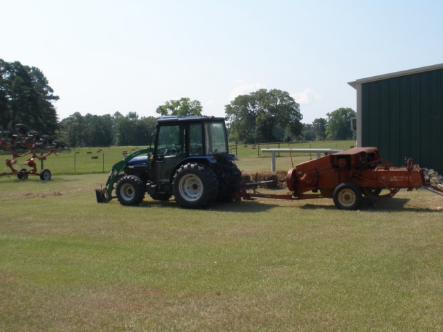

First the tractor complete with baler attached.

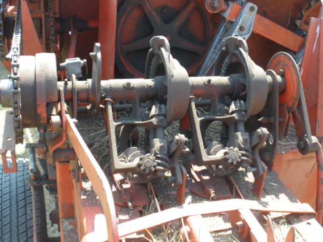

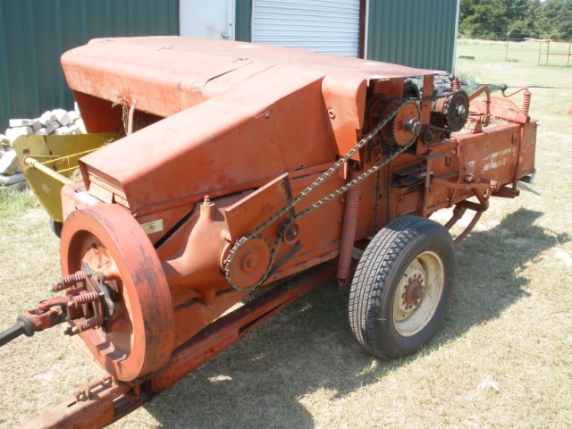

Since this is afterall a tractor site then the next is the baler. For those who don't get out much a close up of the knotter. It a pretty complicated piece of engineering and a pain in the butt to get working right.

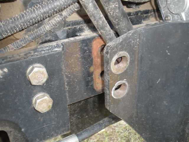

Next a picture of the loader with the broken bolts. A closer look and you'll see the problem. The space between the engine block and the loader frame is one inch. This space is filled by the two half inch plates in the picture.

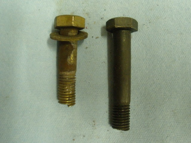

The picture with the bolts shows the broken grade 10.9 bolt on the left. It was originally 75 mm long. The replacement on the right is the only thing I could get which was originally 90 mm but I've cut it down to 75 mm.

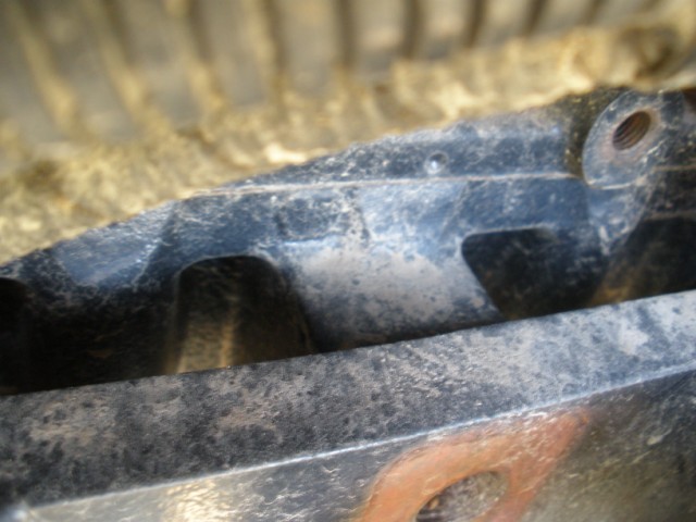

If you look at the engine block photo you'll see the difficulty on this one. I'm afraid I'll have to remove the loader frame. That will definitely be no picnic. Arghhhhh.
