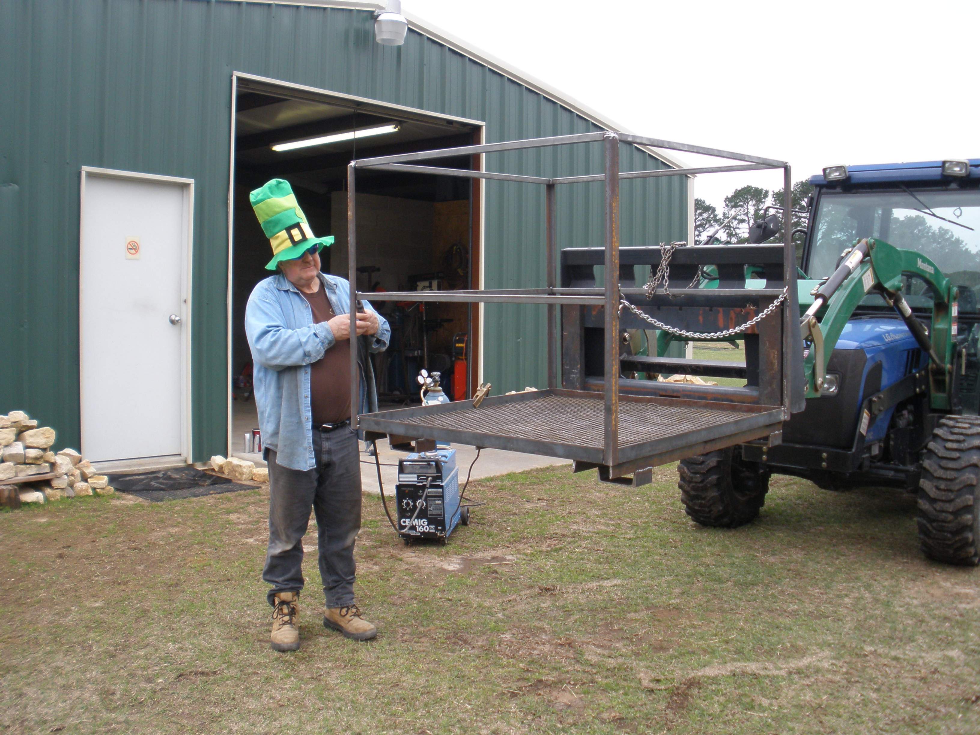

I've uploaded a picture of me with my new welding helmet and if you look closely to the right you will see my blue mig machine in blue. You can also guess what time of year the picture was taken.:D:D
It's made in Italy and works great.
Now don't get me wrong here, there is nothing I would like better than a nice Miller mig machine but at the time this one was a great price. "Yorkiepap" on another site has the same mig he uses for aluminum as well he has a number of Miller Mig and DC/AC machines as well. He also designed a great chopsaw stand which I copied (see photo). It has proved incredibly handy for doing pipe fence. I also cut the material I used in the manlift with it.:thumbsup:
What I am really looking for is a Miller gas powered welder like a Bobcat at a price I can afford. This will allow me to work on the rest of my pipe fence projects.

Hey Glenn love the hat :D Jeeze anyone who stick welds should have one of those that way they would have a place to store there rods while welding :laughing:
That's a nice looking welding outfit. It don't Matter if miller is on it as long as it gets the job done. You did an exceptional job on that stand and the lift for the tractor sir. Very nice indeed. You do nice work. If your not proud you should be.That won't break to soon for sure.

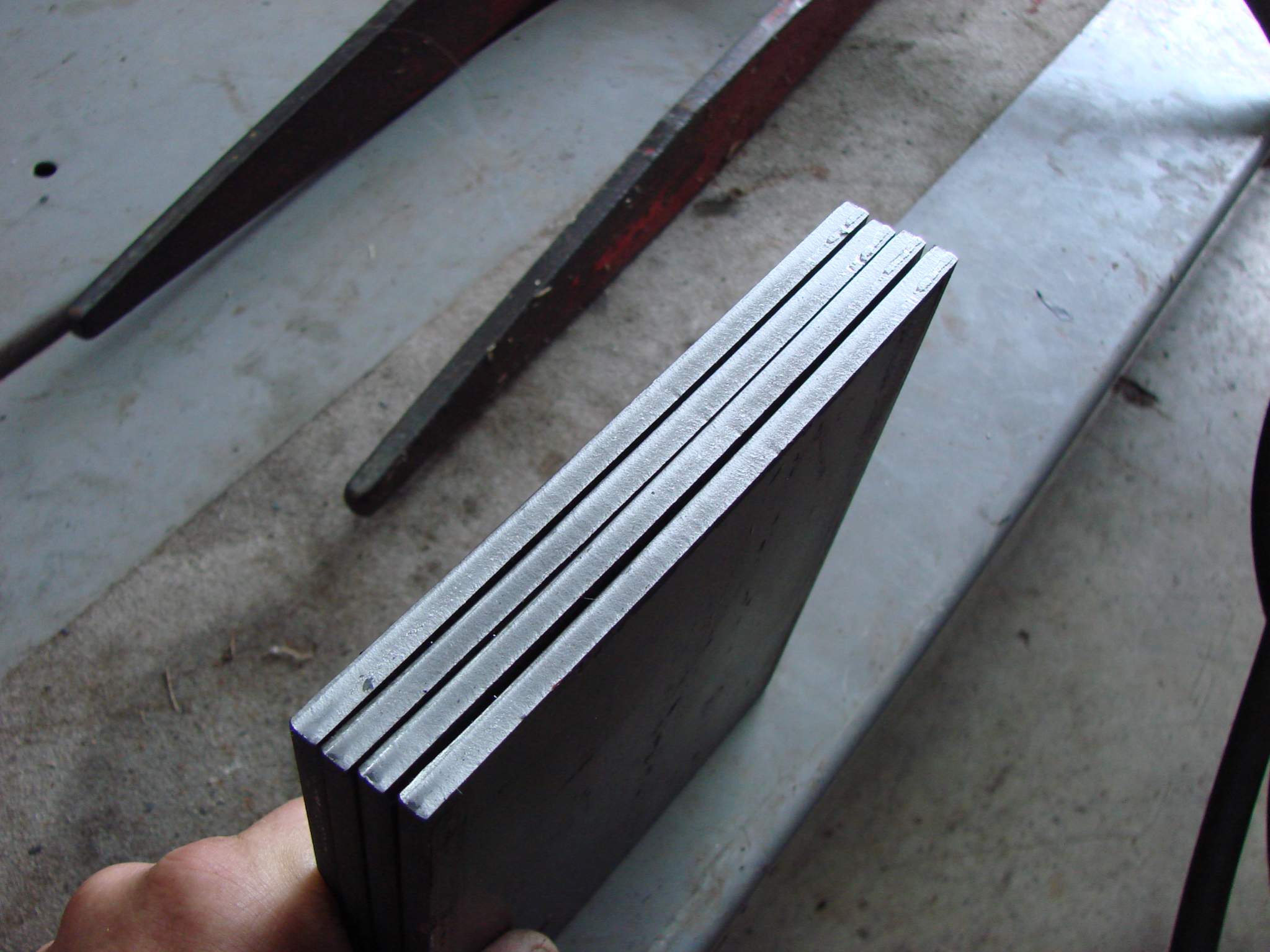

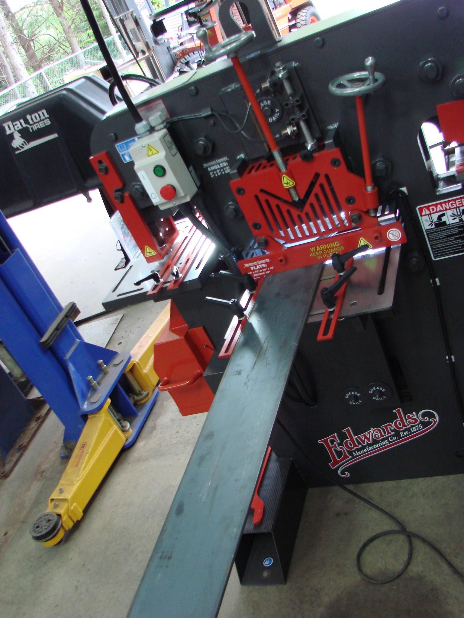

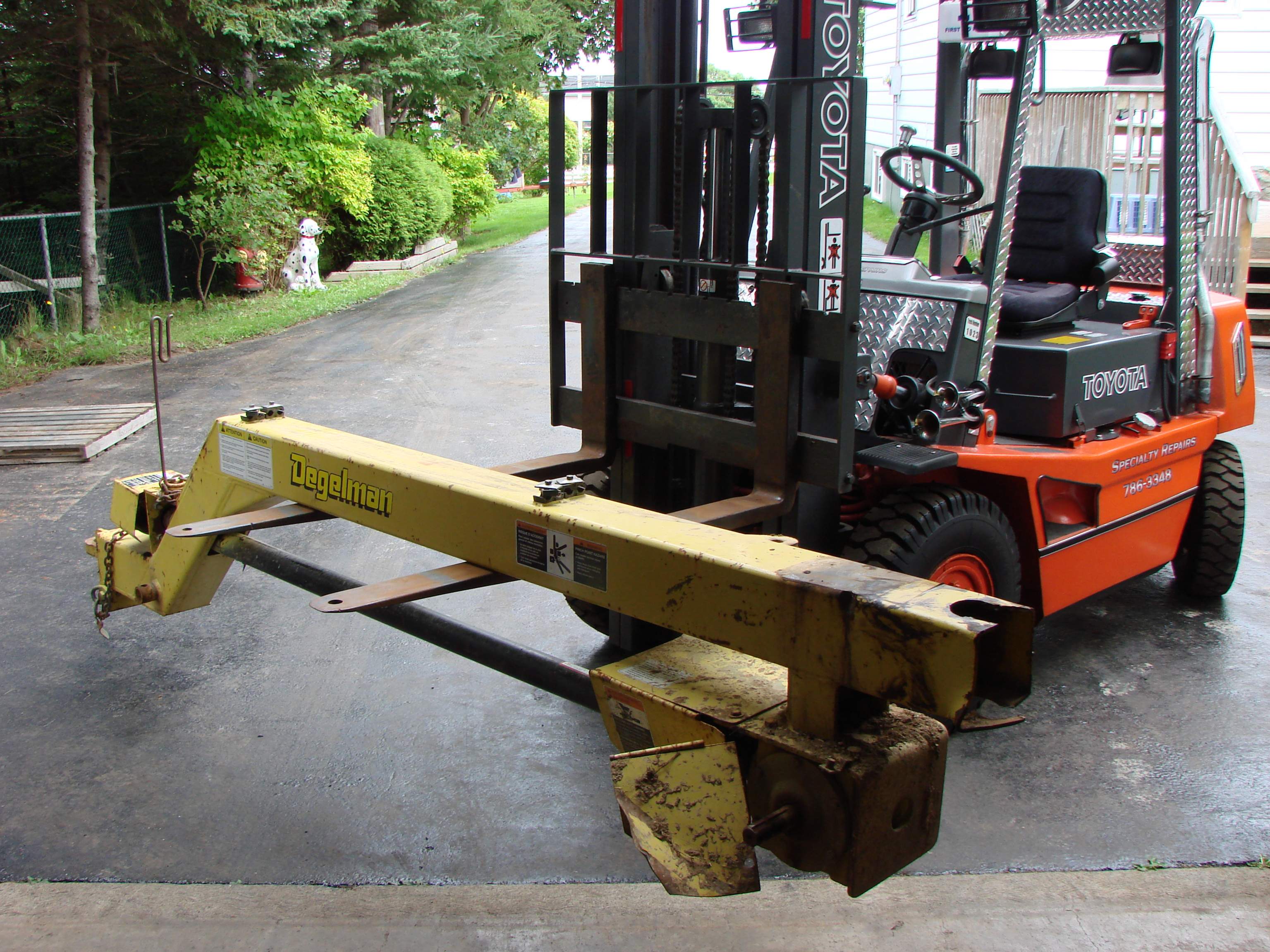

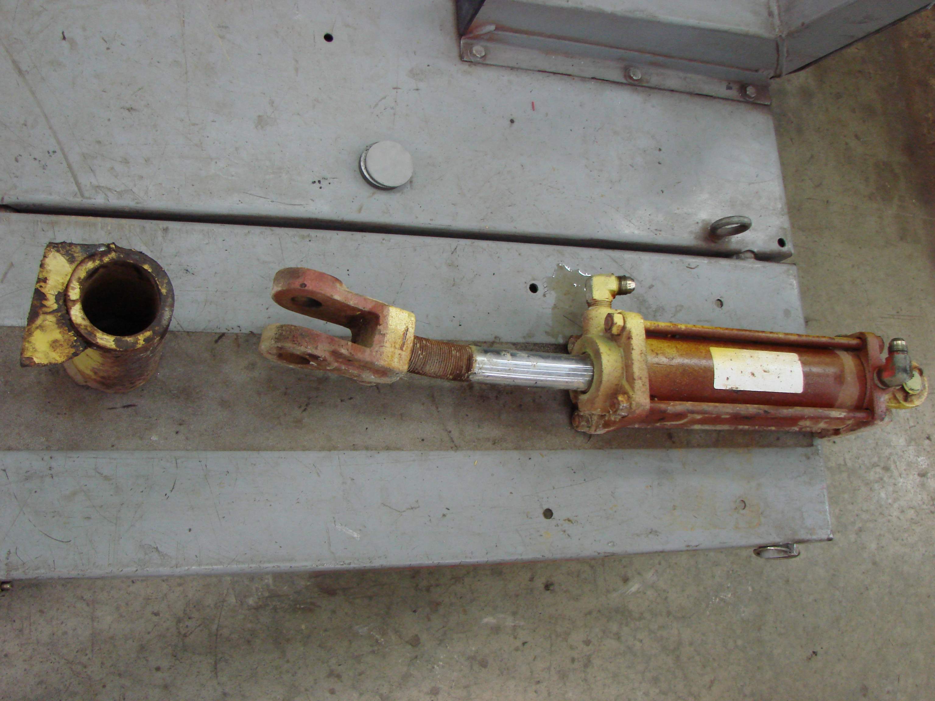

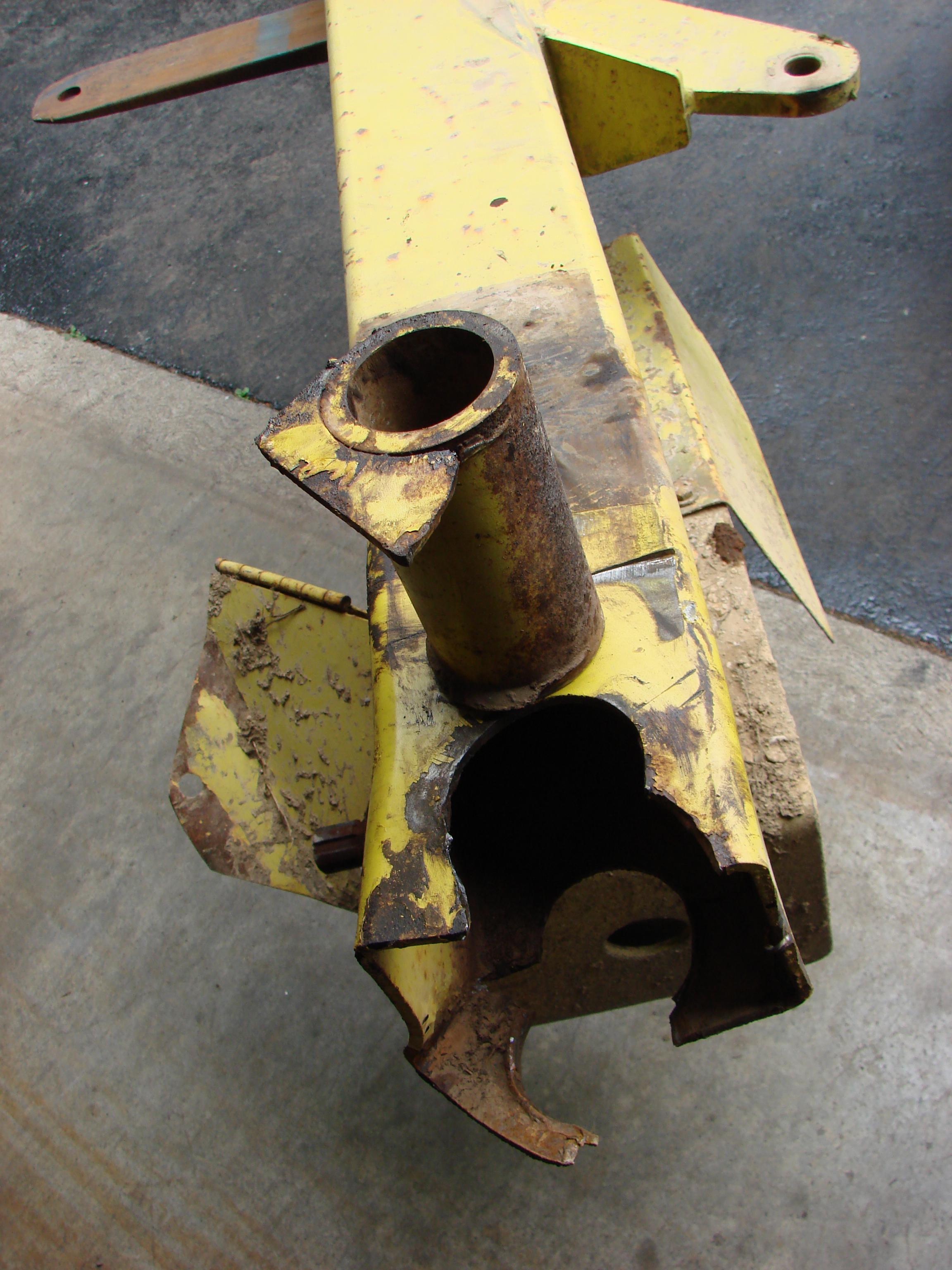

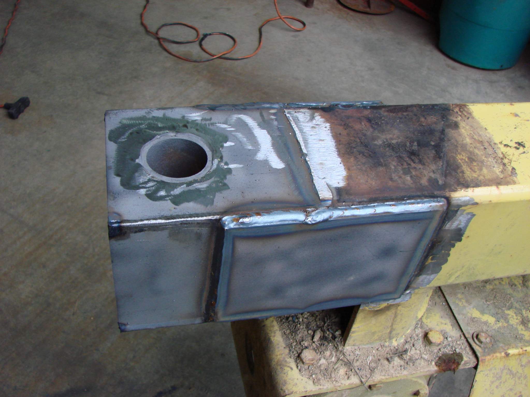

Just as I returned yesterday a local farm dropped off this unit that needed to be done ASAP. I couldn't get any 6" square tubing so I plated it. They also bent the cylinder so I had to do that as well. It made for a very late night BUT I got it done. Hard to believe that a big unit such as that would swing from just on 4" pin on the end. I say it was designed to break off.

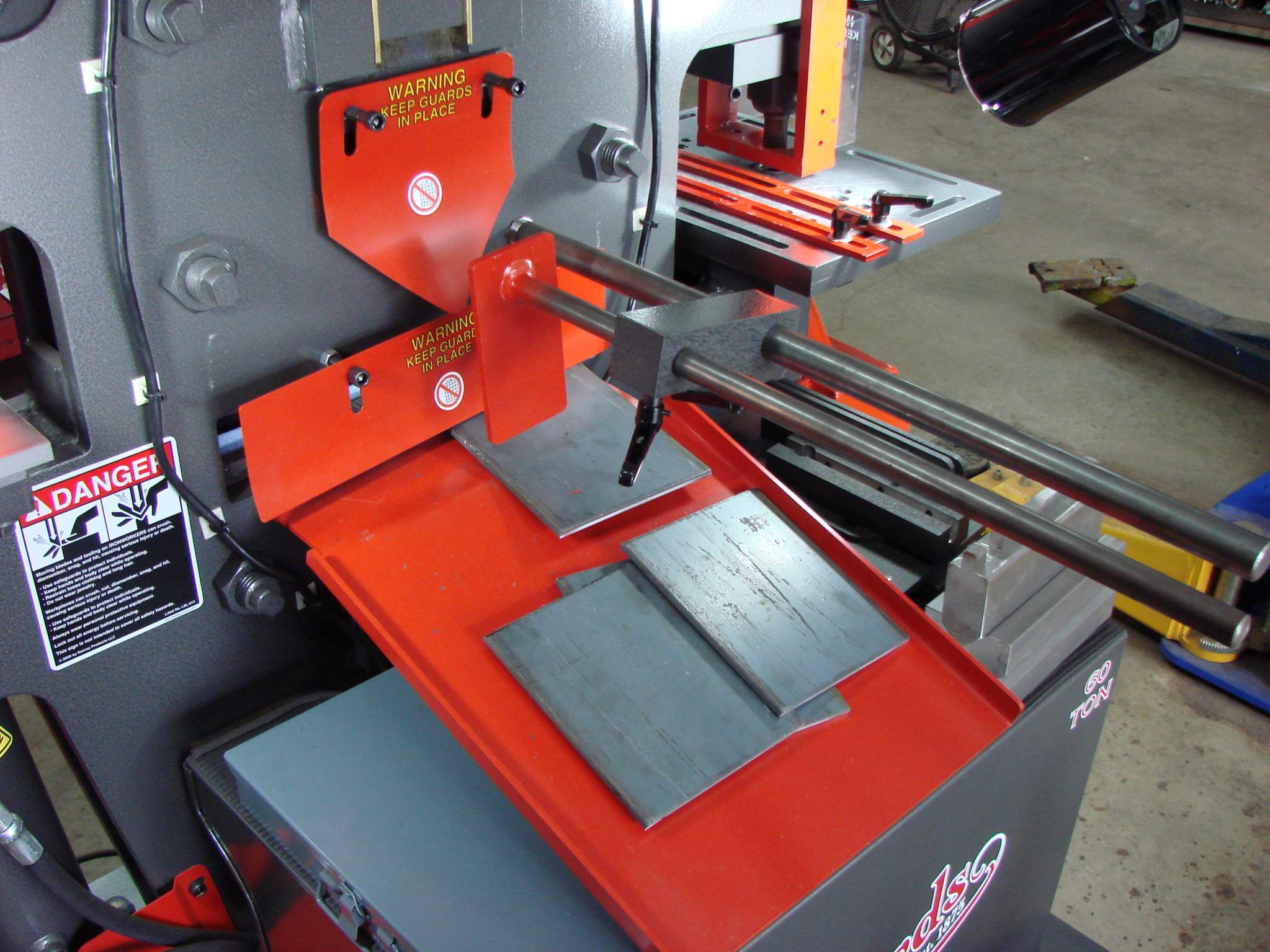

Anyway to keep the bordom going here for those who might like to see some more pics I'll post more of the job I just completed. tools used are as listed.
- Ironworker :D
-Lathe
-Millermatic 252 with 75/25 gas mix with .035 wire
-Miller Spectrum 875 plasma
- Shop press

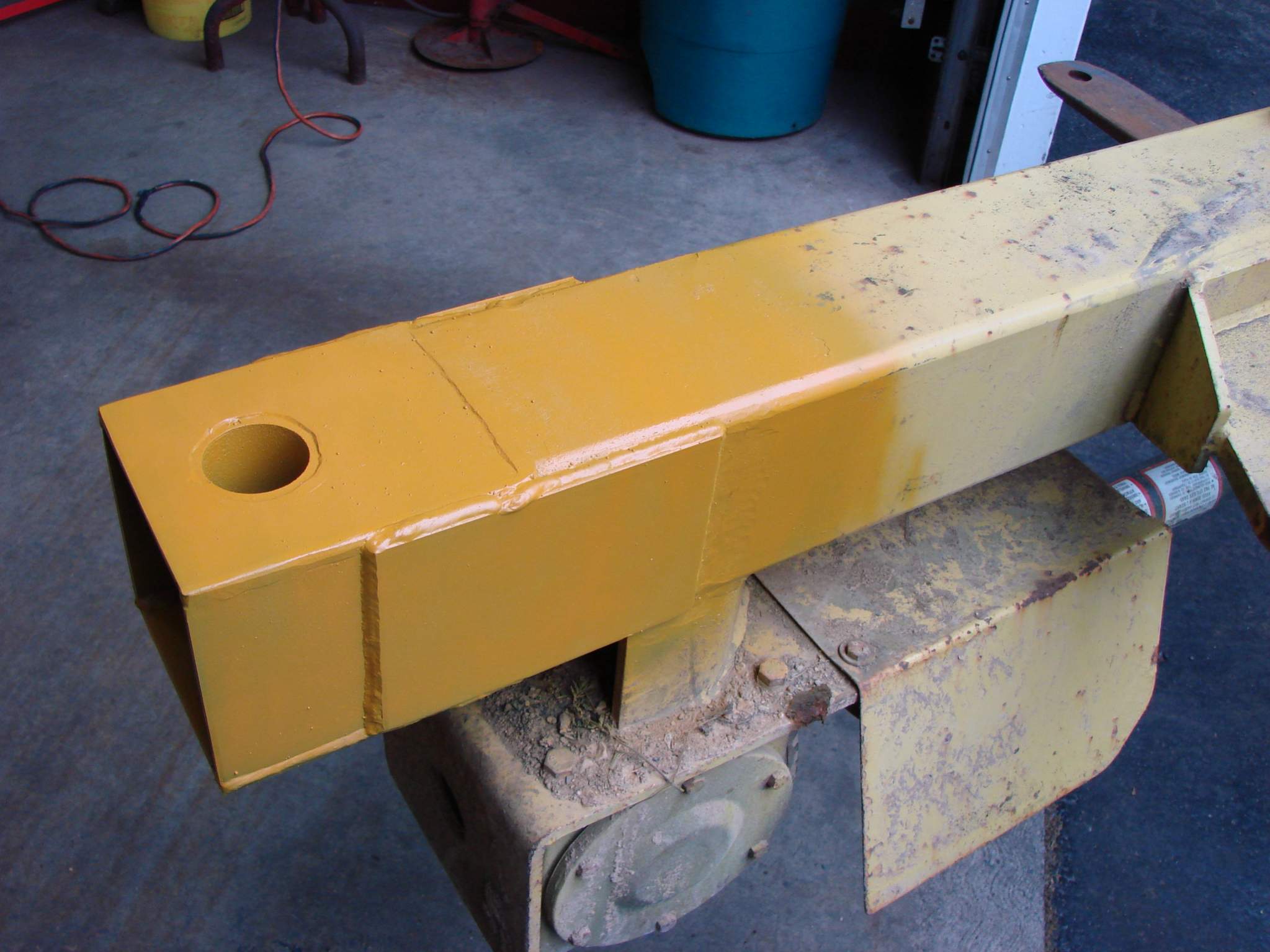

Completed pics.

Nice looking repair Paul. That tube looks like it's only about 1/4" thick. I'm kind of suprised that the manufacturer didn't use something thicker. I have to agree that it looks like it's designed to break. Just doesn't seem strong enough for the long haul.
OK, time for a learning question here. Since you had to use plate to rebuild the end of it for the pin sleeve, what is the reason for not using thicker plate for the top and bottom where the sleeve attaches?

Thanks Cyril. I'll try and answer you on this IPhone.It's going to take some to get used to this new phone:) I went with the 1/4 plate because that's what was already there and everything else on the boom was that size. I think the problem occurred when the pin came loose and tore away from the unit. The pin was only welded in a few places but when I did it I welded on the inside all the way around as well so it should be much stronger than before.

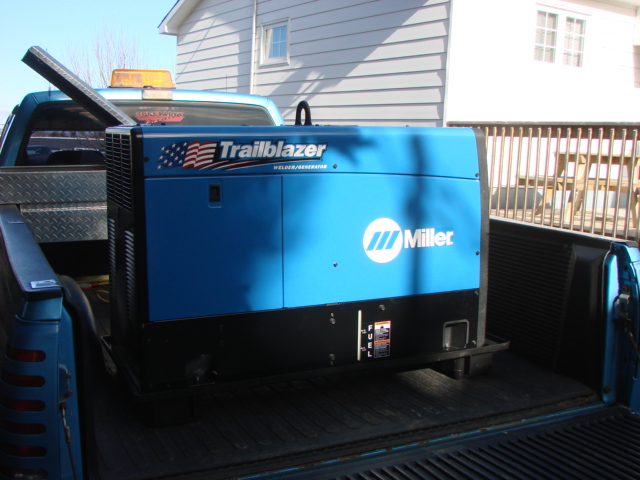

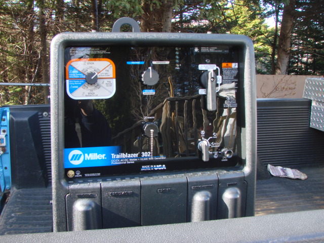

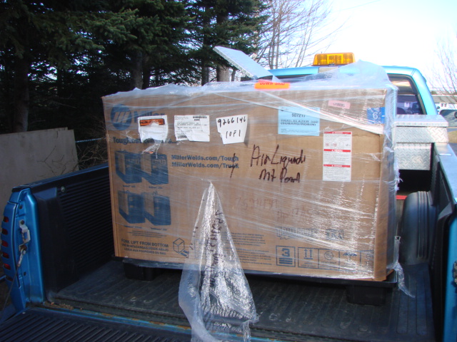

Anyway now I can add a few pics for Glenn. When I went out looking for a mobile welding machine I looked at the bobcat. They are a great machine but I decided to go with the Miller Trailblazer. It's got twin generators in it plus I ordered it with the AC/DC. you can buy them just DC. These Trailblazers are know for there pipe work. I'm very pleased with the one we have.

Nice looking repair, and that ironworker makes clean shear cuts to boot.
