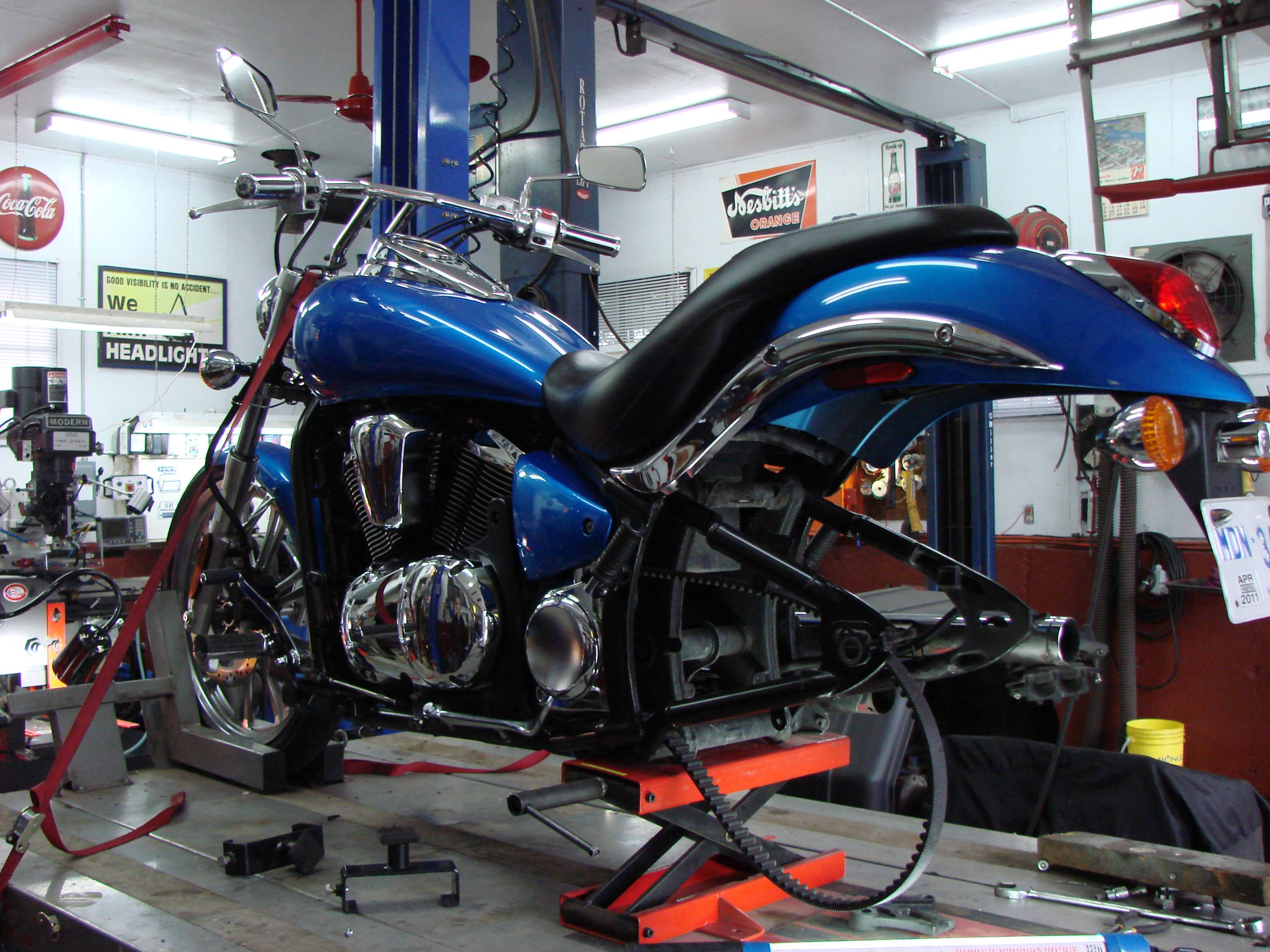

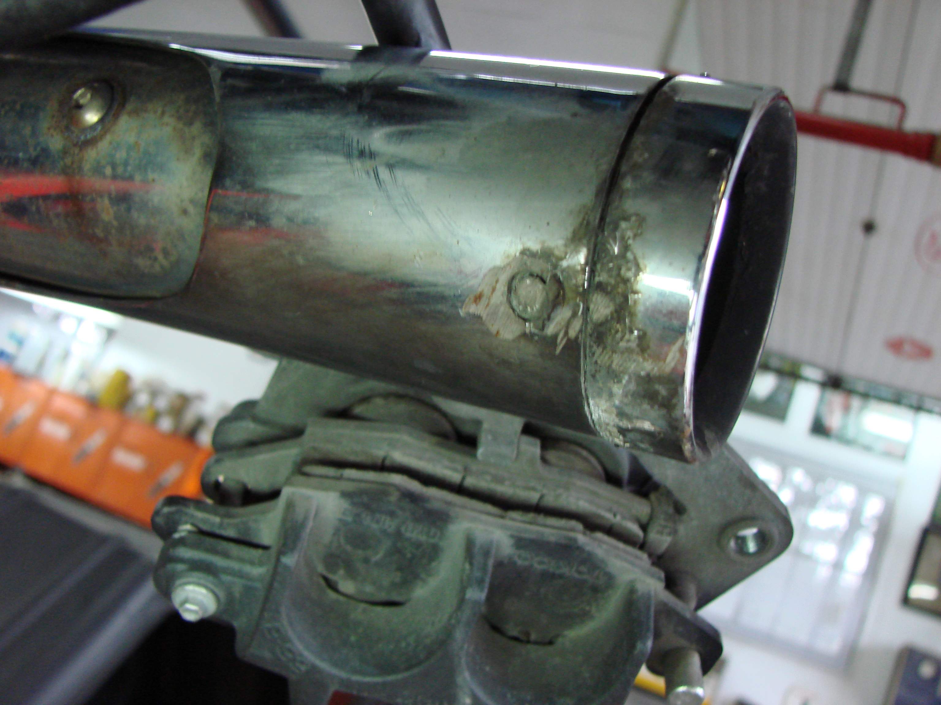

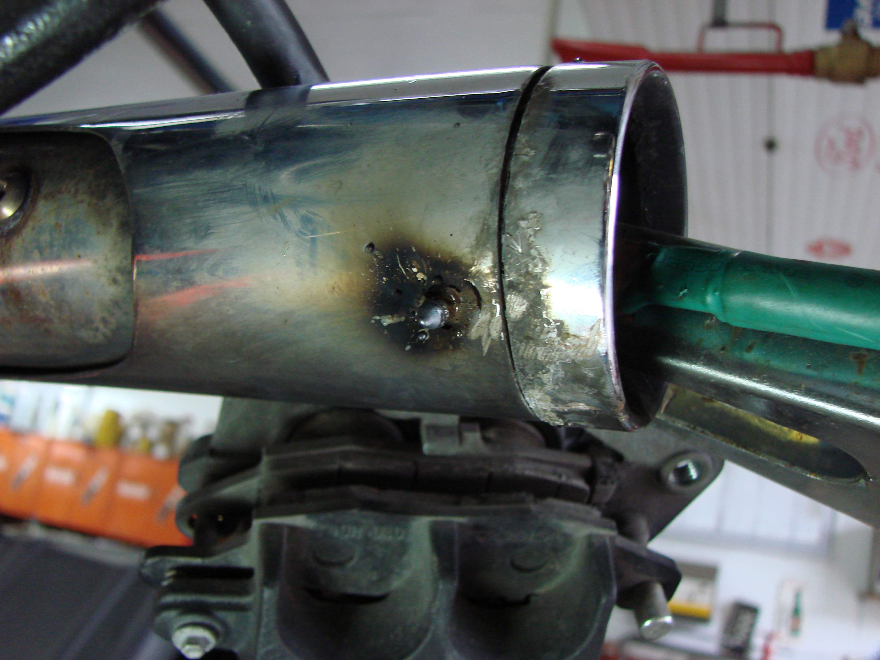

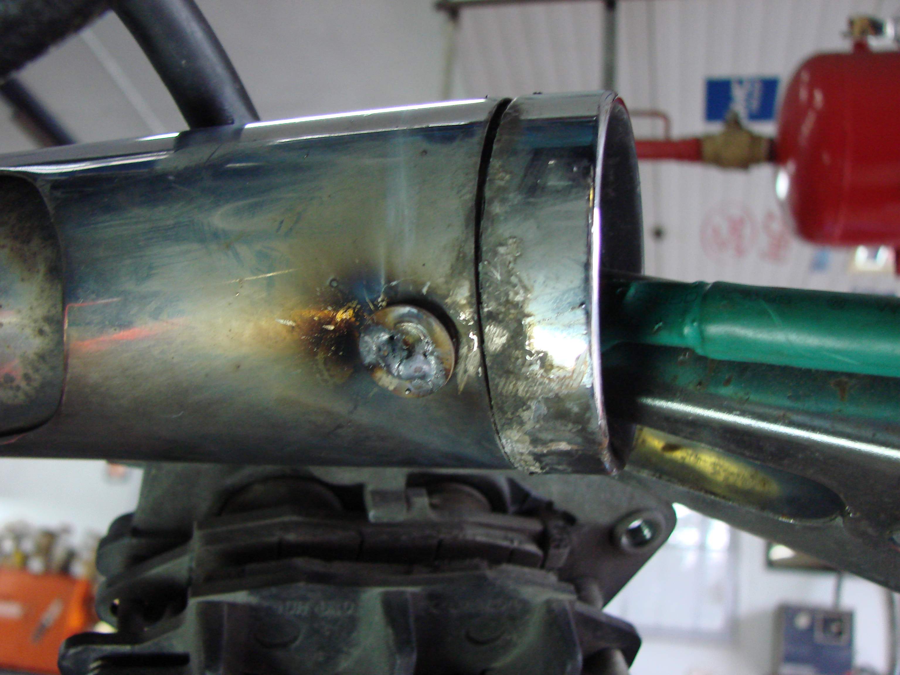

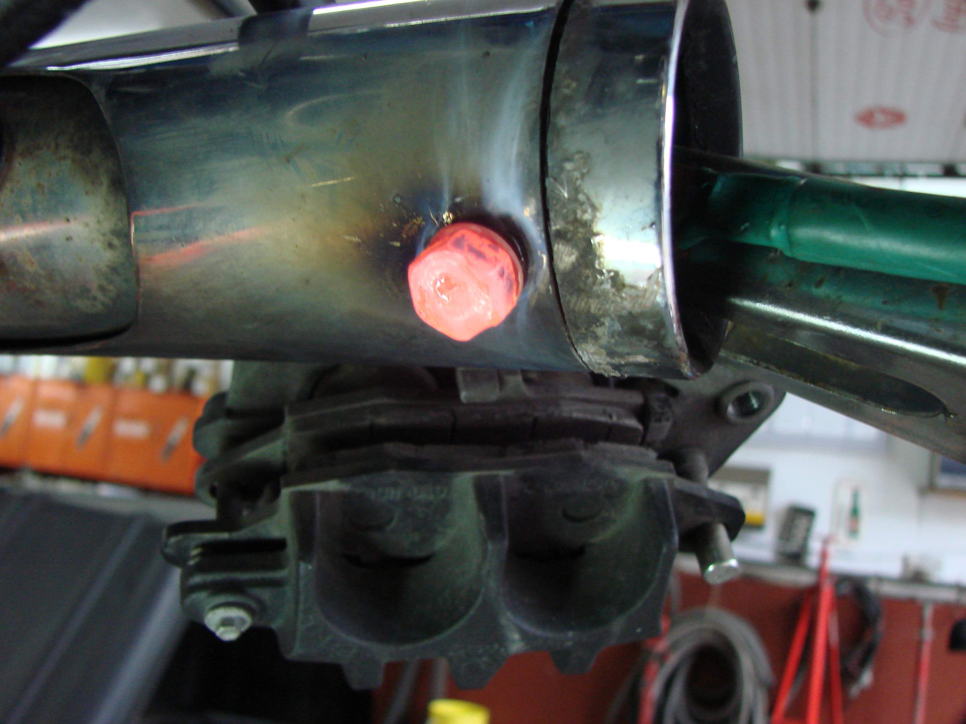

Nice equipment there buddy. Some of it looks complicated. glad you liked the washer/nut/welding trick. just today I needed to use it on a bike i had in the shop. I owner attempted to remove the baffle in the muffler and cracked off the bolt. he then tried to pick at it to get it out and didn't so I used my old method.
This was a small 1/4" bolt so it was a little tricky. I first added some meat to the bolt with a few shots of the mig. Then welded the washer and then the nut. Still had a little trouble getting it out BUT I did :D
I thought I'd take a few pics to show my TBN friends. Here ya go.

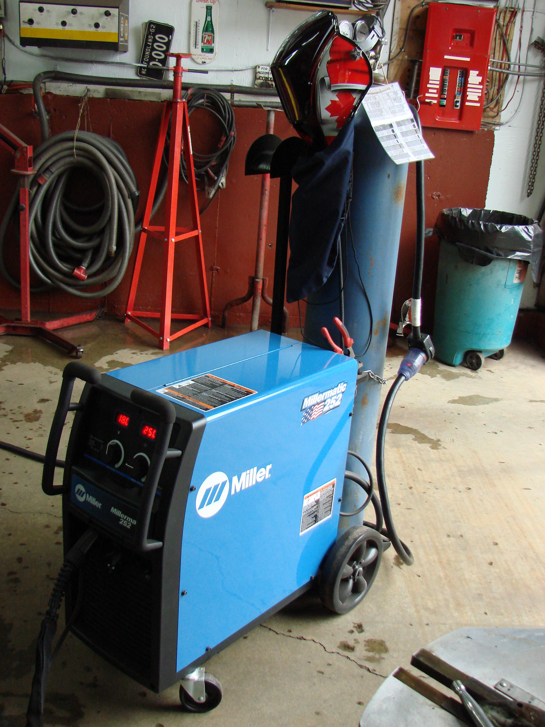

I guess it's OK to leave it as it is so long it don't cause the other "good" bolts to shear off. After all it's only as strong as it's weakest link.
Show us your welder. Blue without "Miller" on it :confused2: Man we're having a great long weekend over here. Put 400 miles on the bike yesterday. Hot, sunny and lots to see. Time to head out again. Have a great day everyone. :thumbsup:
