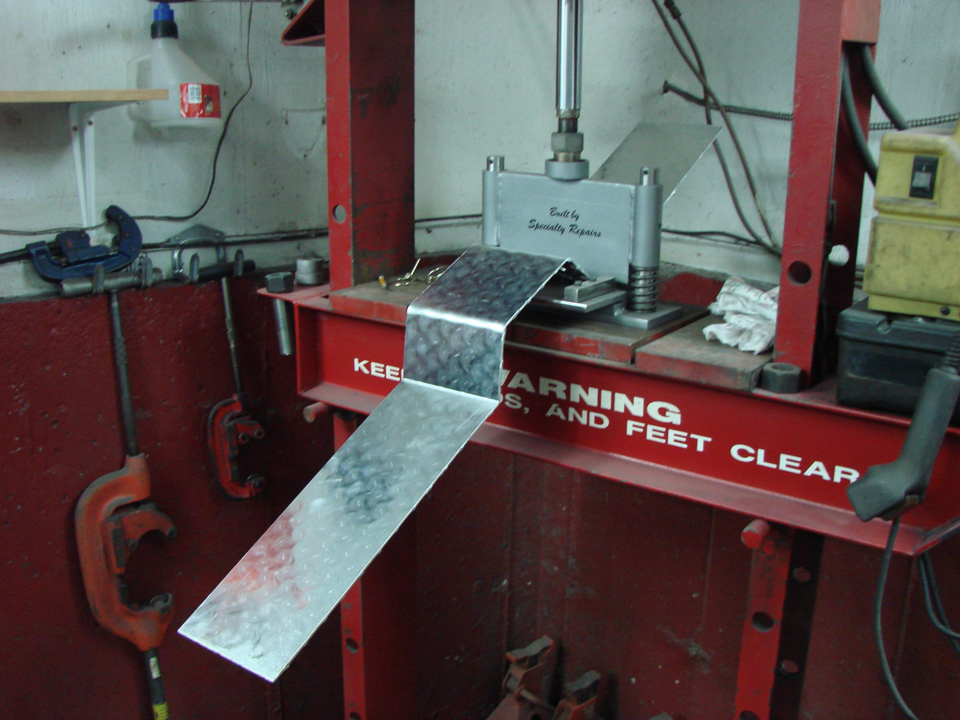

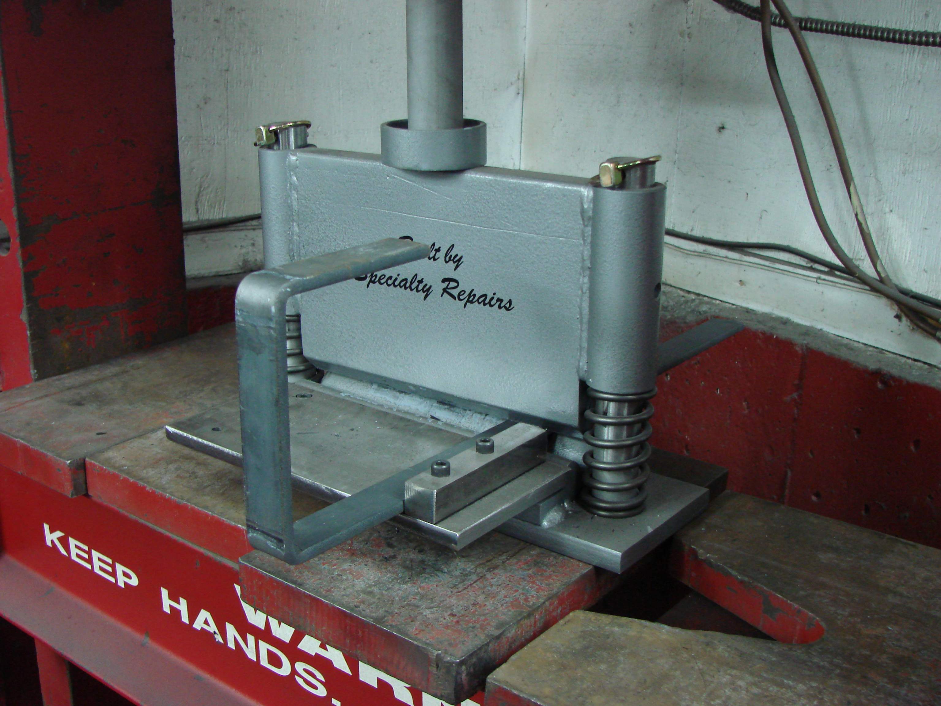

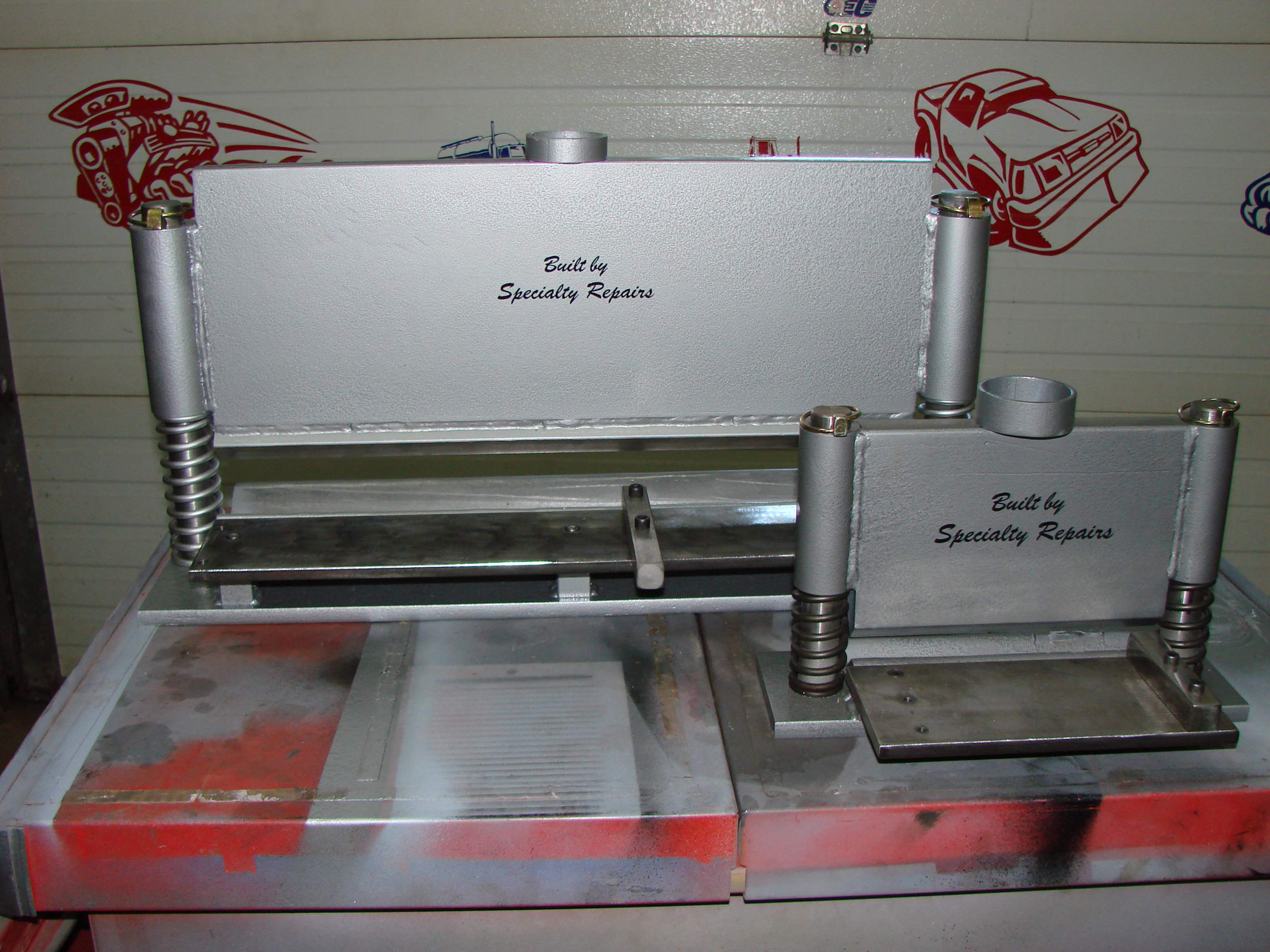

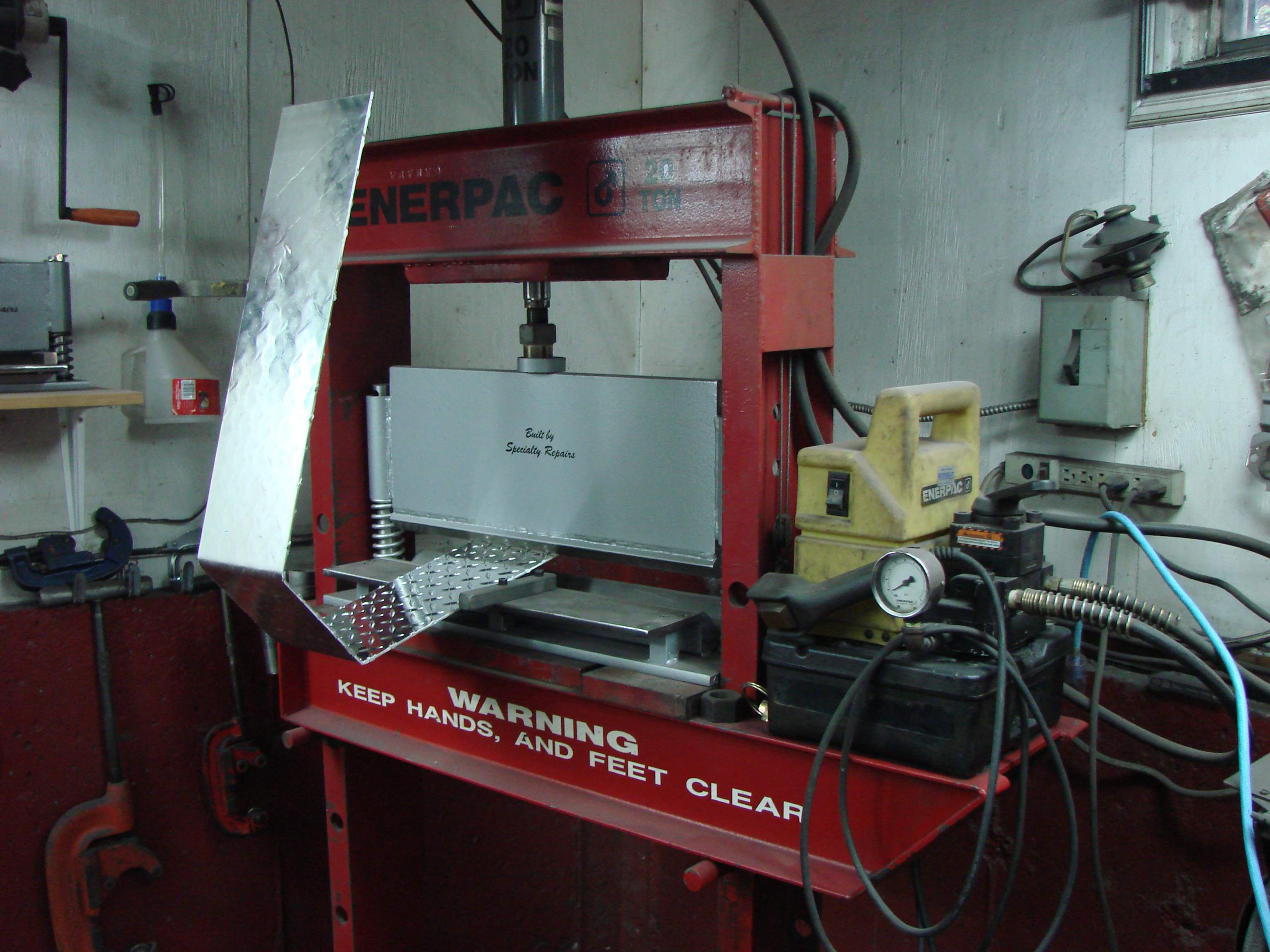

Paul, I was curious you have two sizes of press brakes 9" and a 30" aprox. Did you build the small one first, then go large? I wanted to buy a 30" from Harbor Freight and use for all small and large. I don't have the time/skill /patience to build my own now. But it looks like a handy tool for my 40 ton press. I guess my question is why did you build a small one if the large one will work for small pieces? Thanks Mark

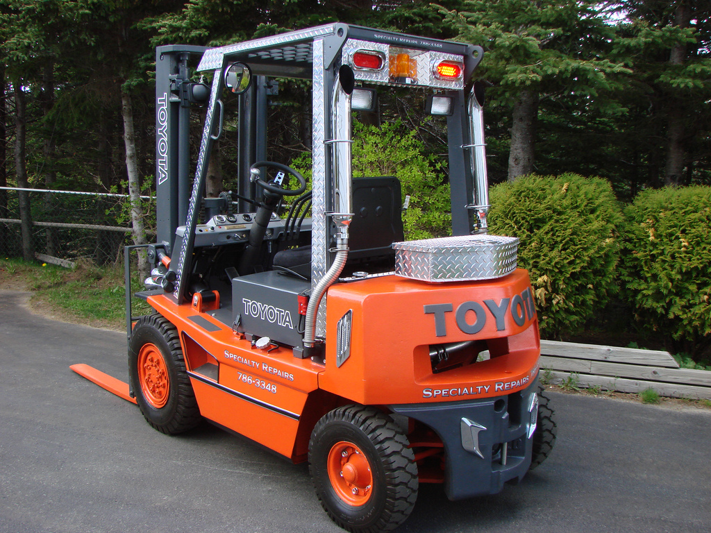

Mark I built two brakes because the larger brake is heavy and hard to lift up to the press. The small break is better for the smaller items such as handles and the like. You could get by with just the larger brake for all the bends but having the two sizes works really good.
As you might know by now I built them to make the bends in my checkered plate when I was restoring my old forklift (see attached photo) but there used basically all the time now for everything else.
