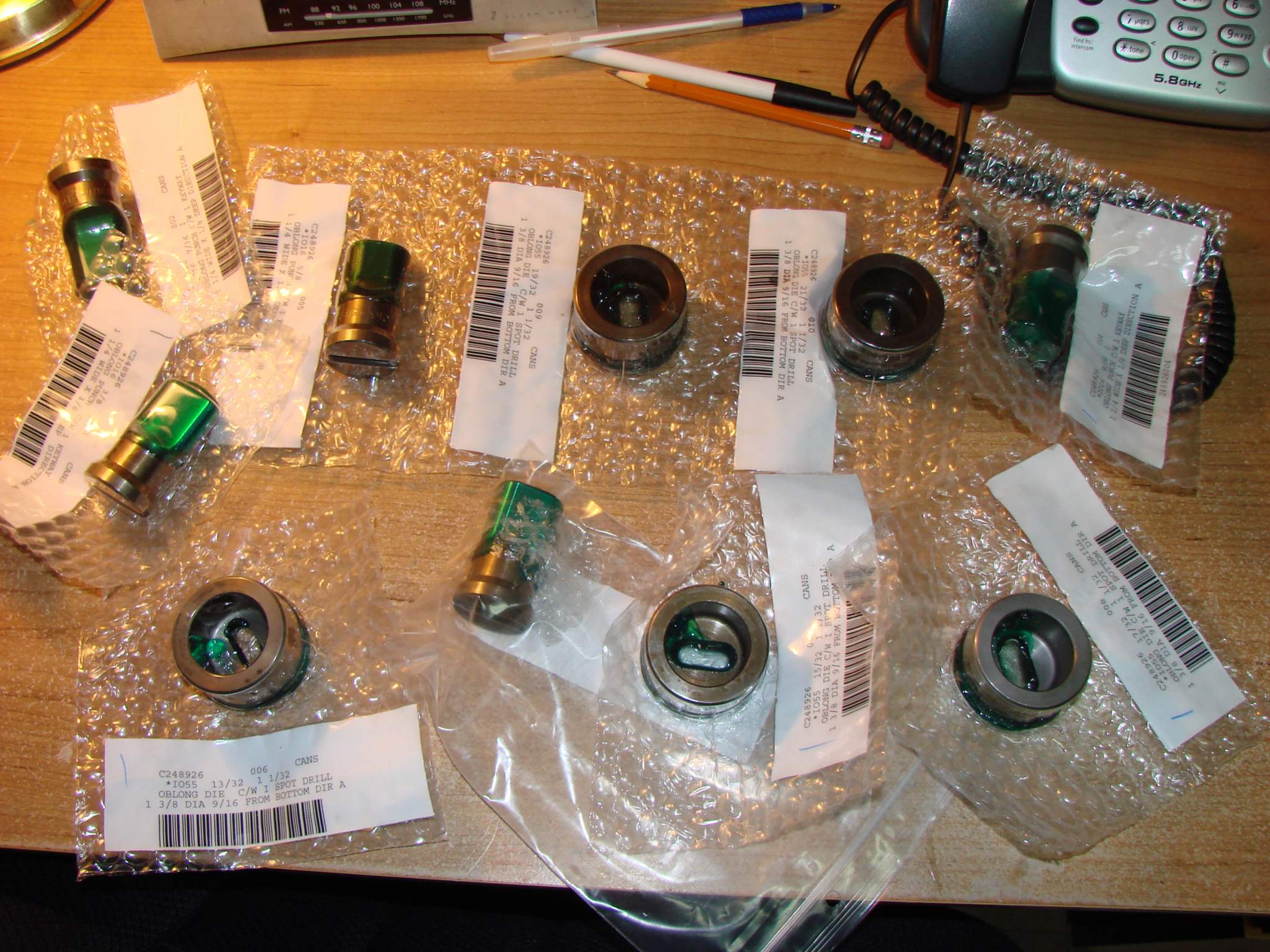

Oh ya. They will be nice to have. They showed up today. 5 punches and 5 dies and a little over $620.00 :shocked: but they'll come in handy

The oblongs showed up today. Not cheap but built very well. A Ironworker is much like a lathe and a mill in the sense that the machine is the cheapest part of the deal. The tooling is where they get you :mad:

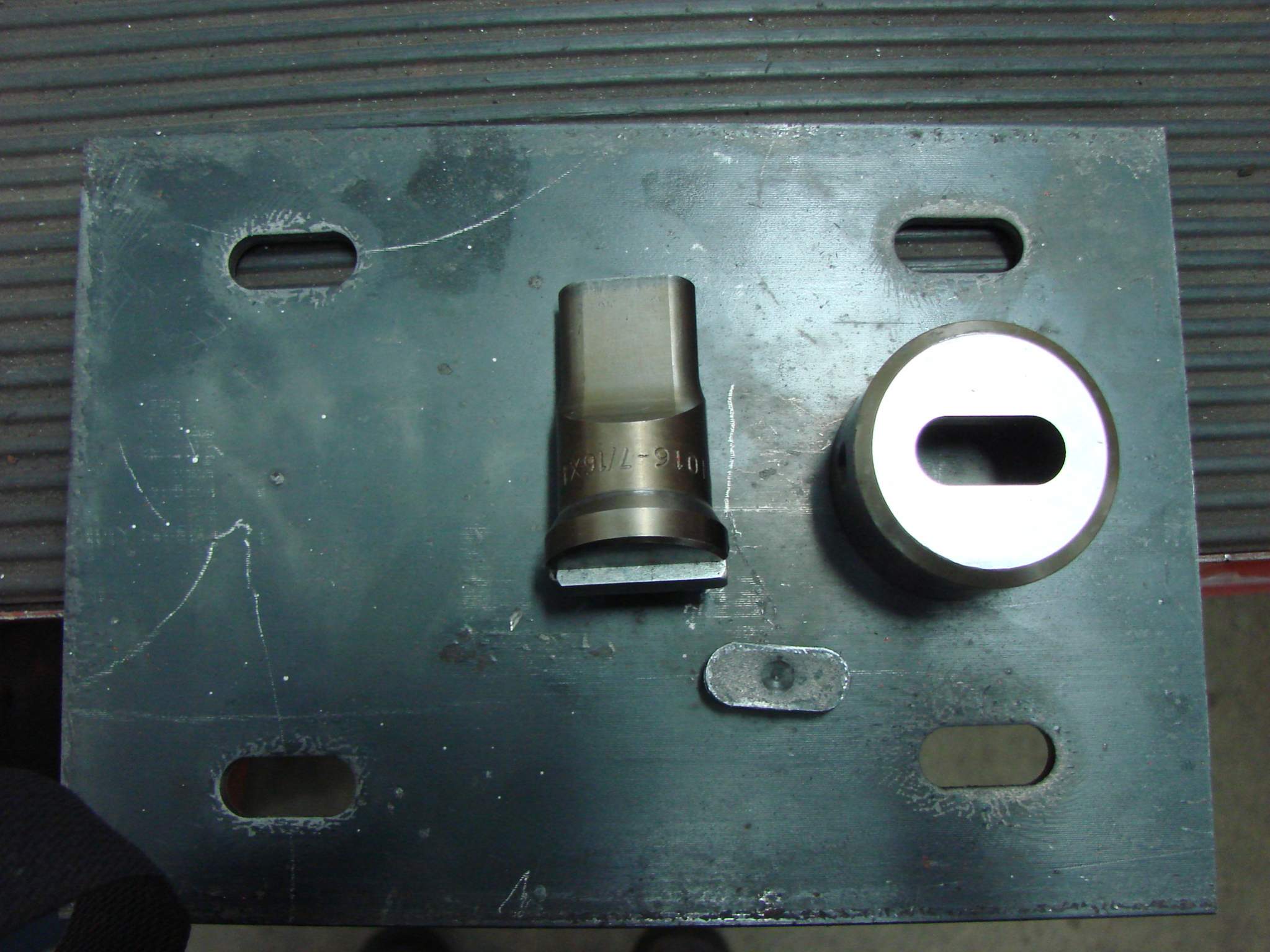

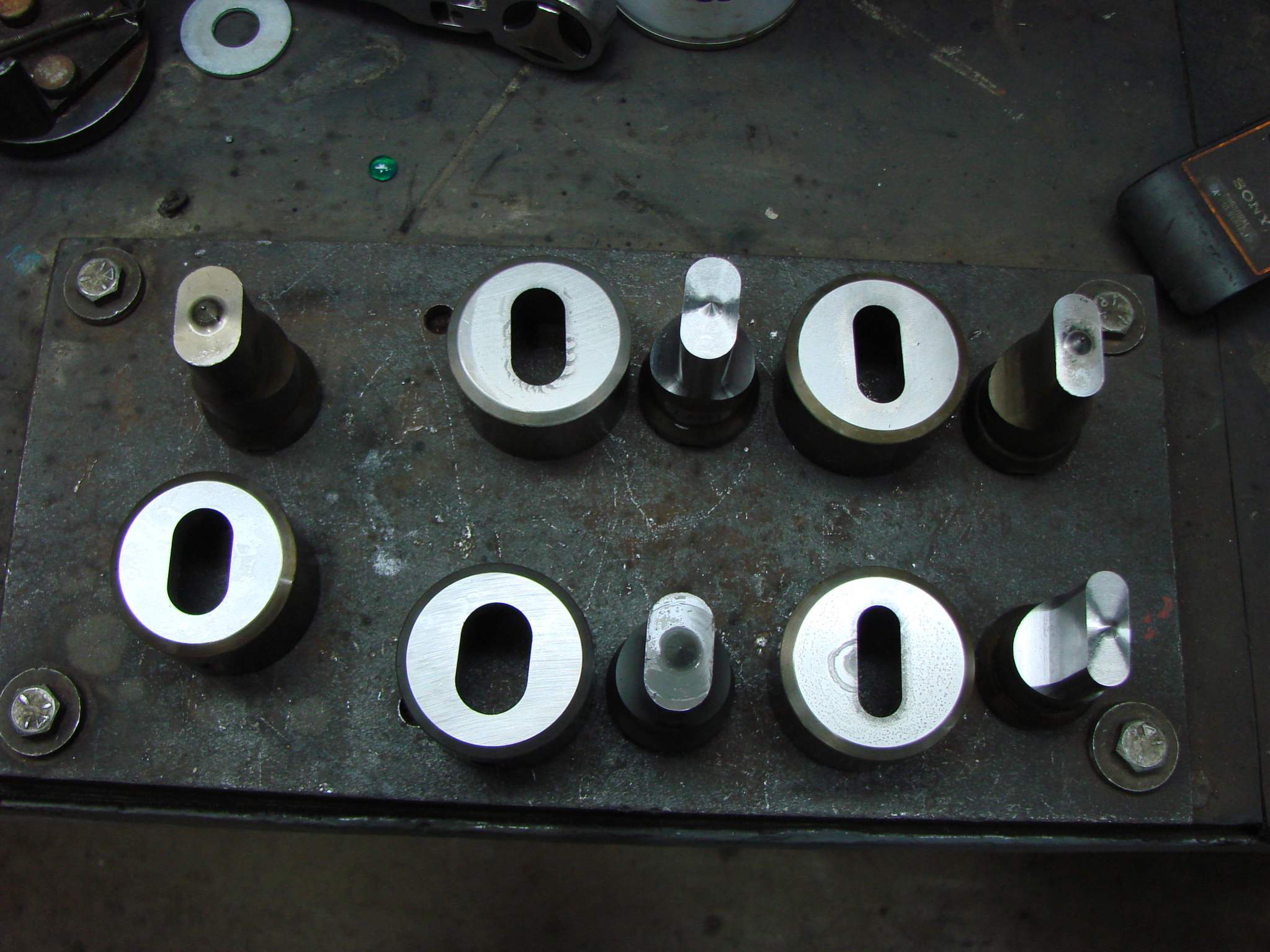

So I got all the Oblong punches unwrapped and you know Ijust had to try one. I picked up the 7/16 and chucked it in. I added a few pics just in case any of you were interested to see how or what they are and even do.
Sample plate was 1/4 thick. The machine didn't even know it was there. I've seen times where I sure could have used these. For an example: An electric or gas motor plate that's linked with a belt or belts. With the elongated holes you have a easy way to adjust the belt tension now and the time saved not having to mill them out.
To mill these four holes like this would take me an hour by the time I held the plate in the mill plus all the clean up after. With the Ironworker it takes less than one minute. Ya there worth it. :thumbsup:

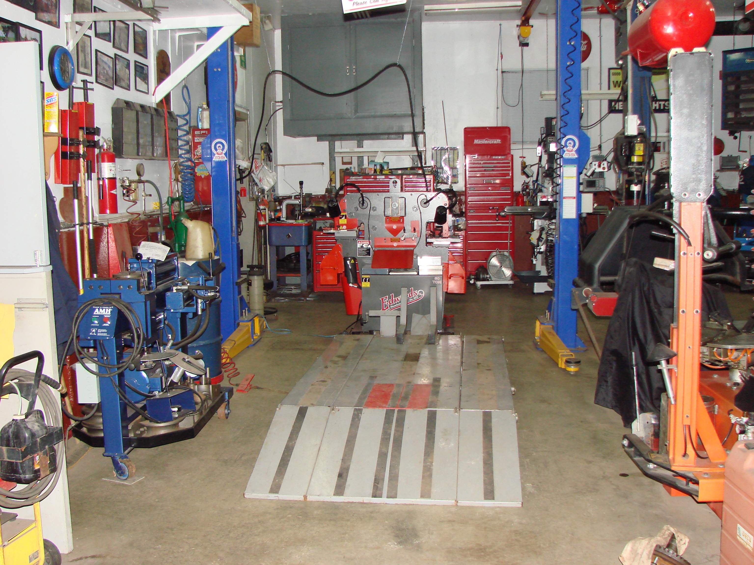

Thanks toy. Glad you liked the cart and welding rig. No doubt about it I have a VERY understanding wife. She is the other half of the business and the most important have in my mind. In the 30 years she's been with me I think she has the confidence in me to know if I put it in the shop I'll make coin with it and in the last 15 years in business It's been that way. Good tooling means good quality work. If you look at my photo page you'll see the restorations I've done. To do that type of work requires good tooling. If you don't have the proper tools you can do the work.
Were it's only me that work in the shop area I have everything set up so that it's at arms reach. The Ironworker is placed in my spare bay. That bay has a new two post hoist in it, a motorcycle lift, hydraulic pipe bender and now the Ironworker. If anything happens to my main hoist on the other side of the shop everything in the spare bar can be moved in a matter of minutes so the new spare hoist can be used. The motorcycle life is on wheels as is the pipe bender and the Ironworker is designed to be moved with a fork lift.
Doing and having it all this way helps me work very efficiently. I know where everything is at any given moment. These Ironworkers can be ordered with a number of accessories. When I ordered mine I didn't buy the square tubing cutter. I just don't use square tubing enough to tie up a station on the Ironworker. For me the break, plate share,angle share, punching station and notcher was what I was really after. The other mods I made to the machine just made it more practical.
If I had a larger shop I'd just fill it up with more tools :laughing: Thanks for your comments.
