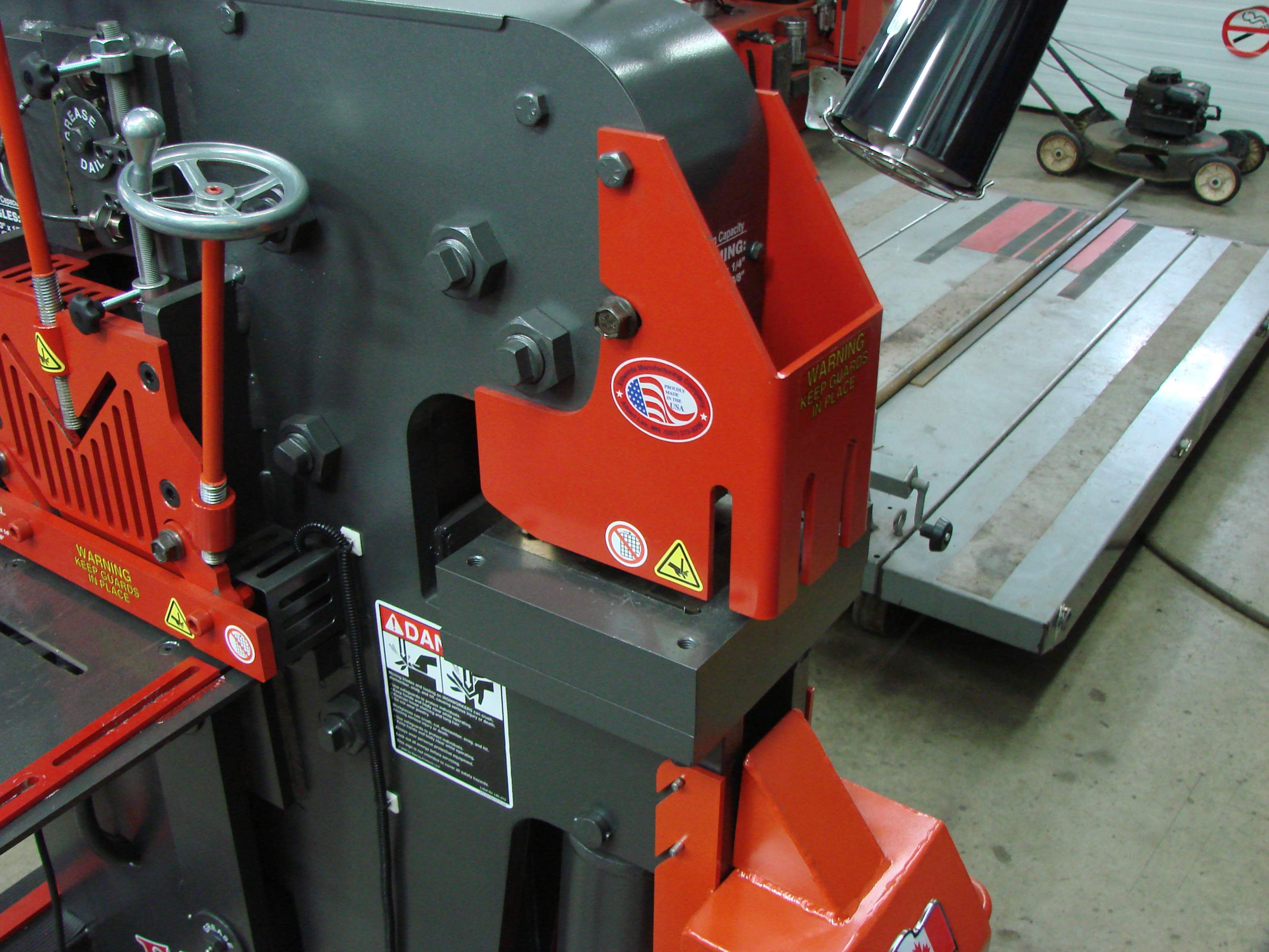

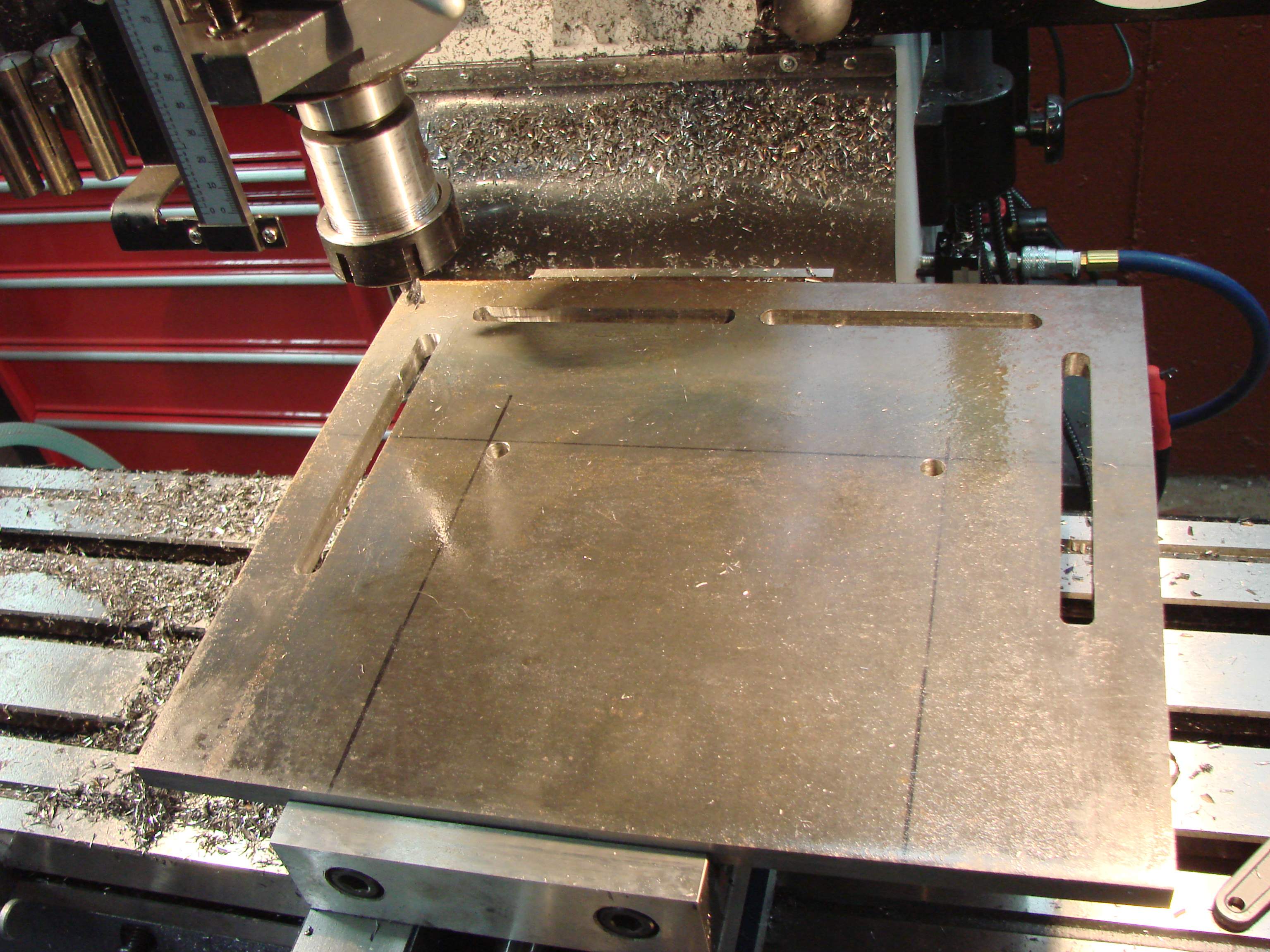

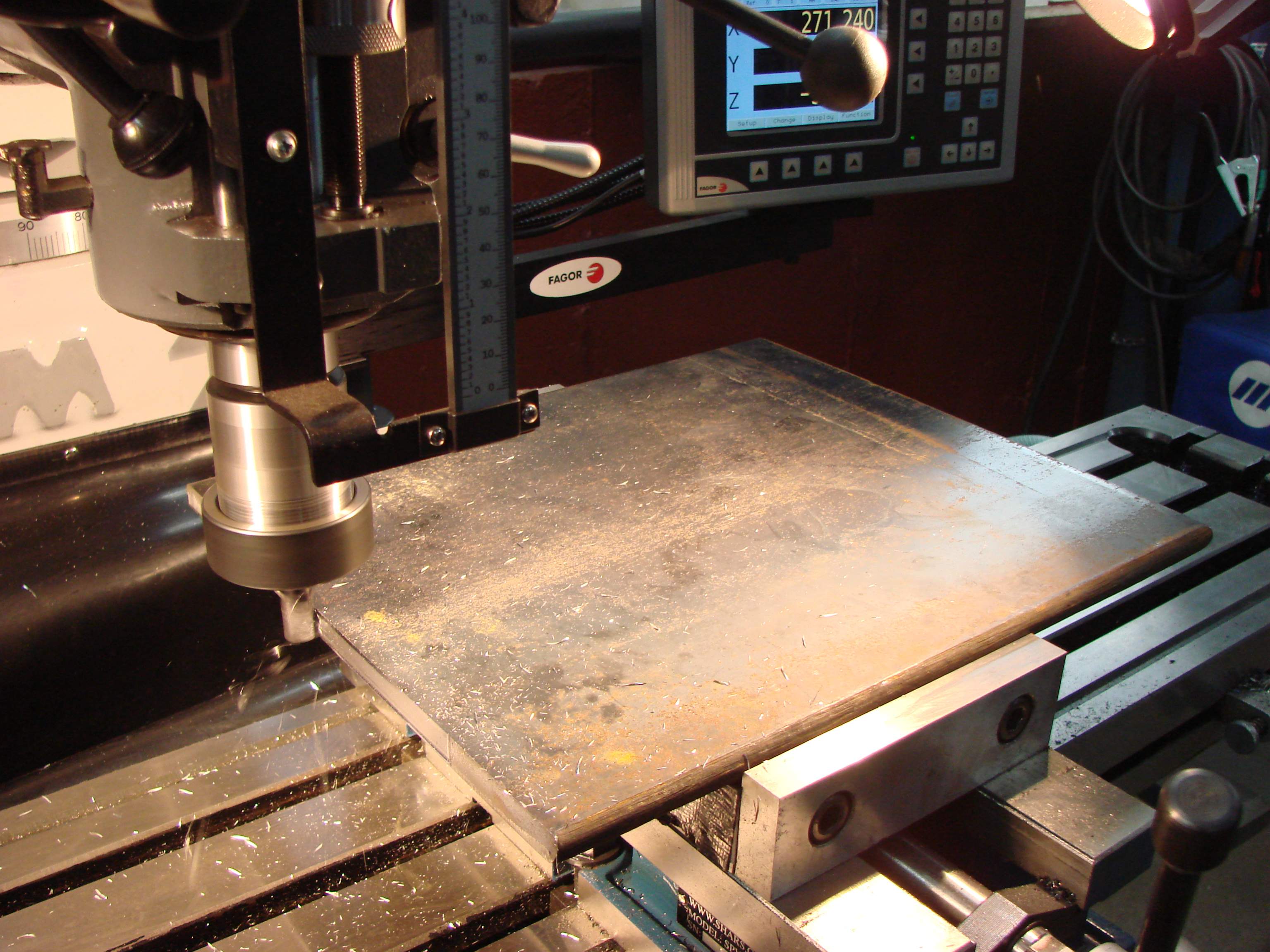

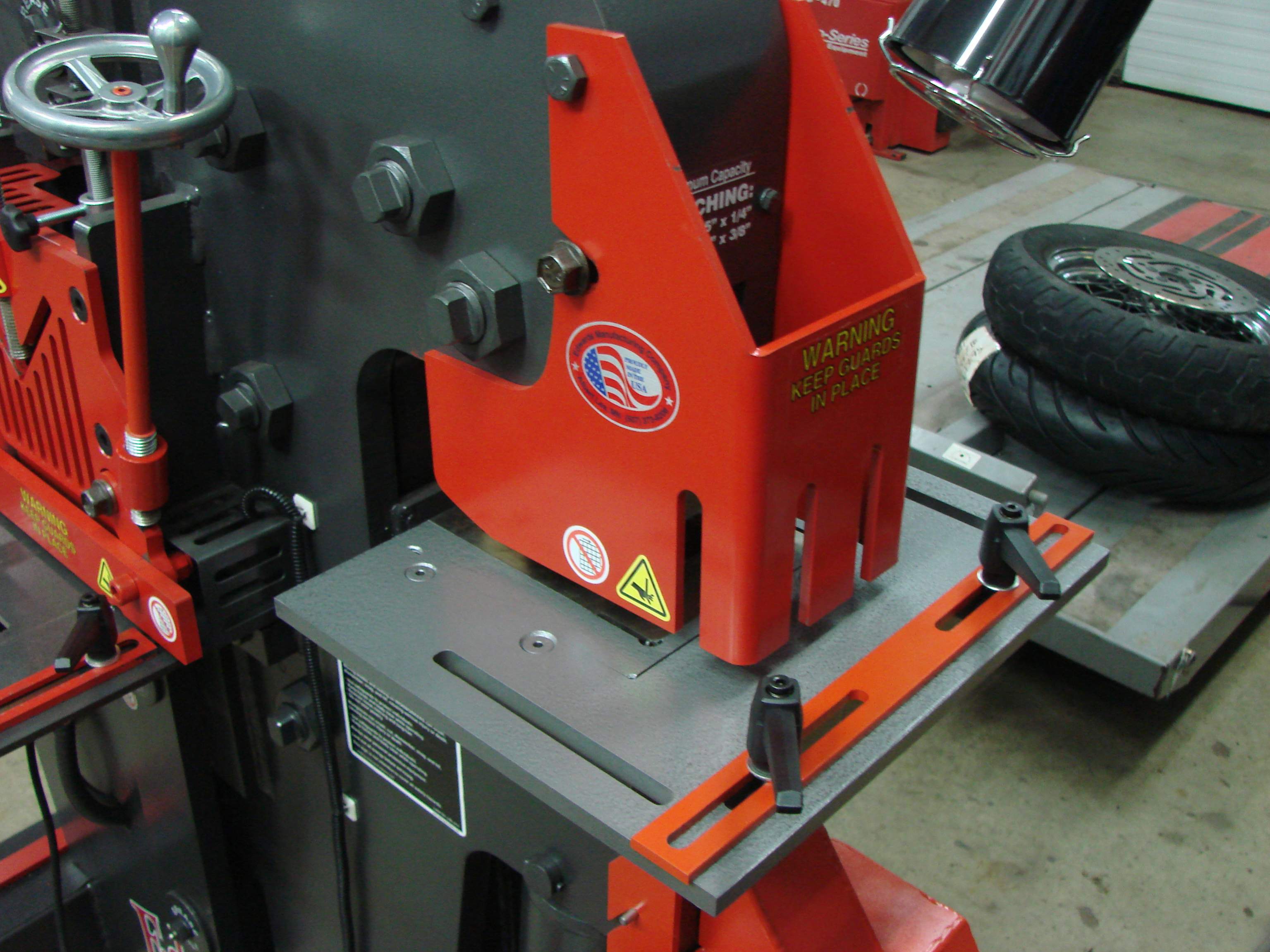

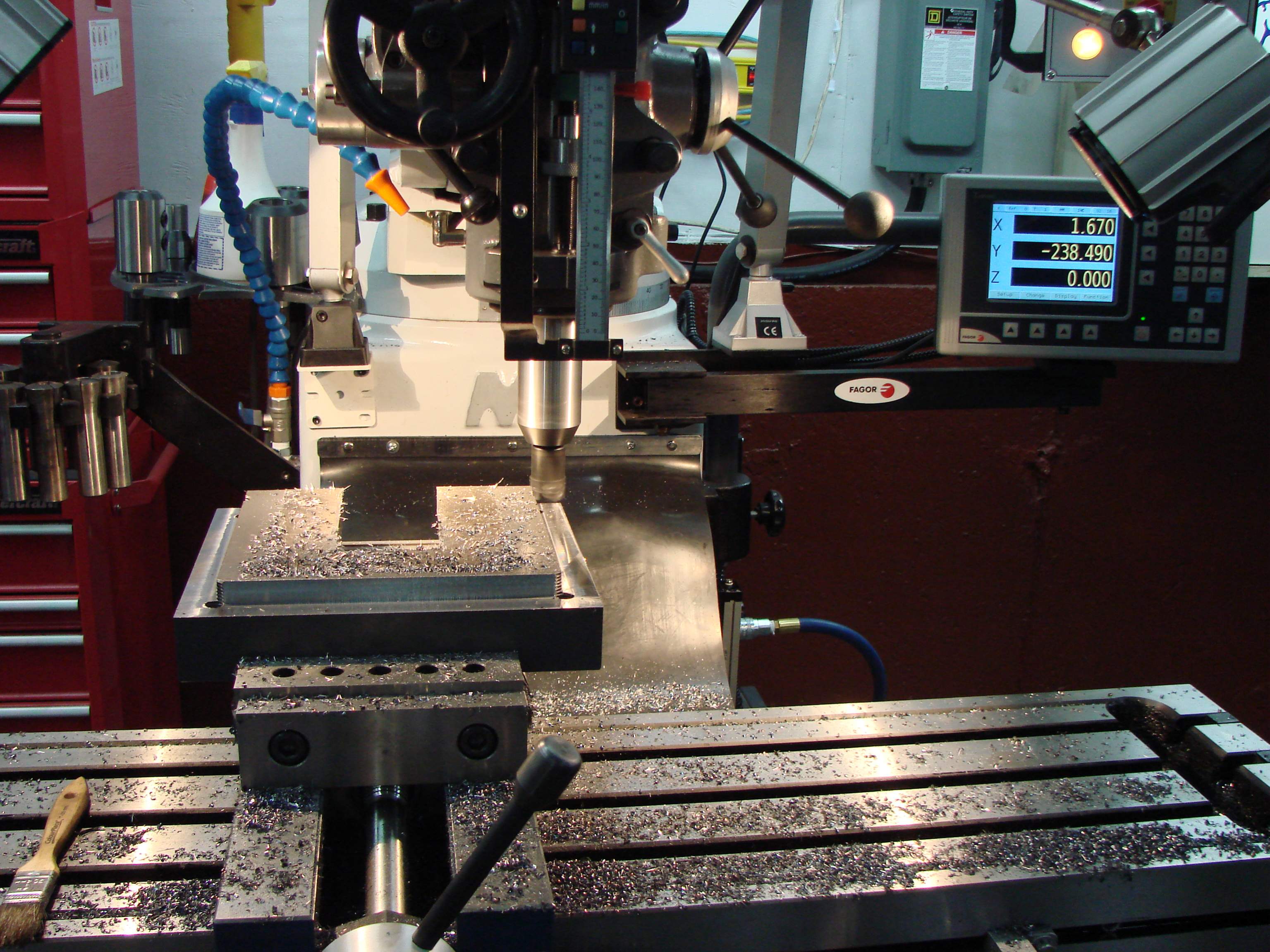

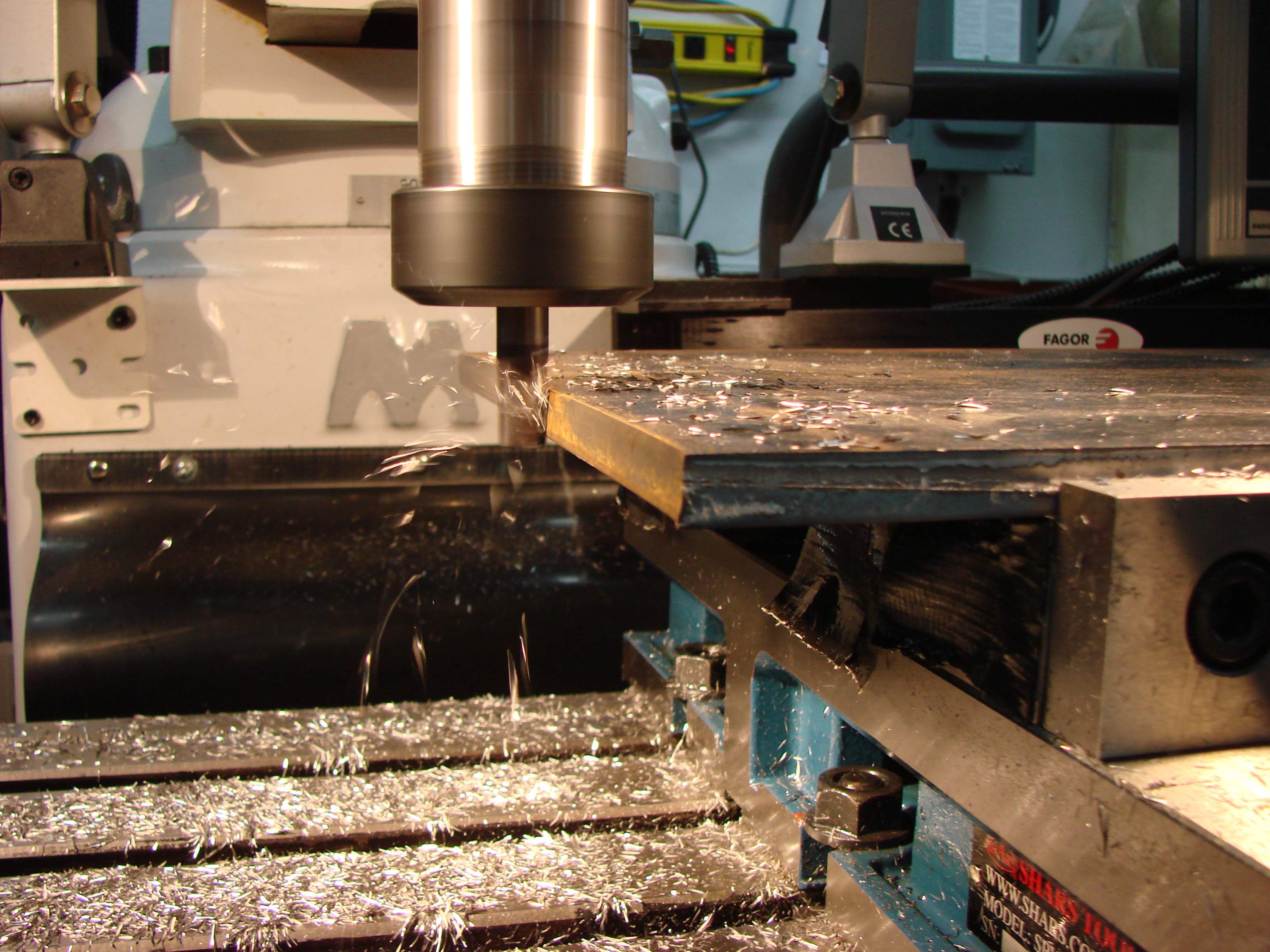

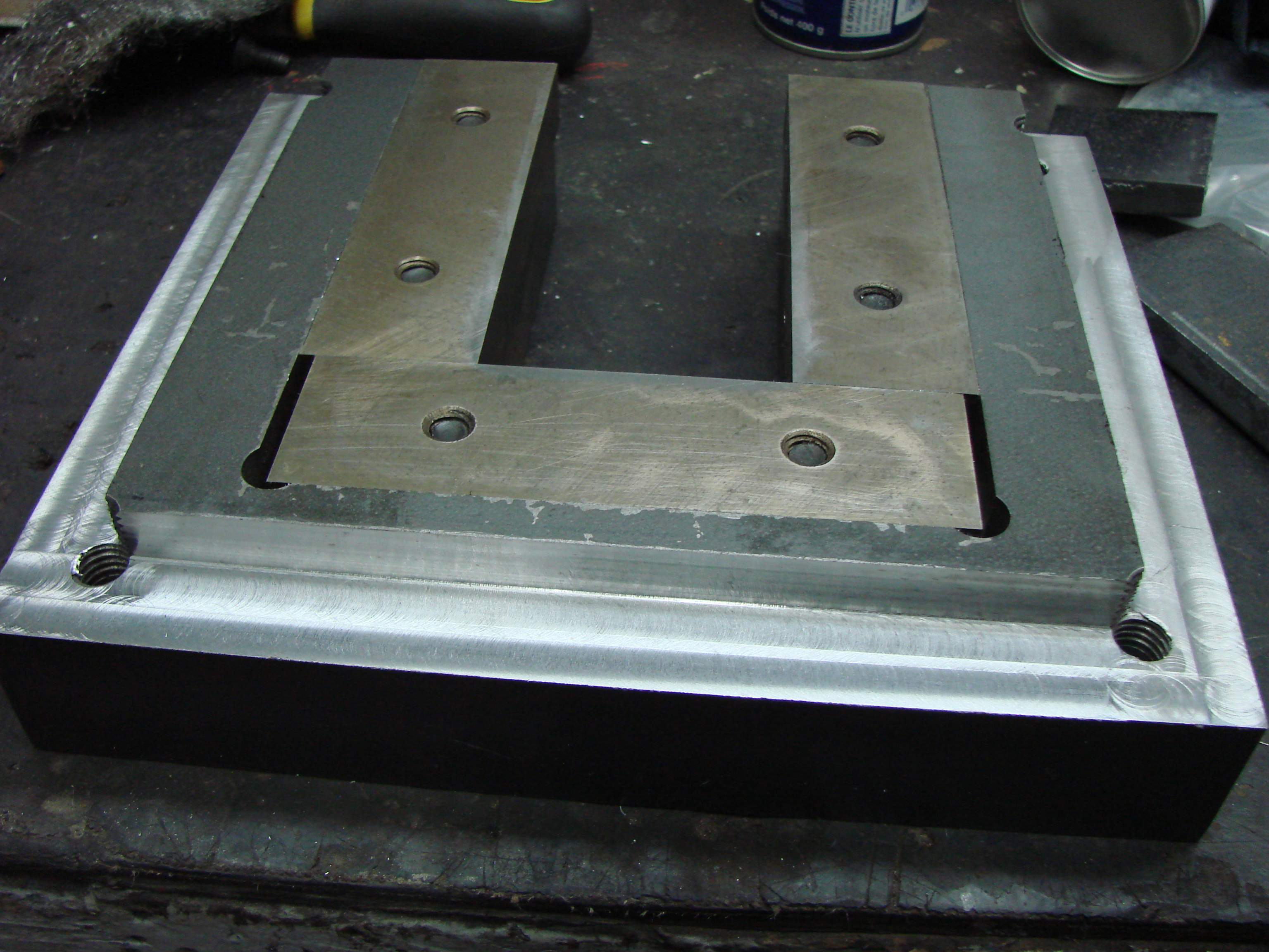

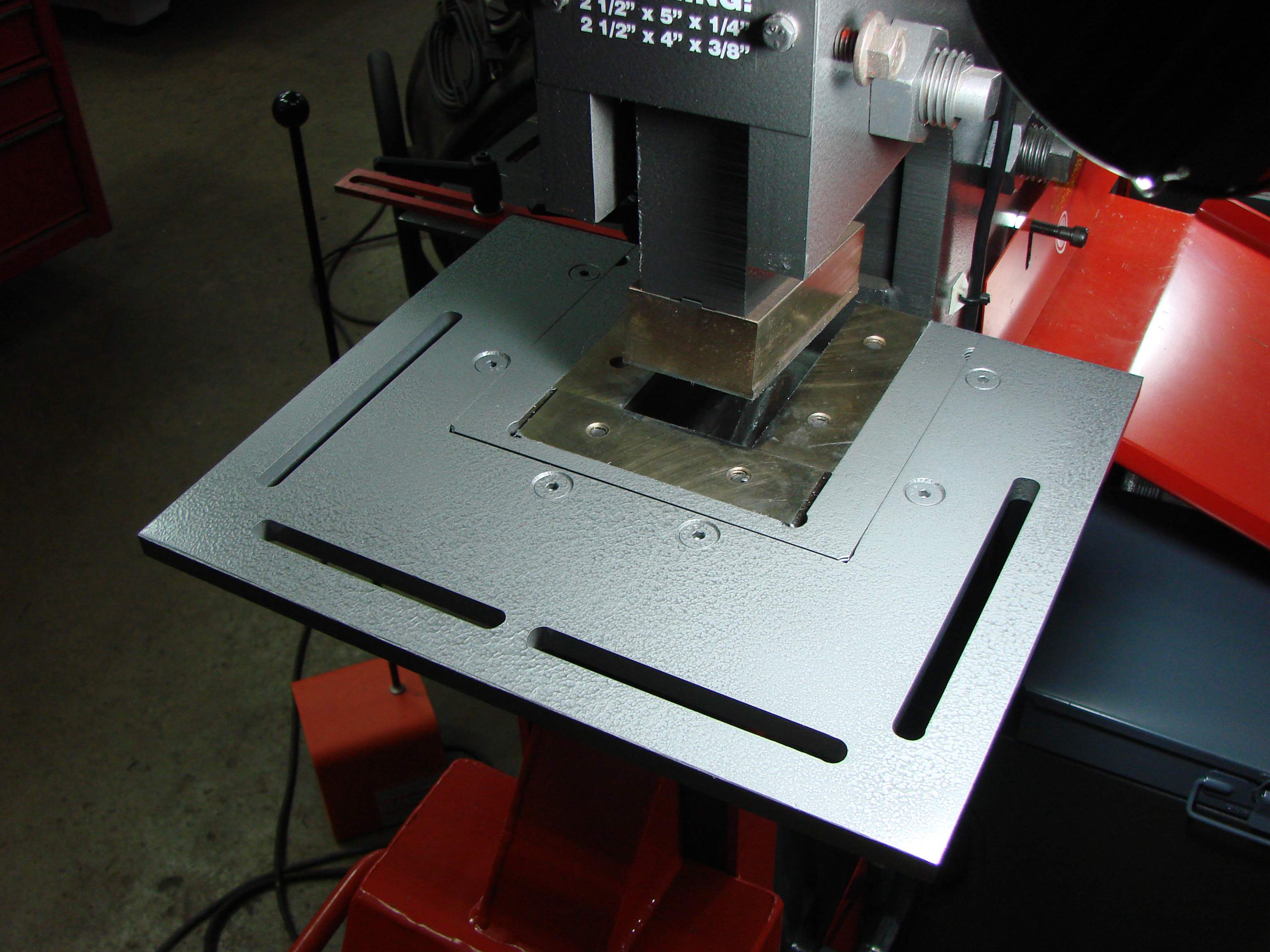

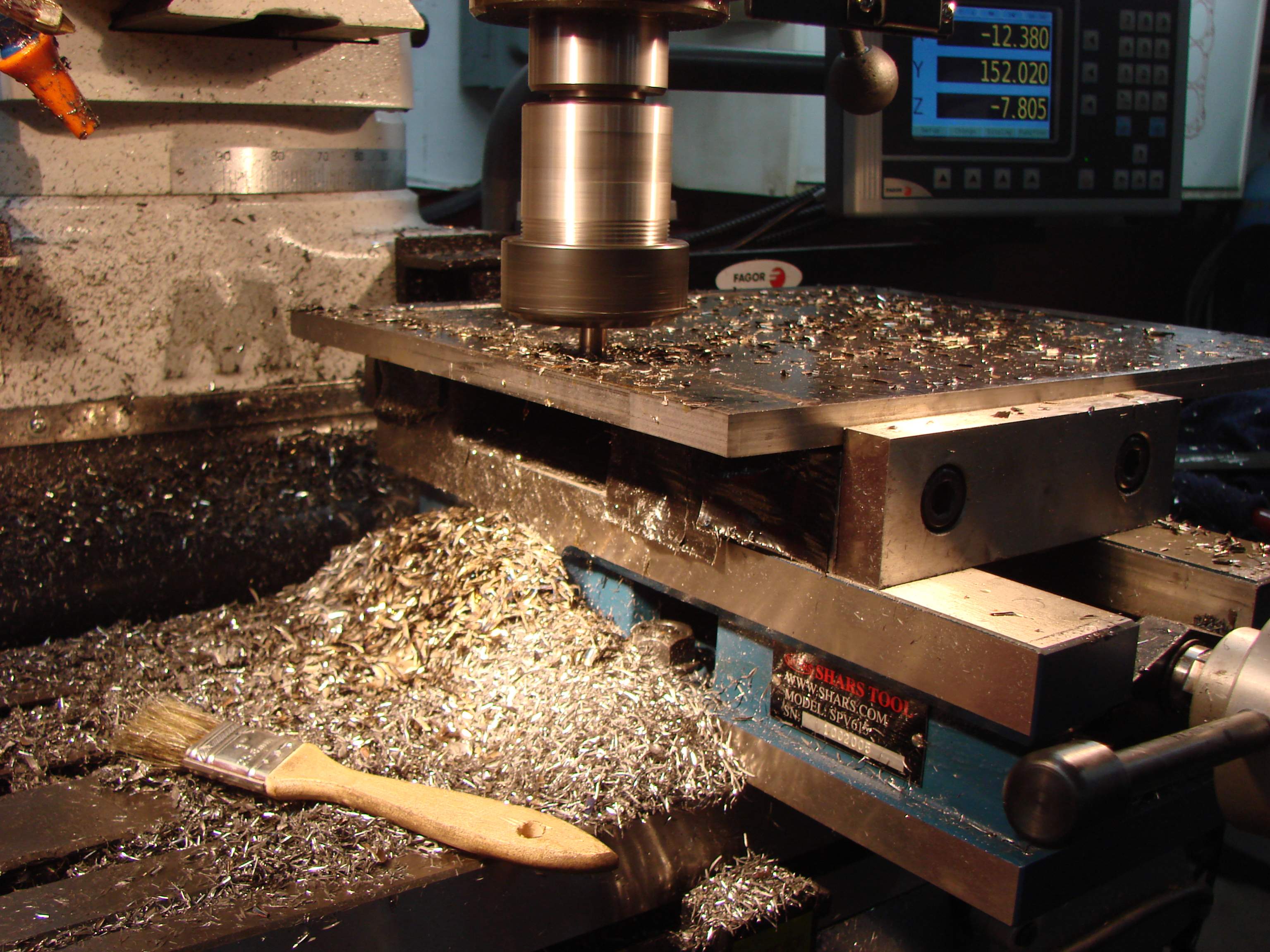

Well seeing it was a long weekend for me and plus the fact it was raining the full three days It gave me the time to add the "Z" axis scale to the new mill and also to complete the last of the mods to the Edwards Ironworker.
seeing the was a work table for the punch and brake section of the unit and a work table for the plate shearing portion of it as well I couldn't see why there wasn't one for the notching station of the beast. After all if you want to make a few consistent notches it would be nice to have the table and a guide or two.
Anyway in wanting to have a project for the milling machine I got myself a piece of 1/2 plate 14" X 14" and set in to build me a table. I must be slow because it took me 10 hours to build the thing but it sure worked out well. The first thing I had to do was mill 3/4" off the outer portion of the notcher adapter and then start in at the the plate. The funny thing to all of this is a few friends stopped by the shop today as I was cleaning up and asked me what I was up to and i told them I just built a part for the Ironworker and after looking around they couldn't see what it was that I built :confused2: Oh well. It must fit in with the rest of it OK. ;)Here's a pictorial of the operation
The first picture shows how it looked when I bought the thing.
If they couldn't tell what was factory made versus home made, then that is a high compliment to your abilities.
