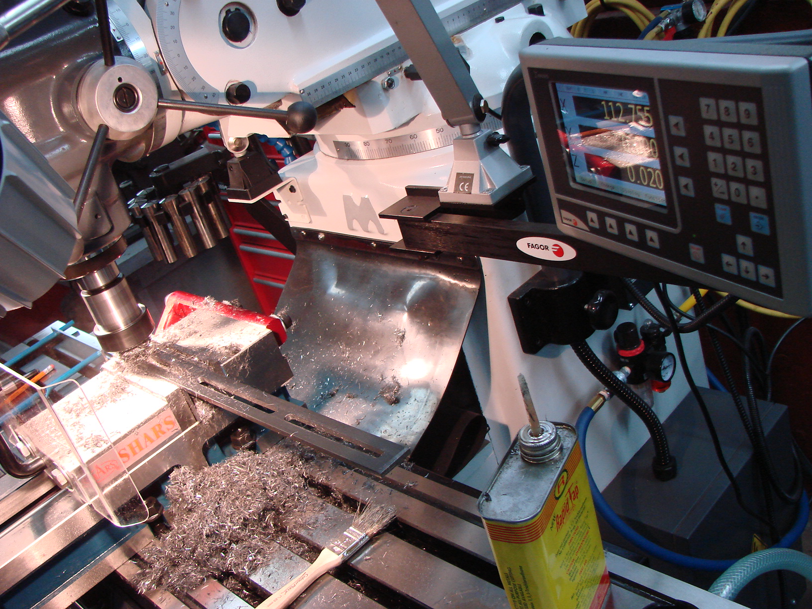

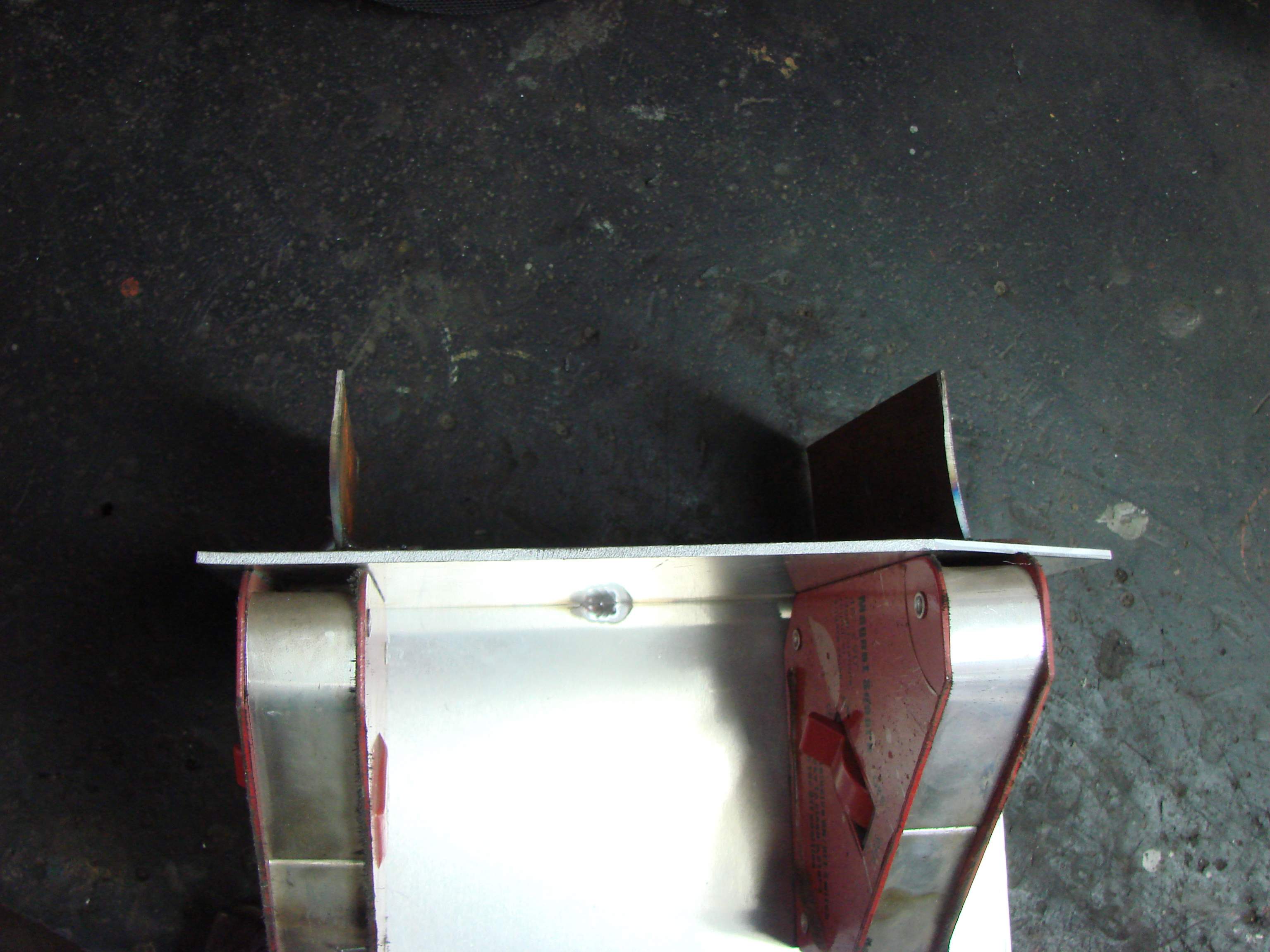

Paul, as usual very impressive work. I set a tote under mine to catch the slugs. I noticed something in one of your first sets of pics that has me scratching my head. You said you were building this out of aluminum, but I thought I saw 2 magnets in the one pic one the inside of the tray? Or was this something else. Let me know if you find any uses for the slugs. I am accumulating quite a few.

It looked like he might have had a piece of steel behind the aluminum so that the magnet could keep the two pieces square. The bottom was over a metal bench. I looked at that myself a couple of times.

Bill you got a good eye sir. Cyril was right. It was a little trick I used. I placed a 1/8th steel plate on the other side of the aluminum. The magnets on the squares were powerful enough to keep the parts square and in place until I tacked them. That's the part I hate about aluminum. Holding it in place is a real pain. Well for me anyway :laughing: Here's another picture for you so you can see it better. Thanks for your comments. Much appreciated :)
Good eye my friend :thumbsup:

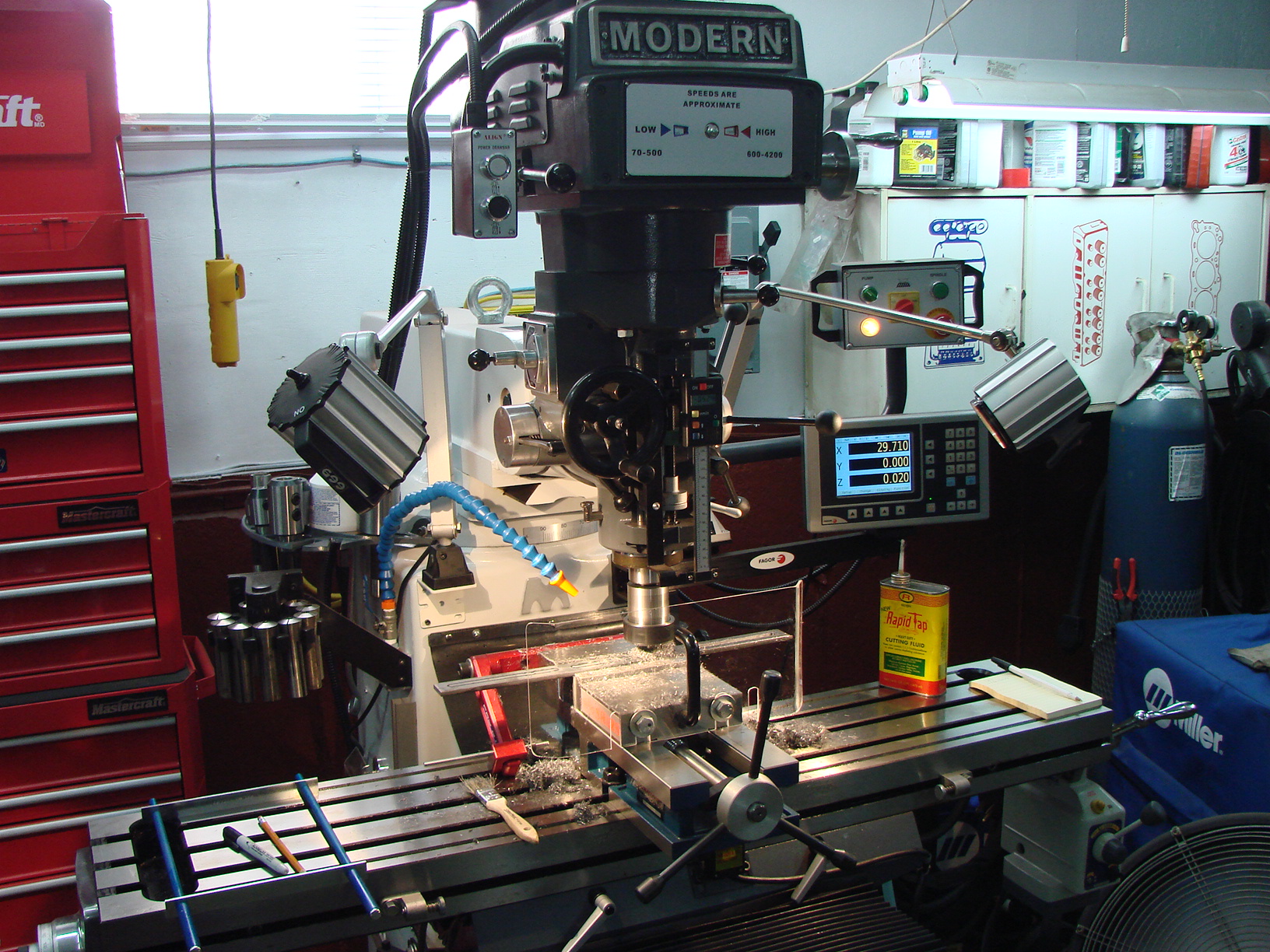

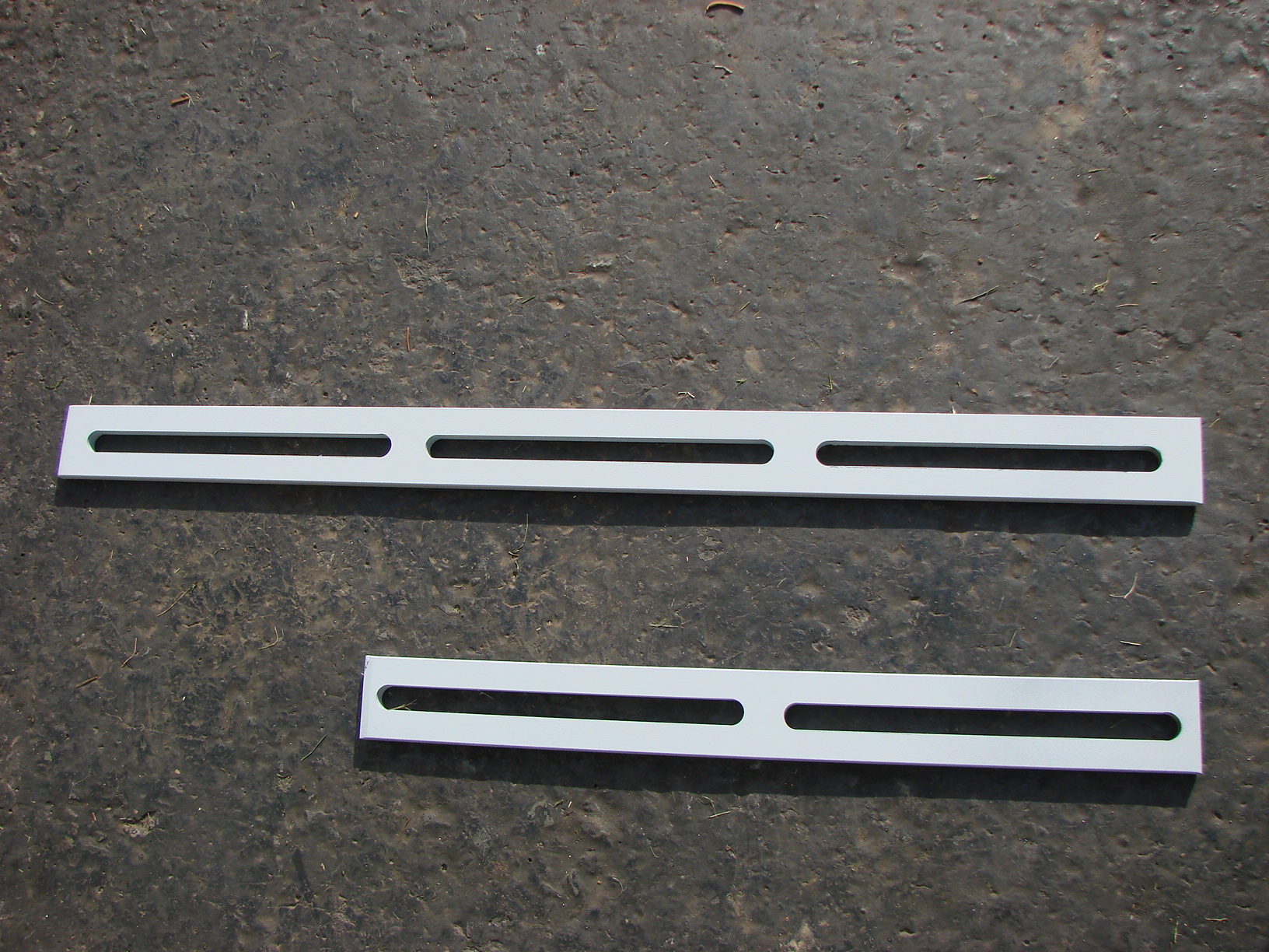

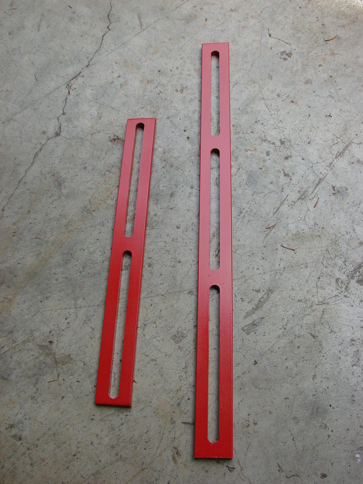

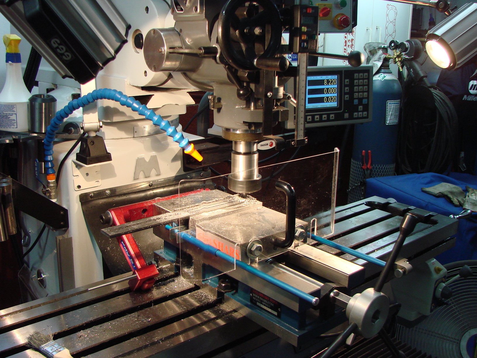

To keep the boredom going here I figured I'd post a few more pics. When I got the Ironworker it came with a couple of guides that attach to the work tables. The only problem was the there are two work tables on this machine and only one set of guides. Yes I could have ordered a set BUT for $80. plus shipping and maybe a month to get them I decided to try out the mill and make a set. As milling goes it don't get much easier and there's not allot of skill involved here but at least I got an extra set of guides :D

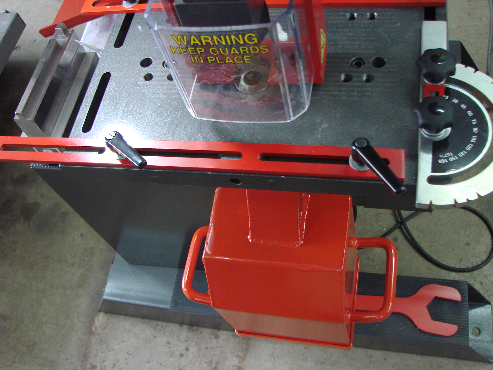

A couple of more pics. One more modification and I'm done pimping this machine out :cool:

:thumbsup::thumbsup::thumbsup: Very nice, Paul. Nothing like having the tools to PROPERLY get the job done! Nice touches made to the Ironworker.
