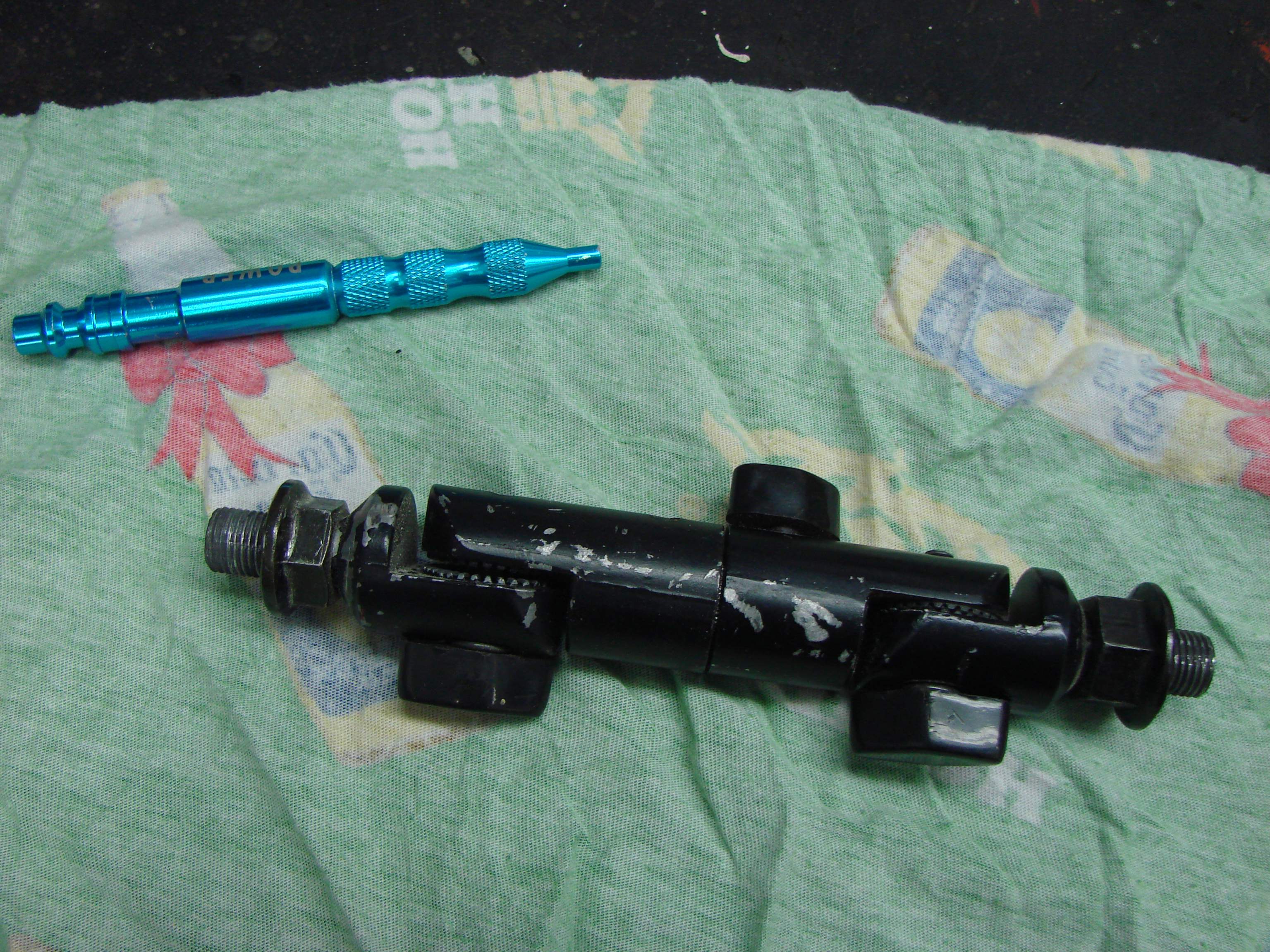

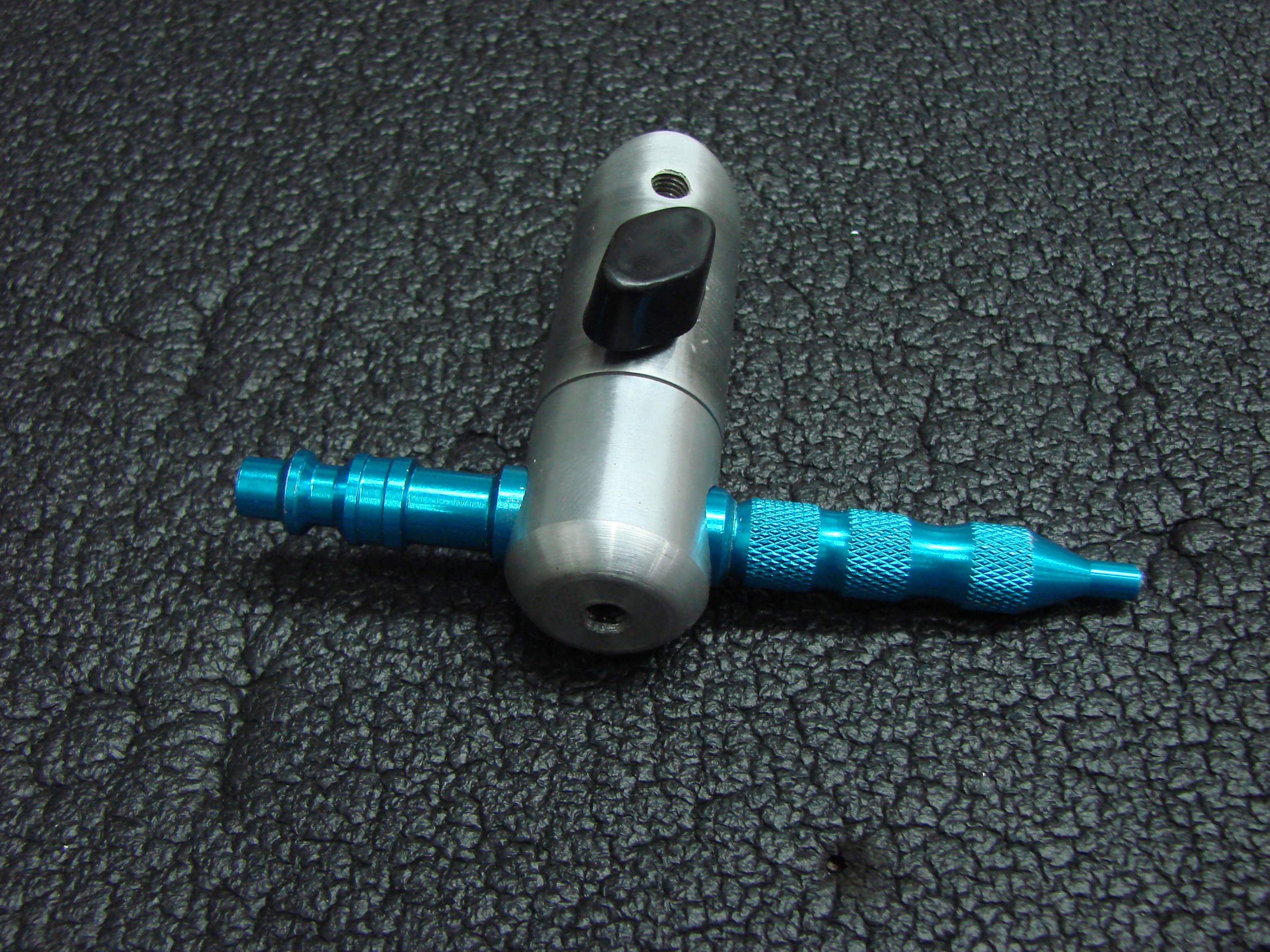

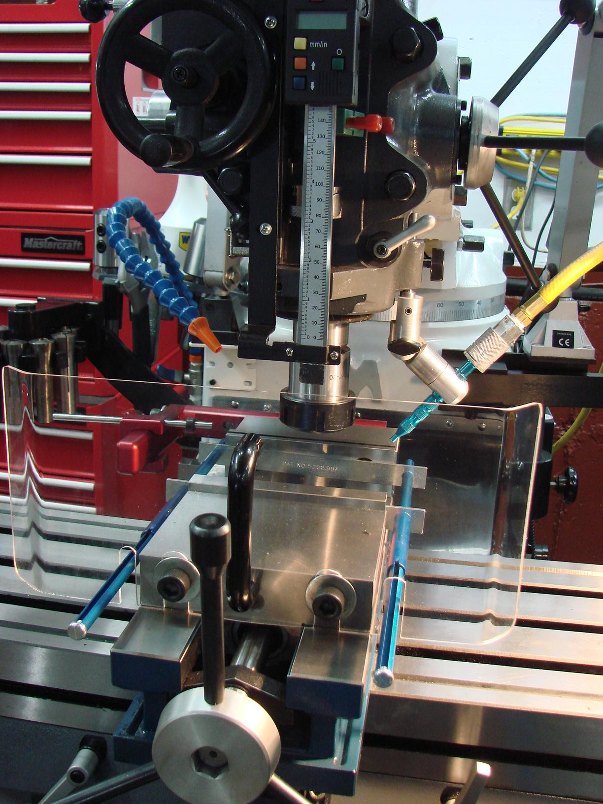

Thanks Jay. I'm still trying to get used to the new mill but I'll get better at it in time (I hope anyway) I think the only thing that I didn't like about this project was the cuttings and trying to keep them away from the work so today I had a brain storm and came up with this system to solve that problem. I used a blow nozzle. This one will turn on when you twist the head of it and the air volume can be regulated by the twisting of the head.
I found an old car phone mount and use some of it's parts and along with a few machined parts I think I've come up with a salutation to the cuttings problem. here's how it turned out.

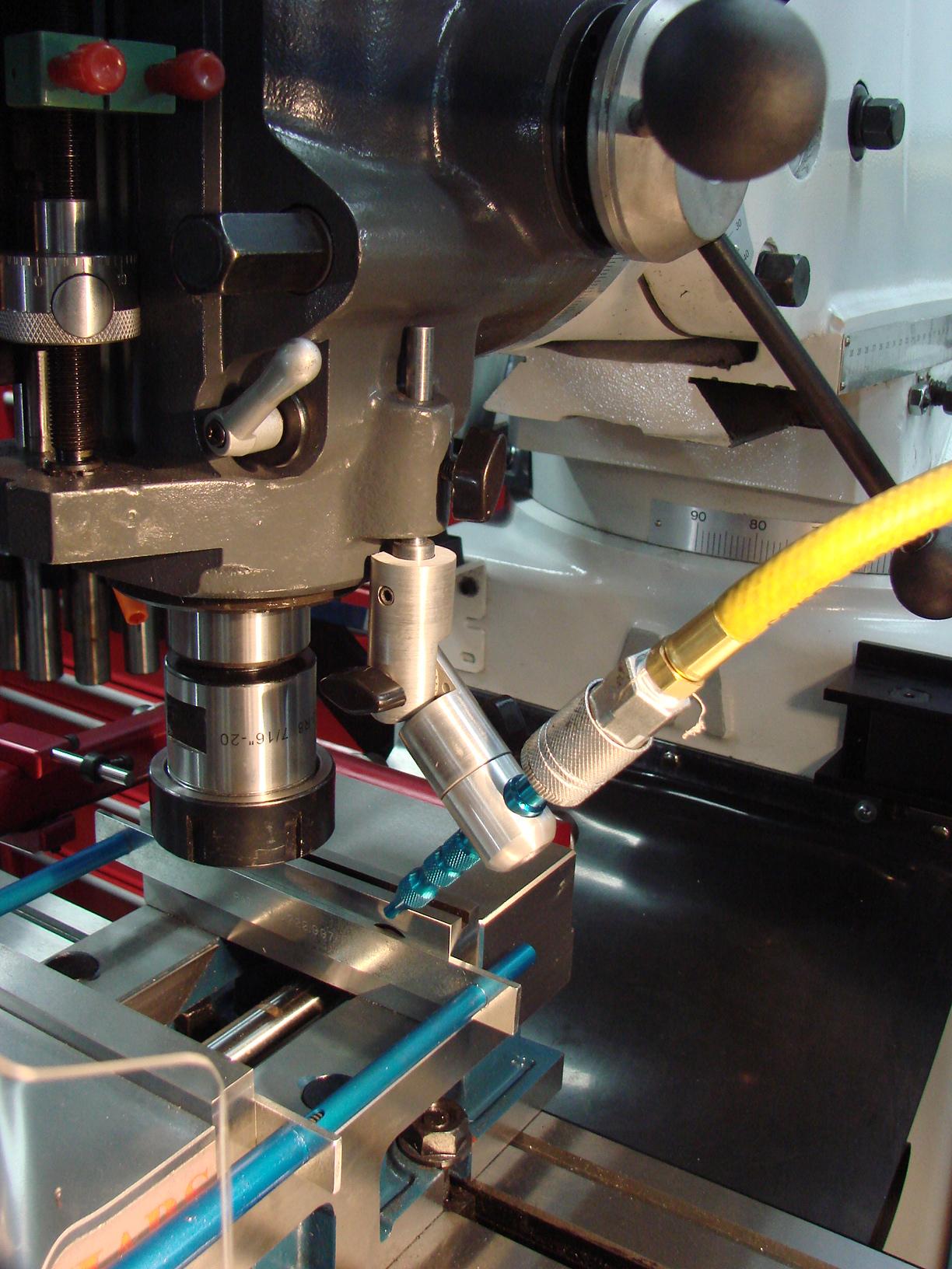

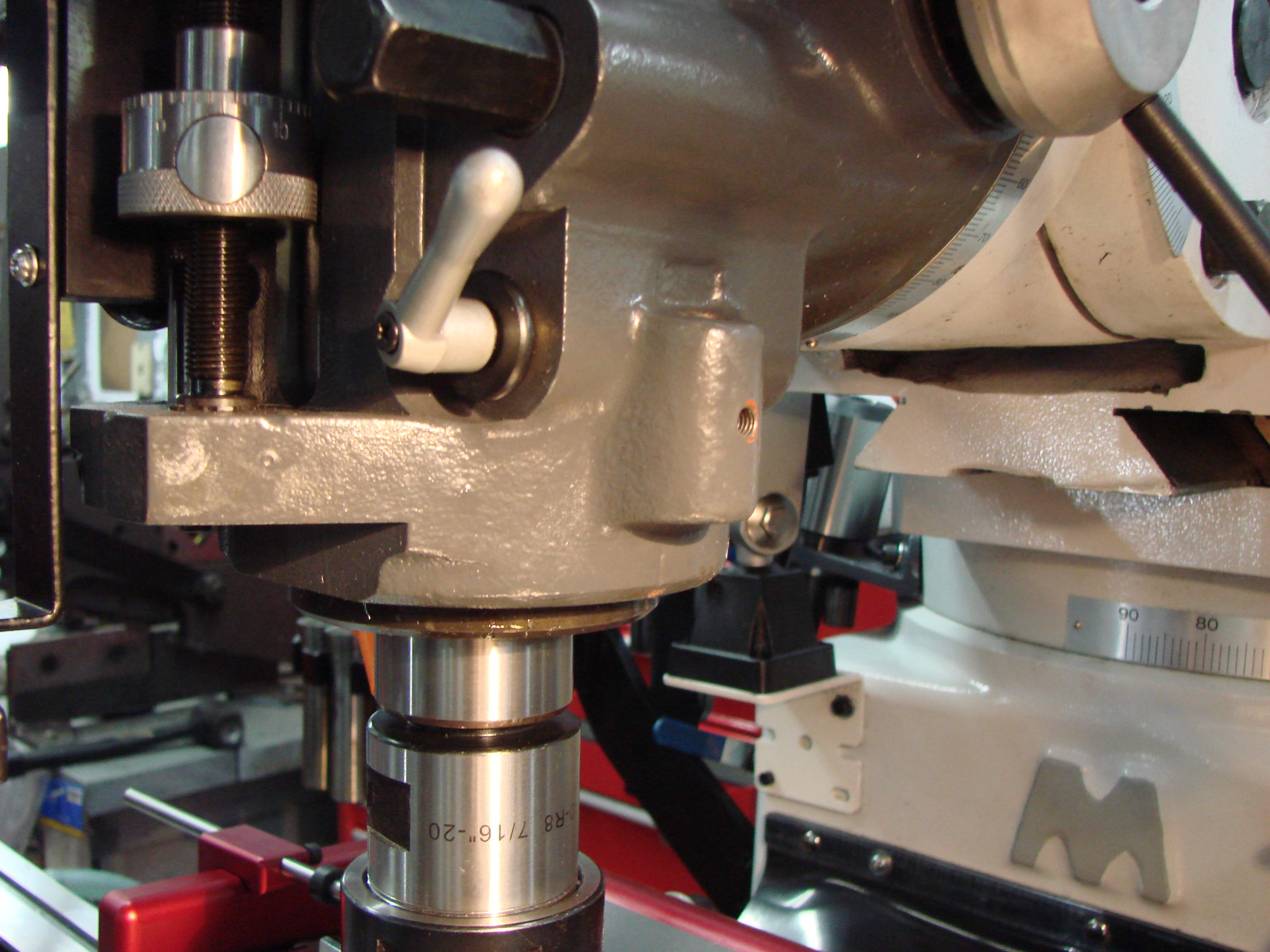

A few more pics!

To be serious again, I like that nozzel you found. That's sweet. Have you tried it in action yet? The only possible drawback I can see is that it looks like it might be in the way of the handles on the right, but depth perception doesn't convey well in photos. There could be a lot of room between them.
   / By the Ironworker for the Ironworker
#89
Cyril I just did it this evening so I never tried it yet. The hose can actually go allot lower but I just propped it up there to give a good visual of it. There's also a swivel fitting going on the quick connector when I get into the city to get one this coming weekend. I think it will work fine. Time will tell. ;)

If not, a simple solution might be to get a male and female QD and put a 90 degree elbow between them so the hose comes to it at an upward angle.
