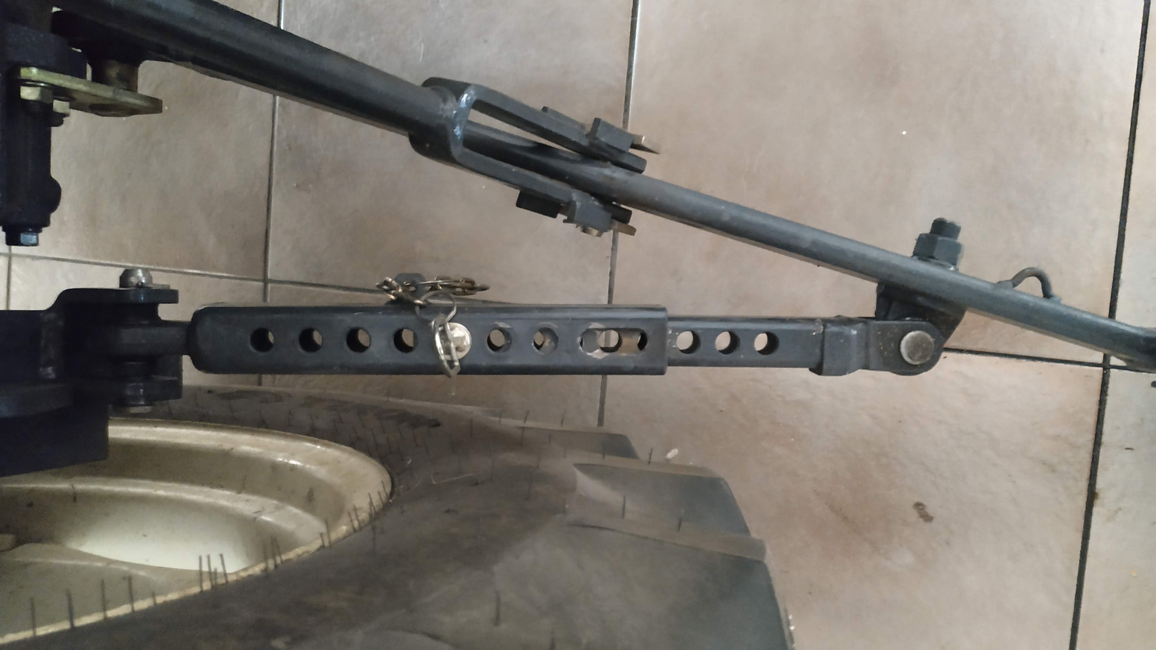

I'll take some pics of mine tomorrow. I had never seen any like them but I'm sure there are. They don't have nuts to lock them they are pinned. And the also slide and pin. Wish I had had them on my old 5310.

The reason I made that video a couple years ago is because there had been a string of threads about people breaking their stabilizers, and it was obvious the damage was caused by putting the stabilizer in compression. When properly adjusted, they should never experience compression, and that type of damage wouldn't even be possible. I am sure there are other ways to damage them though.
If you look up the specs of a turnbuckle in a mechanical design handbook or catalog, you will see they are almost always rated for tension load only. If a compression rating is given, it's much much lower (order of magnitude lower). The shape is very strong in tension, but in compression they have very little resistance to buckling.

My problem with the turnbuckles is that when the 3ph is not in use (ie no implement attached), the arms are free to swing, and on the bx23, they swing inward until they almost touch. This allows the turnbuckles and attached chain links to slump toward the hitch. In my case, there was a tow ball attached to the hitch, and the turnbuckles got tangled in that when the 3ph slumped down when parked. When the tractor was started and the 3ph raised, I ended up with both turnbuckles mangled. They were eventually straightened out, but with my senior memory lapses, it was bound to happen again. Telescoping stabilizers prevent this from happening, as the 3ph arms are not free to swing from side to side.

Plenty of posts on here about people bending the 3-pt lift arms by pushing backwards (box blade, etc) and that will usually mangle the stabilizers too. But the stabilizers can buckle from forward or side loads if it puts them into compression. I personally think it would be hard to do, but folks manage to do it somehow.

The tension/compression took a sec to figure out but now I get it.
Under tension, the stabilizer is perfectly straight.
Under compression, an (initially small) angle is created because (example: telescoping) the fit isn't perfect. As soon as there's an angle, some of the compressive forces are going away from the base of the stabilizer and it ends up folding.
My guess is that the turnbuckle stabilizer may be slightly better at handling compressive forces because there's less play at the joint (assuming it's tight) but as soon as any deflection exists, such that the stabilizer isn't *completely* straight, that deflection can rapidly (and catastrophically) increase.

Yeah, most stabilizers I have seen have some sort of clevis or swivel on one end that will fold over when in compression, and that will lead to binding or damage on the end. Beyond that though, you get into a buckling scenario if enough load is applied to the stabilizer link itself, since it's a slender structural member. It can handle a lot of load in tension but a fraction of that in compression. With turnbuckles, you can handle a large tension load but in compression they will buckle or twist.
I have also seen people do damage where the stabilizer link attaches to the tractor. Sometimes they attach to part of the rear transmission case and it can crack or tear off the mounting area. Maybe because the swivel end folds/binds up.
