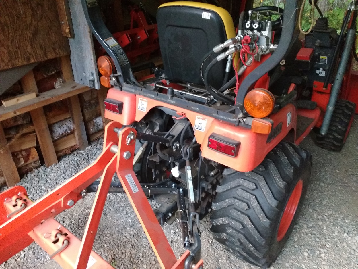

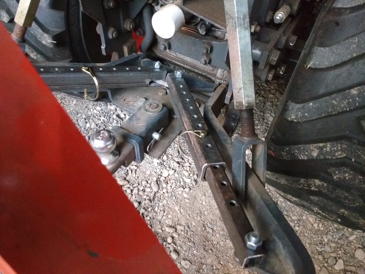

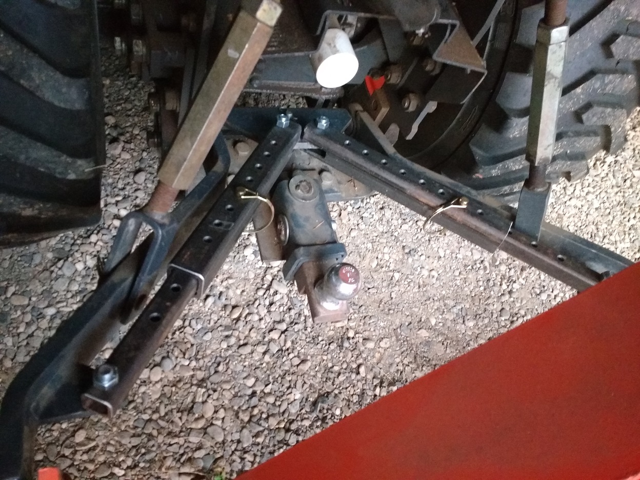

Not all scenarios benefit from a rigid fixed lift arm position. Sometimes you want a little bit of travel hence the slot in photo.
/ Bye, bye irritating turnbucles #3
Give it time, you'll get irritated with these too. Sometimes I can't find the "just right" setting like you can always do with a turnbuckle. The Kubota ones have a non-uniform hole pattern that gives a lot of in-between settings, but it can take a few tries to suss that out sometimes.
Make sure you adjust these so that they check motion by going into tension, not compression. A lot of folks overlook that part.

Because the spacing of the holes on the inside slider is slightly different from the ones on the outside tube, very small incremental changes can be made to the lower link position by selecting the correct hole for the pin.
/ Bye, bye irritating turnbucles #10
I never checked the hole spacing on mine but that must be how they work. Standard on the LS i have and works well.

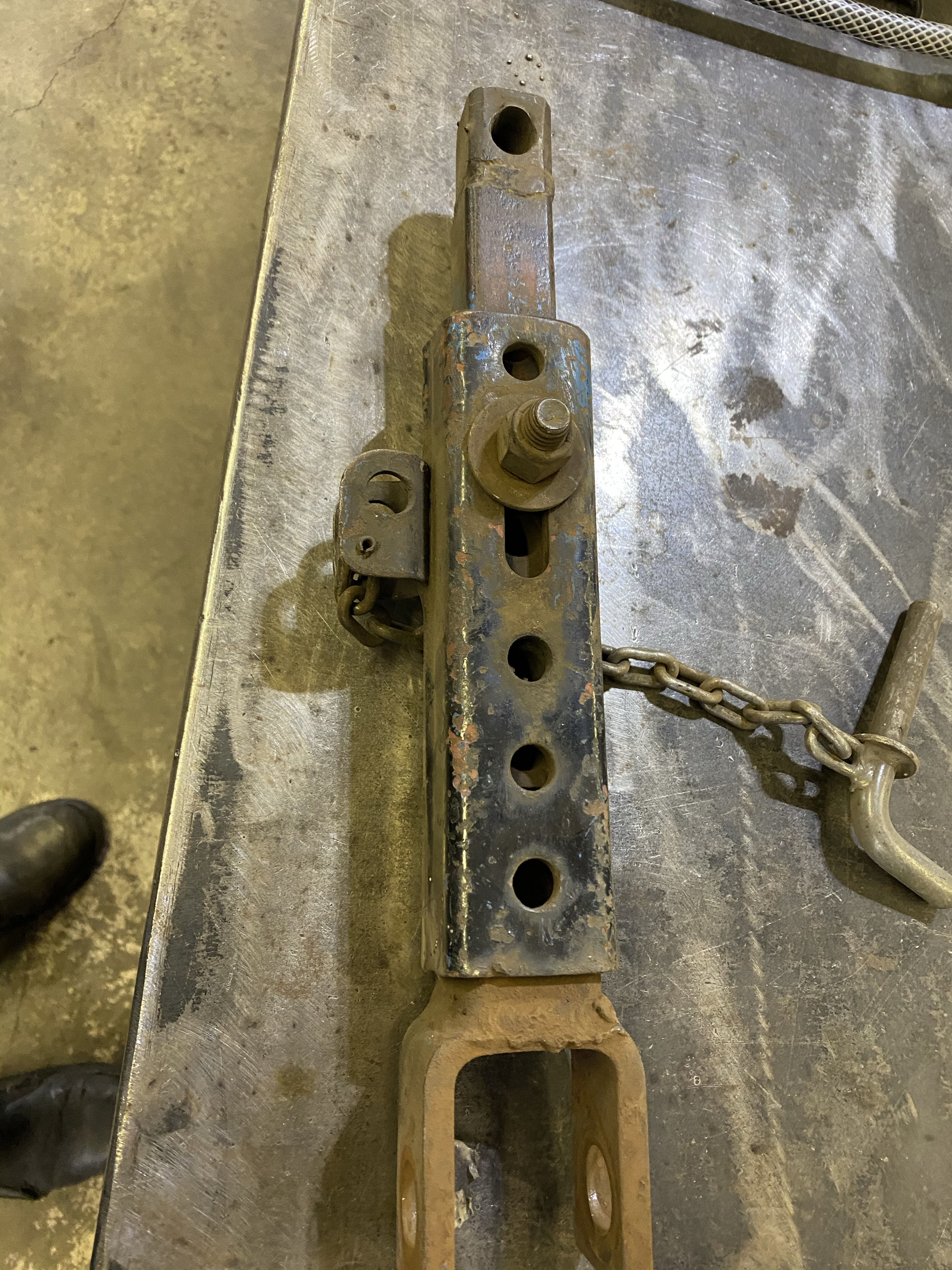

This telescopic style come standard on most tractors these days.
I've never had any problem finding the right spot and it also prevents the lift arms from bouncing around and hitting the tires with no implement attached.

Same with my MF 1540. Towards the tractor end, rather than individual holes, there is an elongated hole - maybe 3” long.
Never had any issues putting implements on or centering them.

You don't really want it very tight. 3 PT is not a perfect linkage setup, quite often the pivot point for the stabilizers is not perfectly aligned with the pivot point for the lift arms. This causes it to bind in certain 3 pt height positions if the turnbuckles are too tight.
On mine with the telescopic style, I get about 1/4" of play and that's exactly how I like to run my 3 pt implements.
