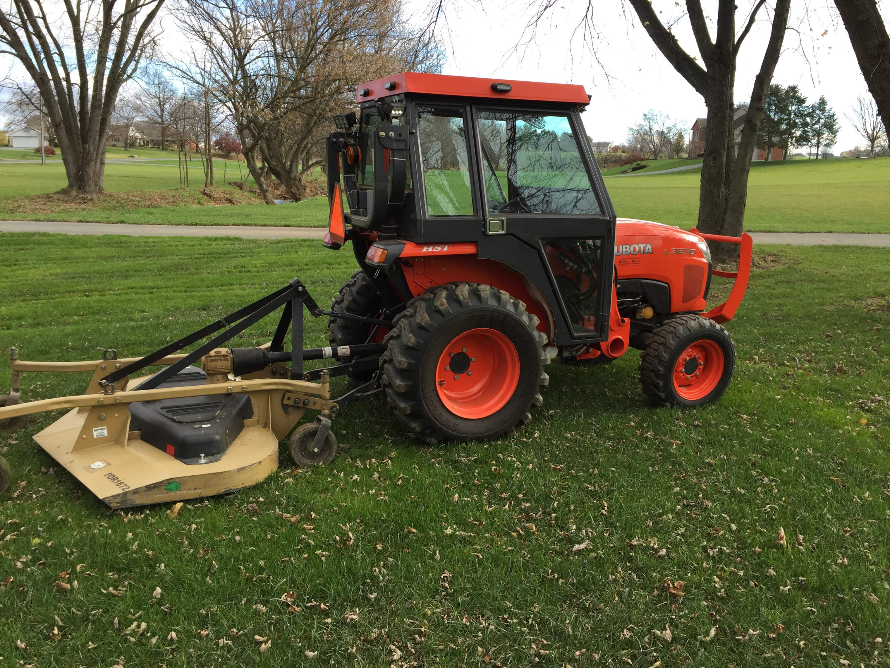

Welcome to the club. I wanted a cab for the first Kubota but never got up the nerve. After 10 years it was replaced with the current tractor and heading into the first winter with it (2012/2013) decided to go ahead and order some steel. It's coming up on 3 years since I finished my build and the cab still serves me well. It was chilly and windy here this morning at 09:00 when I started the last mowing of 2015, so I put the doors on it.
Roygage has an excellent write-up on his build and it was one of the most helpful for me. My advice would be to spend lots of time Googling any combo of the words build-cab-homemade-DIY-tractor-etc. You get the idea. There's value in reading about pitfalls to avoid, good sources for parts and much more.

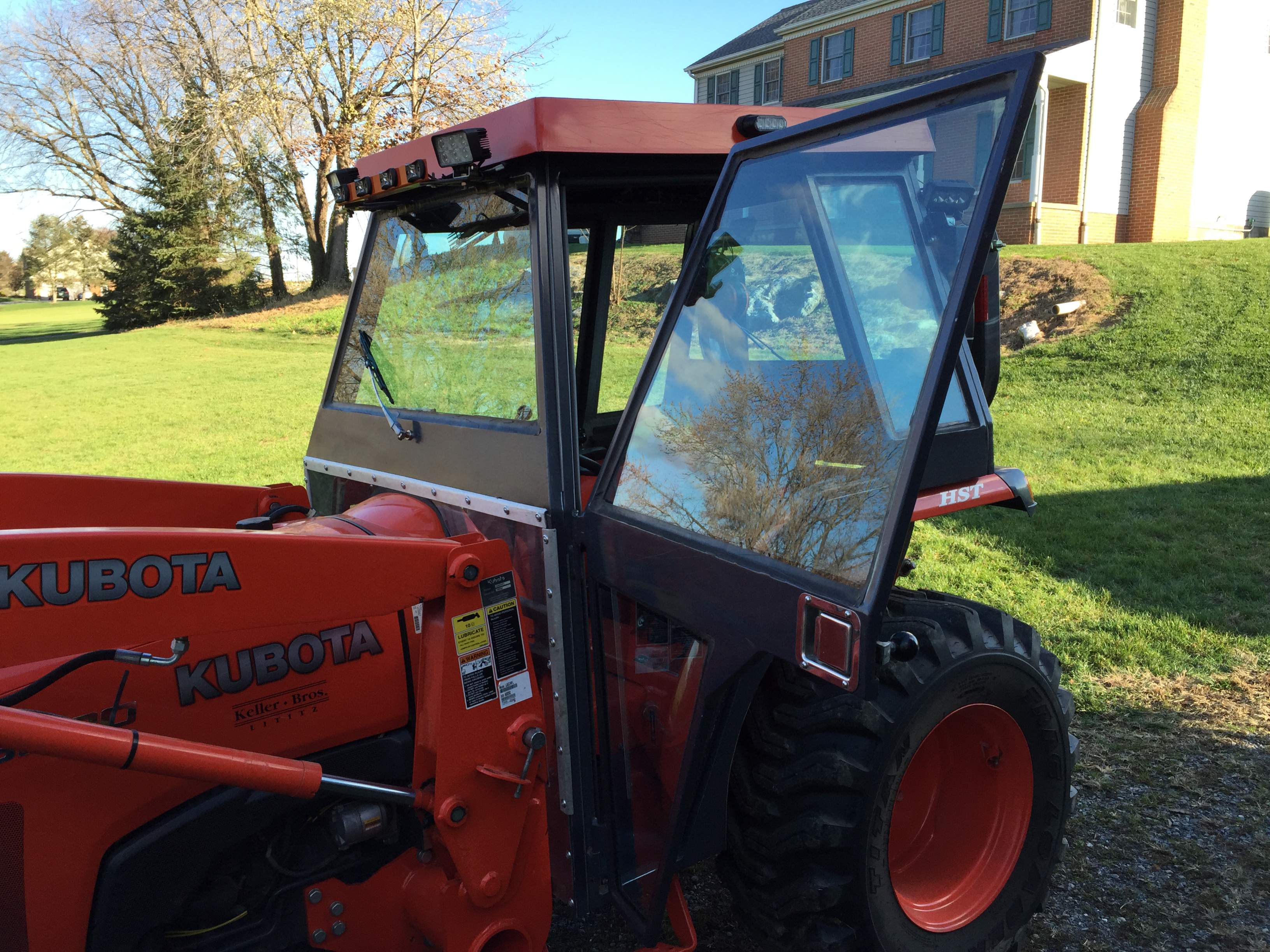

A couple of photos and a link to a real short video of the door latch:

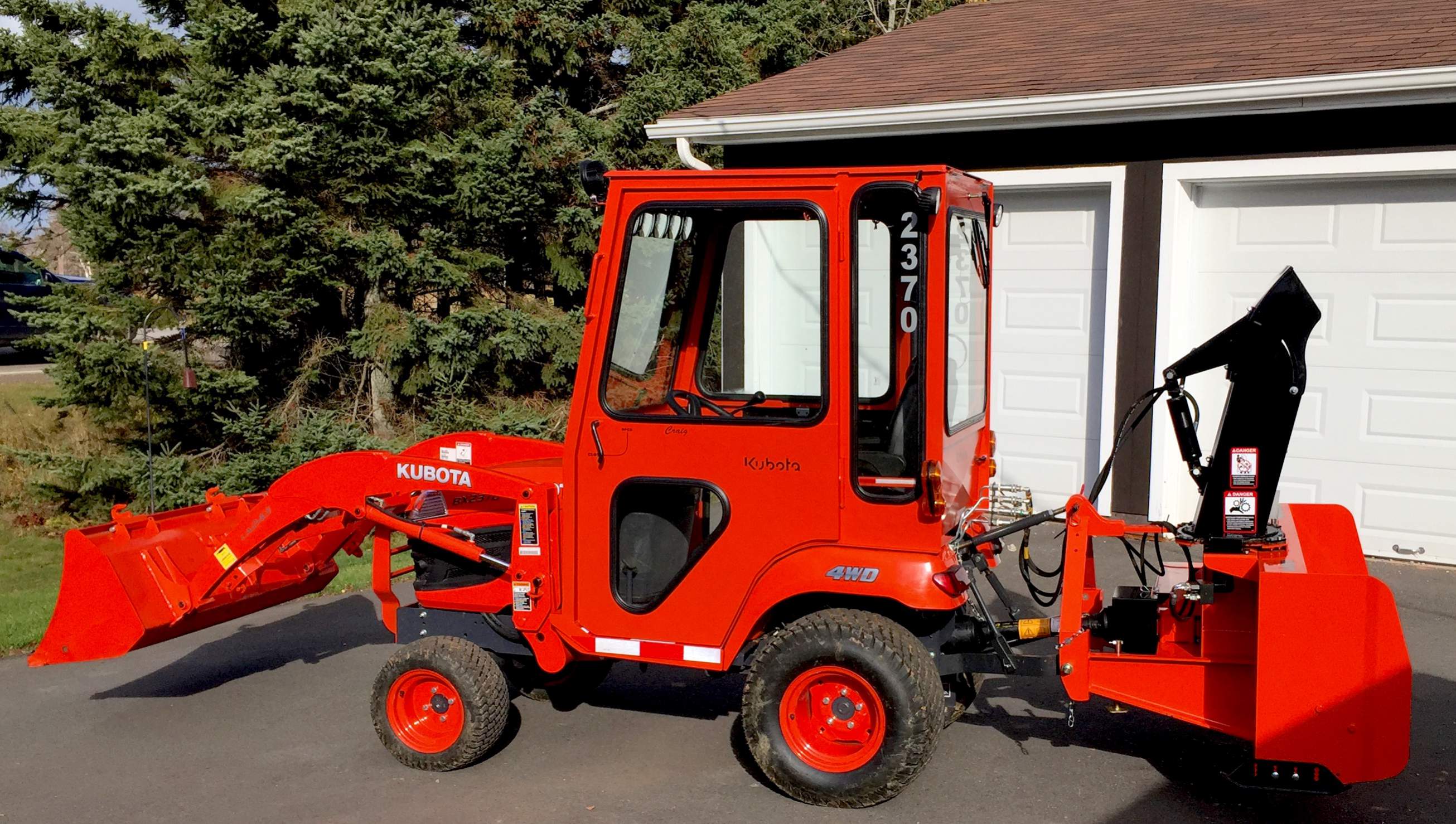

I too considered building a cab but my fab skills are very limited. I found a small welding shop in Northern New Brunswick who makes custom cabs. His prices start at $2,750 CAD. I quickly decided that (for me) that was a far better approach. I have not regretted the decision. Last time I spoke with him he had 19 lined up on his build list. Just spent the morning swapping mower for blower as we get ready for the long dark period here in Eastern Canada.

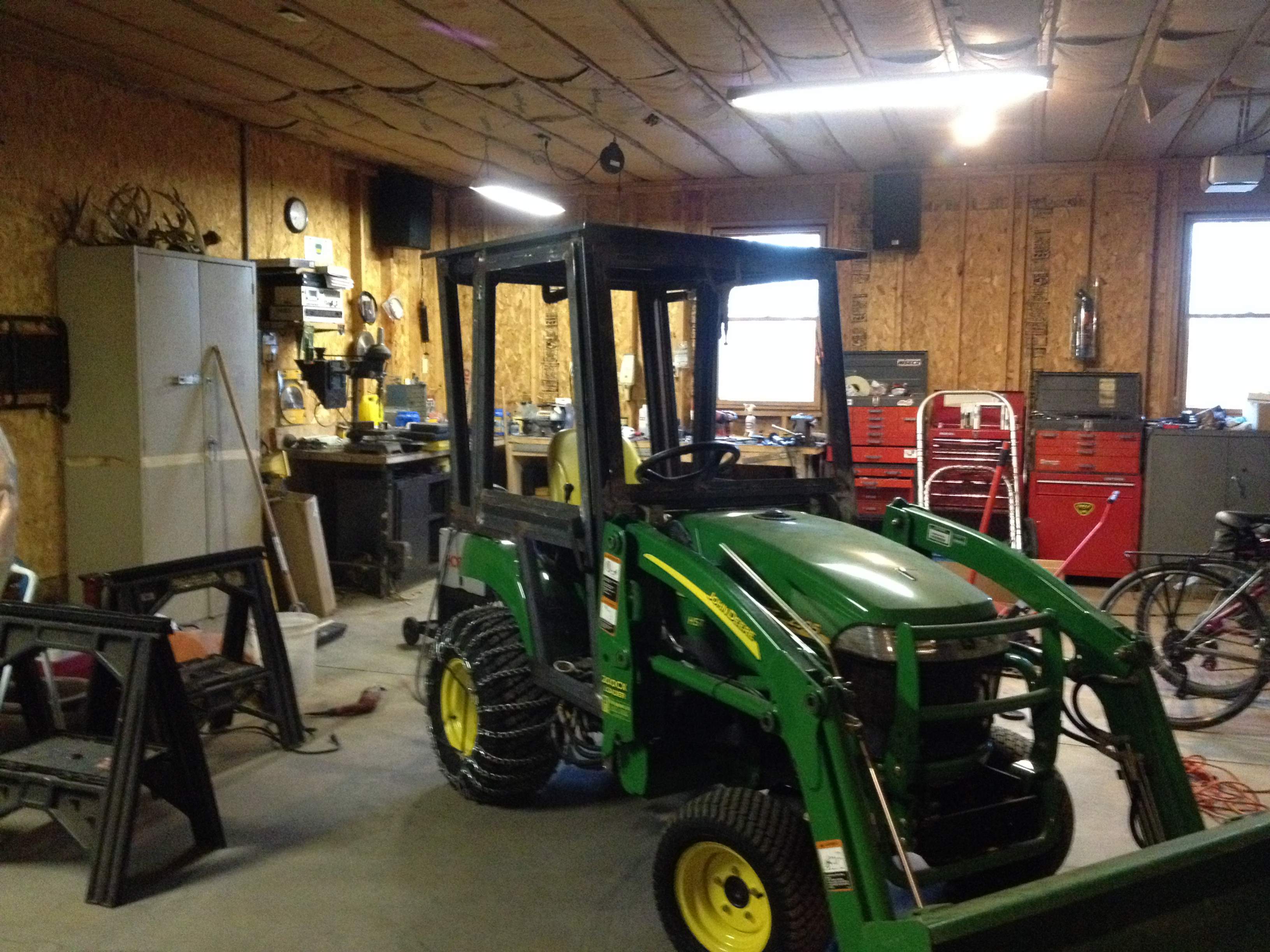

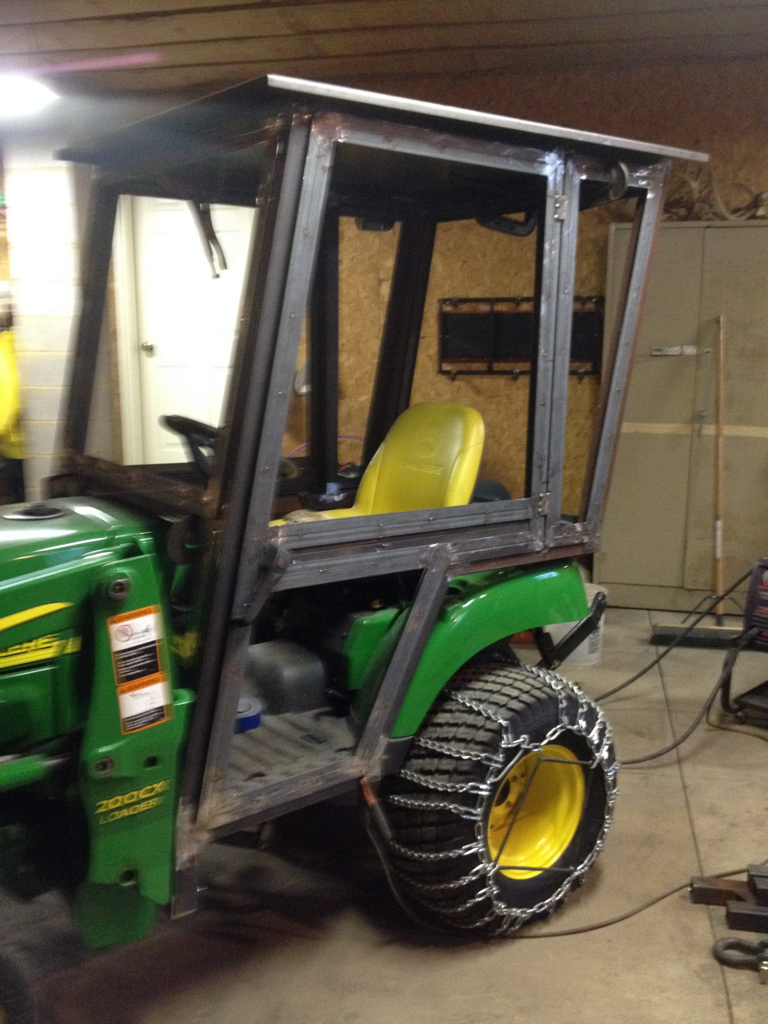

Ok after a week in the garage I have a cab framed up and almost ready for paint. I am getting a glass windshield cut by a local glass shop but think I am going with lexan or plexiglass for the other windows. Where is the best (cheapest) place to buy?

I bought a piece of Lexan at a hardware store for the part of the cab that swallows the hood. It seemed like too much of a job to get glass cut into the odd shapes. I paid around $70 for some 1/8" that was around 16 square feet. I can't remember where the post was but I read one within the last day or two from a guy who bought some very thin Lexan and I think it cost about half that much for a 4x8 sheet.
EDIT TO ADD - Found post:
http://www.tractorbynet.com/forums/build-yourself/348322-i-can-see-clearly-now.html
I like glass because of the scratch resistance. I can take a dry rag, glove or whatever and wipe dust off if it gets too hard to see through. If you have your mind made up to use a plastic material in lieu of glass, the guy at the hardware store told me that Plexiglass doesn't scratch as bad as Lexan, but it shatters easier. After using Lexan to cover a couple forklift roofs I was sold on its durability and decided to risk some scratches. We used our big hydraulic press brake to bend angled rain lips on the Lexan. We drilled it and bolted it to clips for fastening. The darn stuff is almost indestructible

I attached a few pictures. Still trying to decide between powder coat, paint or spray on bed liner for the finish. I am also waiting for glass prices vs lexan.
