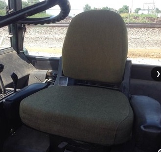

Ok let's say I have it, Do the arm rest fold down to level with seat. Growing up both of the green machines we had the armrest would fold down making a large seat for us kids to ride along and learn the controls for our turn at driving in circles for hours on end.

Well I have never seen an armrest fold down, most fold up which is what mine do. I doubt you could get a buddy seat on that size tractor even if you wanted one, at best they would have to sit in your lap.

Here is a pict of a 1970's JD 4630 off of TractorHouse that shows the armrest folded. This is what I remember riding on and folding down when I was driving to have more room and just for the entertainment value as killing time for hours on end disking under wheat stubble.
/ Cab Regrets? #5
Thanks for the replies Here is a pict of a 1970's JD 4630 off of TractorHouse that shows the armrest folded. This is what I remember riding on and folding down when I was driving to have more room and just for the entertainment value as killing time for hours on end disking under wheat stubble. <img src="http://www.tractorbynet.com/forums/files/ls-tractors/390819-cab-regrets-jd4630-seat-jpg"/>
That is nice I only wish 5030C would do that.
That's what my JD 4440 does. It's not really a buddy seat, but my wife rides along with me sometimes - it's pretty tight and she's a small person. Having a cab with AC sure is nice when you brush hog and run into a bunch of ragweed.

The armrests do not fold down flat (or level) with the seat. I really have not even used mine. Always folded up.
