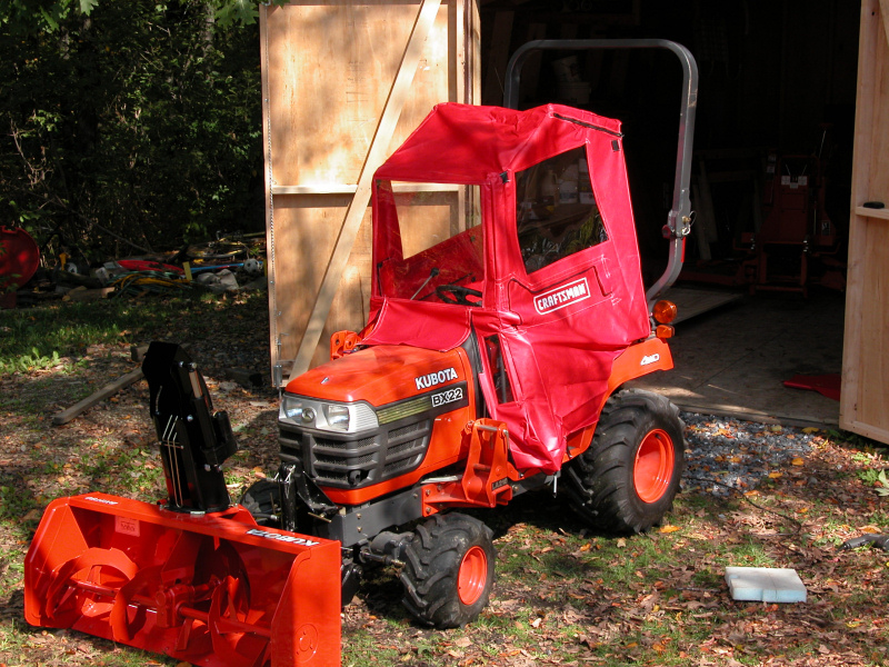

Anyone have a BX2350 with cab or other type enclosure? Have done a searce and not come up with many. Can't afford the high priced ones. Any with soft cabs? Anyone with the Femco weatherbrake? That appears to be the cheapest, but also most open. Anyone with any of these and how do you like it and cost? thanks hjt
/ Cabs or enclosures BX2350 #2
Sears, $100
Paul

I am using the Femco weatherbreak and also the sun shade. I went ahead and added plexiglas to the back of the ROPS which really cut down in the amount of snow coming in when snowblowing.

I have never had a fogging issue. Biggest issue is snow collecting on the front window.
