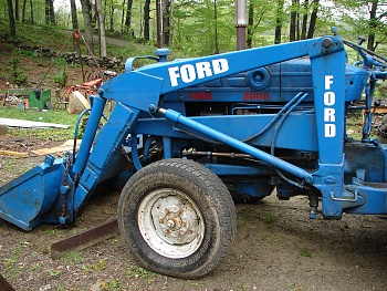

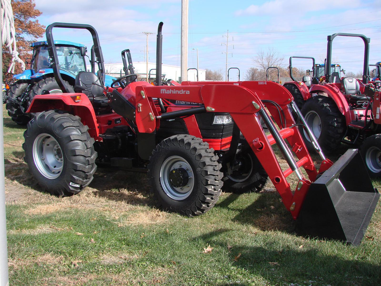

   / Calculating FEL Lift Capacity #45
Power position actually has to do with both lift height and geometry.
the greater the angle between the loader arm and cylinder....the more power it has for lifting that loader arm. Moving to power position increases the angle.
The lower lift height is just a result of this.
Look at the design in general.....of loaders of the past vs modern. In the past, lift cylinders had a VERY generous angle. The cylinder base was mounted several feet below the lift arm pivot, like at the bottom of the lift post. This made for a large angle and more power.....and to compensate for lift height, they had a very long stroke.
IT wasnt uncommon to see 30-36" stroke lift cylinders to get the hight needed, and for the base to be mounted low for power.
Modern loaders take a different approach. They use a much shorter cylinder, and a much smaller angle between the loader arm and cylinder. But make up for it with cylinder diameter.
Here is a few pictures from google that illustrate what I just said

Great illustration!
With the older design, you will generally have a much greater difference between lift capacity at low height vs full height because the angle of the cylinder to the loader arm changes more as you lift.
With the newer design, you have much closer breakout to full lift ratings.
For example, my Kioti LB1914, while not as extreme as your picture had wider angle between lift arm and cylinder than my current DS4510. The LB1914 has 2x the breakout compared to it's full height lift. The DS4510 has 1.34x more breakout compared to full height lift capacity. In a way, the older design favors breakout force while the newer design favors a more even lift cycle (and accommodates those nice big front tires! :thumbsup:)
