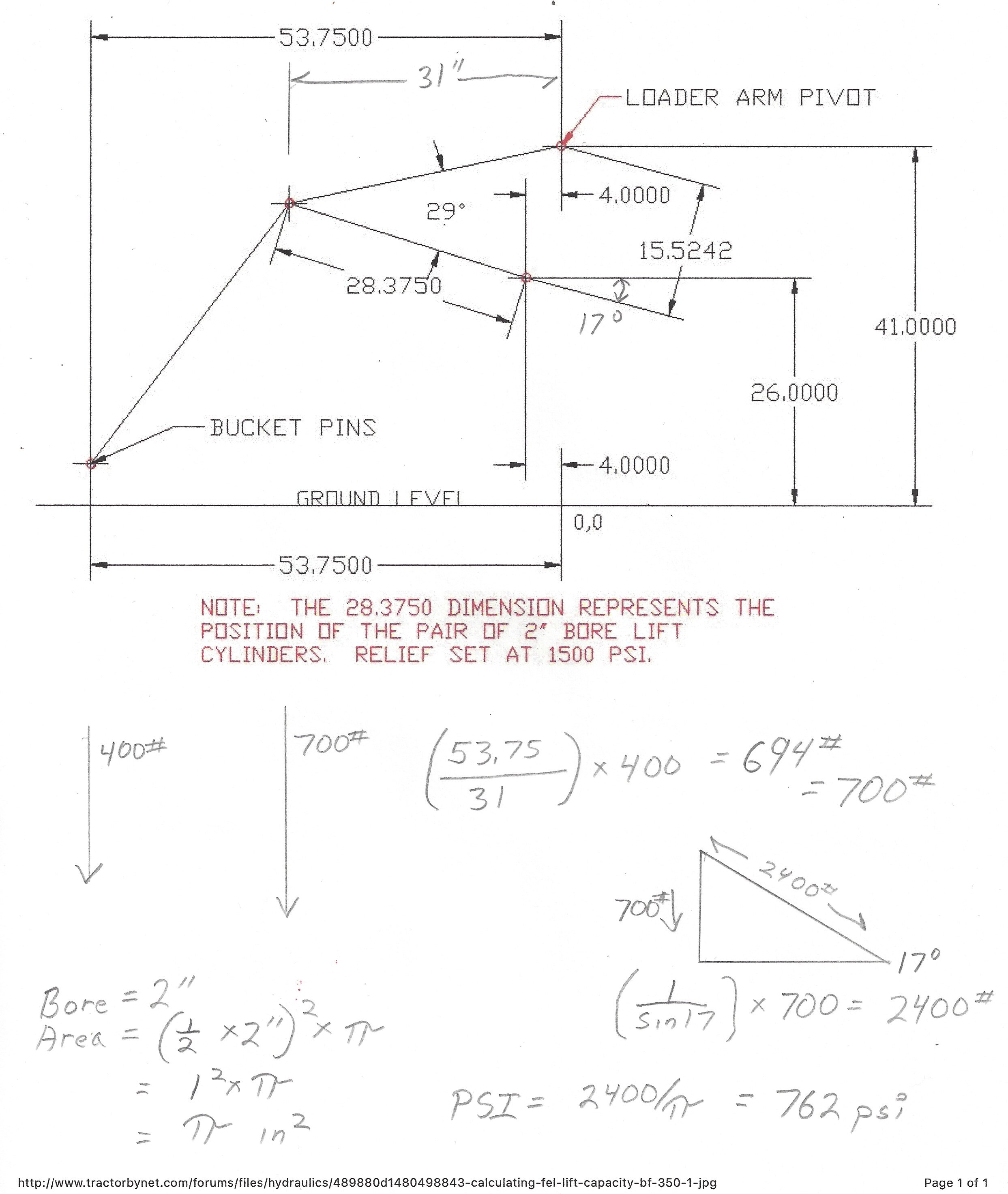

As mentioned in my post #1 above, I was trying to figure out the factory relief valve setting on the loader. After doing all the drawing and using 1500 psi as a starting point, I found the relief setting of 1638 psi (IIRC) for the loader in the B9200 tractor manual.:)

I'm just a stupid geologist, so I may have made fundamental assumptions in my math using triangles, resultants and the like. I scaled off the drawing, rounded some numbers because this isn't a classroom test and figured the mechanical FEL assembly had no weight.
If I'm wrong, I accept that

While we are on this subject. I am in the process of building a front end loader for a Deutz Allis 1920. I have the mounts done and the arms are more or less built (need to clean up the welds and weld cross bar in). I am planning on using 1.5" bore with 1" rod cylinders from SS, they have some specific for loader arms. I don't need to lift a ton but I would like to lift a minimum of 500 lbs. The lift cylinders will be around 25-30 deg. I guess my question is should I use the 1.5" cylinders or bump up to 2" cylinders? The calculation I posted yesterday above here has the 1.5 cyl at about 1700 lbs each and a 2" cylinder at about 2200 lbs each. I know there is more to the math and geometry than I am posting so if you need any more info just shout. I'm suing a pressure of 1500 psi.
Thanks in advance.
edit: Ok so going off of rock knocker's drawing is it safe for me to assume I can use the same formula? Overall distance from pivot to pin over distance of pivot to cyl mount?
I'll get some measurements and report back.

Not sure I follow what Rock Knocker is doing. I might just be dense but I think I need a more step by step description to follow. I'm not even sure what he's trying to solve for?
[Edited for 1500 psi] You want to lift 500 pounds.
To what height do you want to lift it and what is the distance from loader pivot to the cylinder center line at the point where a perpendicular line drawn from the cylinder center line would intersect the loader pivot? Call this Dma
At the height you want to lift, what is the horizontal distance from the loader arm pivot to the center of the load? Call this Dl
What is the weight of your loader arms + attachment when lifted from the center of the load that you want to lift in question above? Call his W
Then you have...
lift = (Cylinder force x Dma / Dl) - W
For 1.5 inch cylinders at 1500 psi cylinder force = 5299 pounds
lift = (5299 pounds x Dma / DI) - W
For the purpose of the example, assume Dma is 12 inches, Di is 60 inches, and the weigh of the bucket + loader arms when lifted from the bucket pin is 500 pounds.
Then you have....
lift = (5299 pounds x 12/60) - 500
lift = 560 pounds at center of the load (note - this is just an example, need Dma, Di & W from you)
These calculations do not include friction so you'll have to account for some margin. You'll have to plug in your own numbers at the loader position that is important to you and decide what size cylinders to go with. Or just send Dma, Di, and W to me and I'll plug it into the Excel sheet that I just set up while writing this response.
On the flip side, if you just get the 2" cylinders, unless you have some very unusual loader geometry, they will lift 500 pounds in any reasonable scenario. Once you factor in the weight of the loader / attachment, they'll lift more than twice what the 1.5" cylinders will lift.
